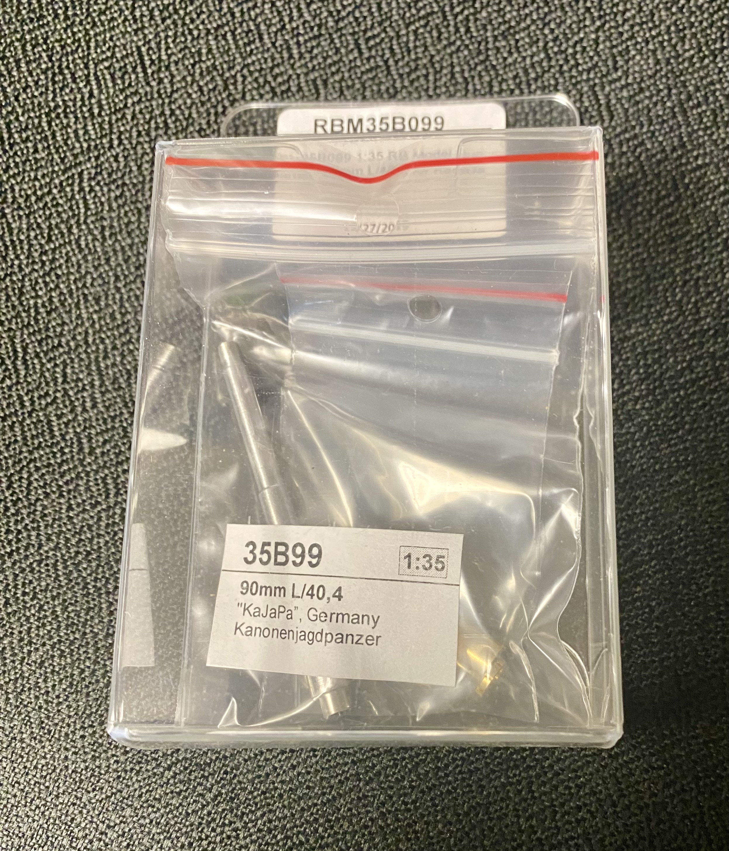

There’s also a metal barrel that would probably fit but I can’t remember where I hid it.
Found it
Yeah, I was aware of these tracks but was in far too much of a screaming hurry (like 3 or so days’ wait would have hurt!)
There is indeed a metal barrel available for the Jagdpanzer, but according to Amusing Hobby, it looks like the contours/length are different - they provide 2 x distinct barrels - so I deferred to them and used what they provided. I’m assuming that at some point they had access to the real thing at Munsterlager or Koblenz or wherever the real thing actually is.

After looking at your build the Kanonenjagdpanzer metal barrel I have is far too short.
