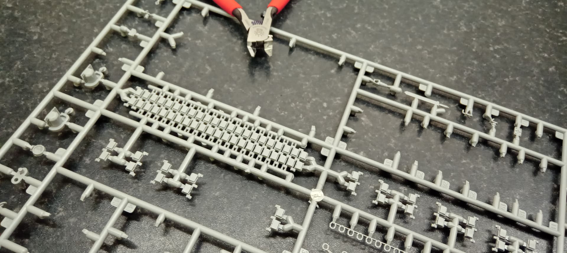

Well Al, be careful with the track; well detailed, several separate parts, but here’s what defeated me (though I concede I did want to get a move on):
Note how the track segment is secured to the main sprue by lots of thick and difficult to get at others. These are the same tracks you’ll get in the Amusing Hobby Jagdpanzer Kanone too. Now, my sprue cutters are of a fairly decent type but I could not get access to snip them off cleanly enough. I suppose an extra sharp scalpel blade might have done the trick but my frustrations clearly got the better of me.
This is not a huge engineering problem and more adroit modellers than I will find a fix, but as I say, I found it very frustrating, especially as I ballsed one up when I eventually did manage to remove it; I trashed most of the end connectors.
Anyway, as I say, those more adept will not suffer, but I thought I’d mention it. I think when I do tackle my Jagdpanzer Kanone (and remember I have the Revell one waiting) I’ll purchase the AFV Club separate links.
I think a razor saw is best for something like that.
Ken
Well, it’ll need to be a very fine one!
My AH Jagdpanzer has not arrived yet, so thanks for the heads up. Forewarned is forearmed as they say!
I have the Das Werks version of the KaJaPa / Beobachtungspanzer (JagdPanzer), I’ll check the tracks when I find it!

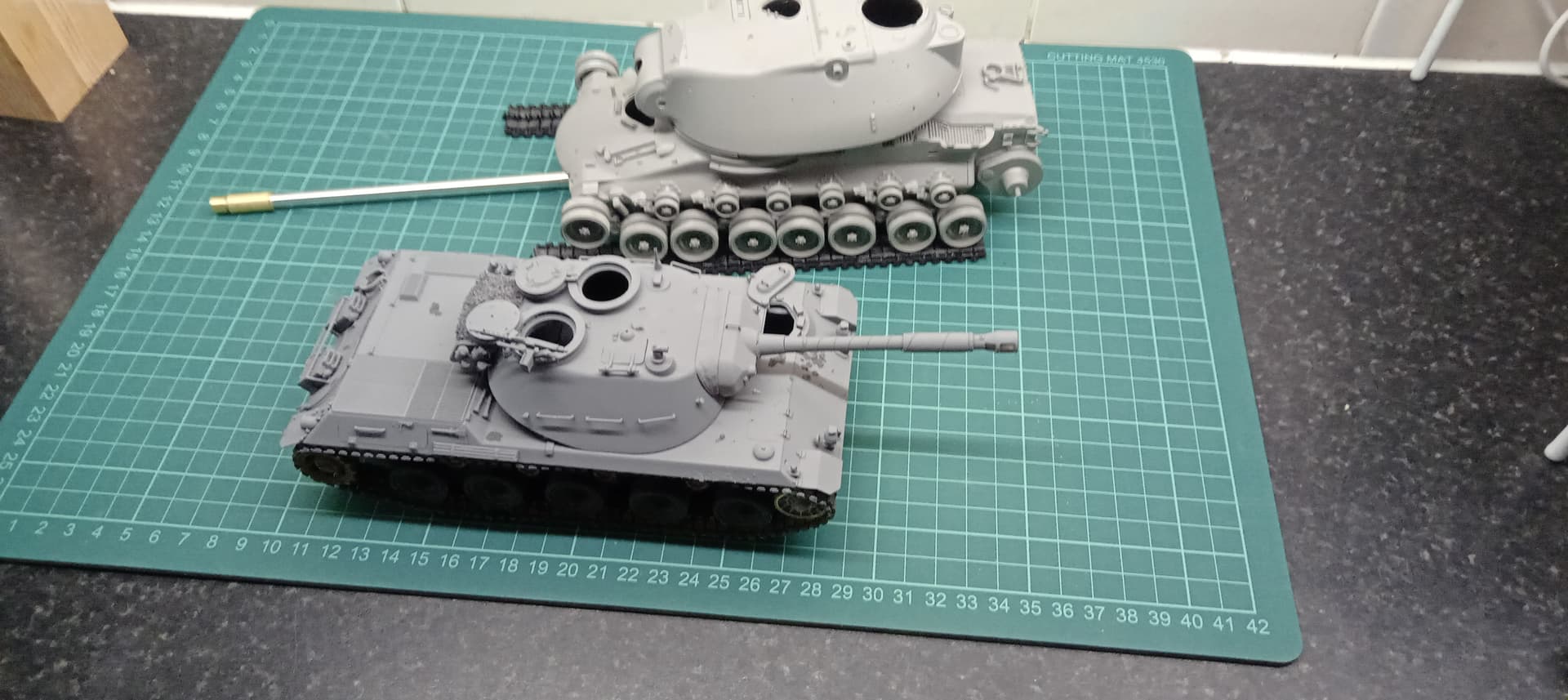

A quick update – this time on the second vehicle I plan to display with the RU 251 – the mighty M103A2, which I shall call an M103A2G as I plan to model this as a “What-If?” in Bundeswehr service:
This is the Takom kit, the only game in town for the A2 version, which I will Germanize with smoke dischargers and a searchlight box, or at least that’s the plan. A complex kit, especially the suspension which has taken some time; infuriatingly, I lost two road wheels, or rather parts of them, and just could not locate them; the perils of being a dining-table-top modeller I suppose. I ended up robbing the Takom A1 version (loitering in the stash) but will have obviously to think of a replacement some time; I’ve assumed – not yet checked – that the M48 wheels are one and the same? That means a resin replacement set may, may be the solution when I tackle the A1.

The M103 is building to be quite a monster and the finished kit may look a bit congested on the same base as the RU 251, but with a bit of careful figure-placing, some feng shui and a good back story I might bring it off(!)

Great to see you making a start on the M103 Brian. I’ll keep a close eye if you don’t mind, to give me a heads up for my build (not sometime soon). I’m only just back at the bench this weekend after an extended break due to much building work in the house. I need to finish off my two M41’s and the little M24, all three at the weathering stage, then they’ll be followed by a Meng AMX-30 waiting for primer, plus a Tamiya Japanese Type 74 under construction. Oh, and then there is the early M60 and M60A1 still being constructed. The early version (rounded turret) is destined to become IDF, but the A1 could well end up as a MASSTER scheme. We’ll see. Those are all 1/35, but I also have some 1/72 AFV’s to complete. Only then will I look at the M103!

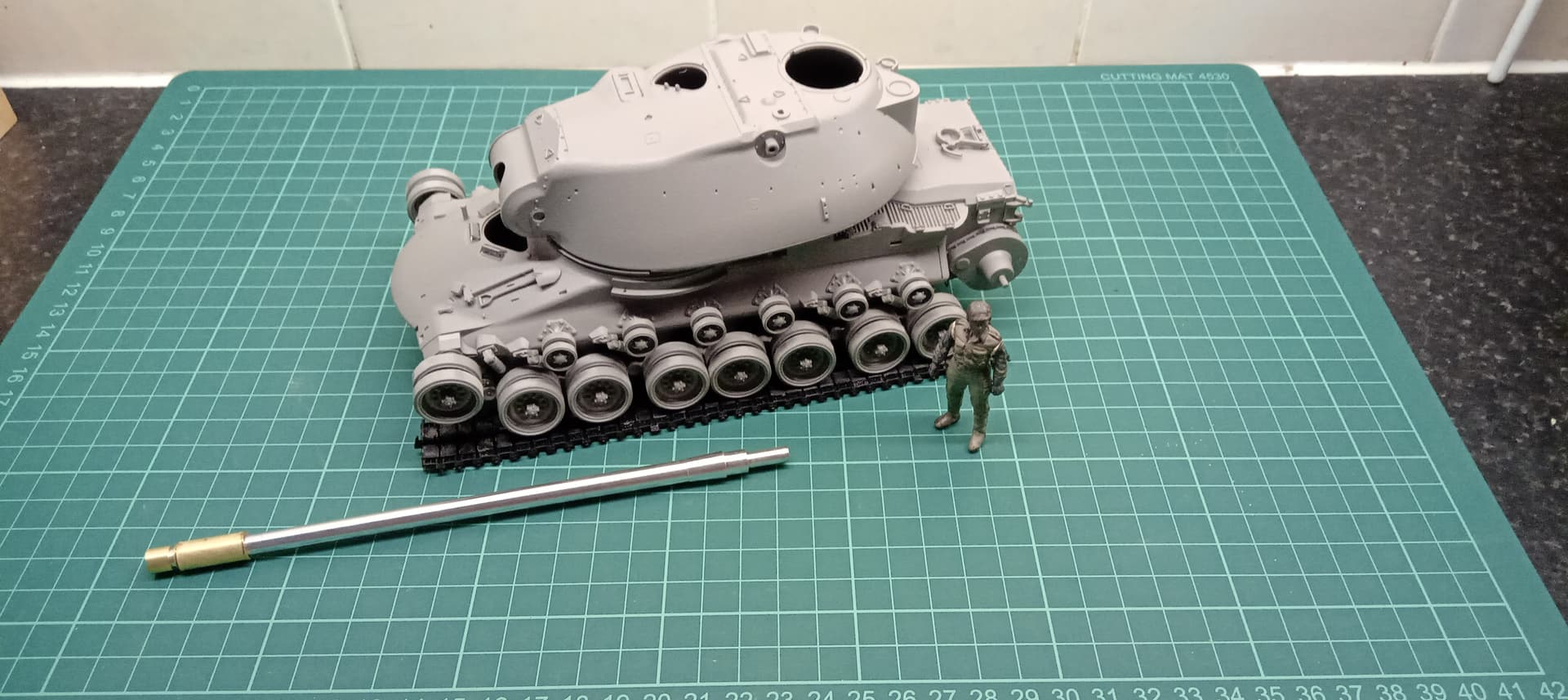

Verdict on the Takom M103A2 so far: I think the suspension is a bit over complicated; certainly the instructions needed close study, but the fit and engineering is superb. It also makes sense to skip the fitting of lots of small parts to later on, and get the main build out of the way, particularly as the suspension is sort of a working one, so lots of fiddly handling which can take its toll on any small details fitted in accordance with the kit instructions’ sequence.
I’m going to take a bit of a break from the suspension and tracks (rather sucked the life out of me the last 2-3 days) and have a dabble with the turret. The overall kit is a bit of a scale monster, and will, in a way I suspect, dominate the display tables a bit. Hopefully, I’ll have it done in time for Yeovil - Sun 7 Apr; we’ll see!
