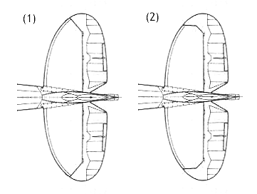

Well, it depends. A late Mk.IX would have an extra crank in the elevators; a larger, pointed rudder; and different fairings over the guns in the wing. That said, and I may be wrong here, but I think the Eduard IXc late has parts for earlier versions as well (except for the large wing bulges.) It all depends on which aircraft you want to do.

Hey Joe, here’s what I’m talking about:
The Mark IX had both styles at one time or another, style 1 early and style 2 late. And I believe the kit you have is a IXc, the IXe had a different gun set up in the wing.

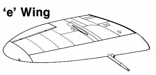

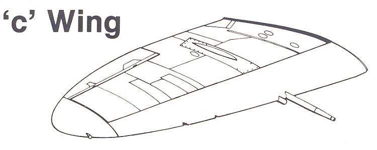

I’m not sure about that particular kit, but the C wing had 4 .303 Browning’s in the outboard gun ports and 20mm cannon inboard. There was provision to mount 4 cannon but it was rare. Sometimes it could be seen on VC’s operating in the Med, but I’ve not seen a IXC with that setup. Would be interesting to see if anyone has come across some photos.
The E wing dispensed with the .303’s altogether and mounted a Browing .50 next to each cannon.
And just to confuse matters, there’s also the Mk.XVIE. Essentially a IXE with a Packard Merlin. Later versions of the XVI had a cut down rear fuselage and bubble canopy. I think all had clipped wings too.

Hi stephen. so the drawing of the C wing you show has two out board ports you say are the .303 guns, two on each side for a total of four, and the long barrel inboard is a cannon. What is the shorter barrel next to the cannon? i need to pull my kit out and compare it. the kit i have is a weekend version so there is limited info on parts.

I see the difference in elevator shape, thanks michael.
The shorter bit next to the cannon barrel is a cover/fairing. The wing was configured so that It was possible to install another 20mm there, but they almost never did.

That’s the covered over port for the extra cannon as Michael says. Never seen a quad fit on a IX, but have heard about some VIII’s in the Far East carrying them for strafing ground targets.
