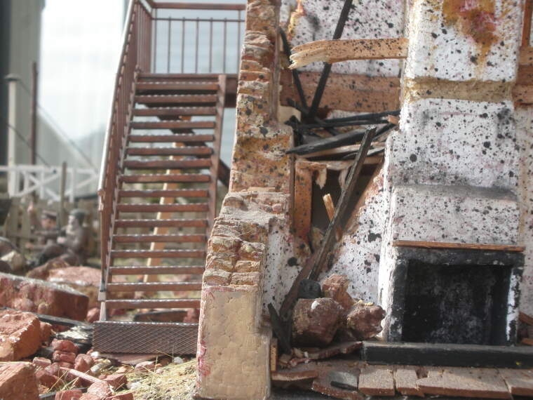

Hi, stairs on the inside will be fine, please just make sure that the viewers understand the function of them. (Even if it’s broken on the ground)
I think you will end up with something great:)
I have not yet finished any stairs myself, I have used the Miniart stairs in a mockup. Maybe this could give you some inspiration:)
But in my mockup the stairs have an dominant role, in your build they will just be a cool detail.
Anyway, have fun building, I like it and it inspires me :slightly_smiling_face: /Erik

I have built the miniart stairs. Unfortunately one side of the railing got damaged during the shipping so it barely stays together when glued. I am thinking about removing the one side of the railing. There was an idea that the stairs could be used in the exterior of the factory. I tried both. Whats your opinion?
I had some spare steel construction so I tried to use it as the load bearing steel beam. Later I will try to connect the roof construction to it. What do you think about it? I think that more construction like this adds to the feeling of industriness. I also did the window arch. I don’t feel confident about how it is looking. What do you think?
I had the same experience with the step railings, I seem to remember the right side was unusable. But the left side wasn’t much better, you can see it had fallen off all by itself sometime between taking the first and second photos I posted here in Feb 2021. At that time (2016) I didn’t even notice until I uploaded them but decided it looked OK on the ground.
According to the box art the steps are supposed to be external, but in a factory setting just as plausible inside. I guess it depends what you can (or want) to show of where the steps are leading e.g. to an upper walkway or a whole upper floor? In other words avoid putting in a stairway to nowhere. Another consideration is placement of figures – what you want them to be doing will probably dictate where the steps should go.
