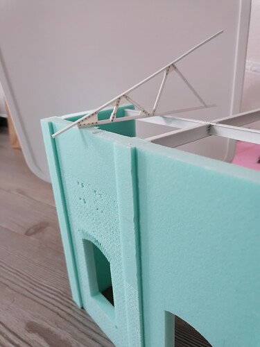

I want to make roof like this:
I just wanted the i beam to be the load bearing beam that the roof construction will be layed on.

I would be TOTALLY happy if I managed to make such a good looking roof support.

I am experimenting with the main load bearing I beam:
Again, any opinions or suggestions are very welcome!
This is how it looks like when added to the factory:
What do you think that I should add here?
I think either continue the brick wall or build some steel ‘wall’ in there - but how?
