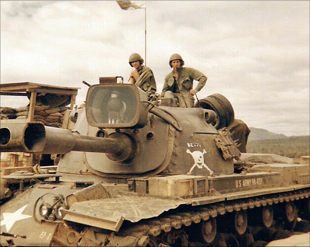

Came across this pic on a different forum this morning. Just didn’t look right and I had never seen it before. Went through all my references trying to find it and no luck. Went back and looked again to see if I could find it without the twin 50’s to see if it was altered from another pic. Again no luck.
Did a google image search and tineye reverse image search and came up with it in WarThunder forums (of course) and on Reddit but not really anywhere else. Did find it colorized and labeled as an M48A1 in Vietnam (obviously not correct) on some page (Pinterest I think).
I know I have seen pics of nam M48 with umbrella and tarp covers for shade, but those were not this pic.
Still not sure this isn’t an AI or edited pic. It’s so unusual that it should have appeared somewhere else before now.
And thus is the problem with the internet….someone posts this pic, captions it “M48A1 in Vietnam”. Then it gets reposted and reposted and becomes canon, especially for those who don’t know any better.
Anyway, that’s where I am at.
Thoughts?

Here’s the original caption for Michael J. Roche’s photo :
SUN RELIEF- Blackhorse Troopers check map coordinates from the deck of their M48A1 Patton Tank just a few kilometers east of the Cambodian border in March, 1971 . This photo was published in 2007 with the permission of the photographer in a United Kingdom informational text about umbrellas. © 1970, MJ Roche.”

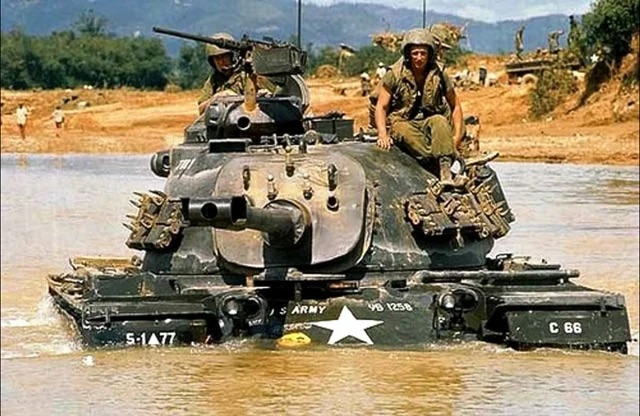

Quiz time! Can you tell which of the above is which?
  1. Clearly an A3 because it has air cleaners between the long stowage bin next to the turret and the short bin beside the engine deck. (You can also tell it’s a “Mod. B” by the “ledge” above the rear grilles and the square taillight guards.)
  2. An A2, as it has three return rollers, and also a front and a rear stowage bin but there’s no big box between them.
  3. This is an A3: again, it has air cleaners, and it’s a Mod. A because it has the early type of headlights and guards.
  4. A well-known photo that people often assume to be an A3 Mod. B (see the headlights), but it’s an A2: you can see it has braces on the sloping part of the front mudguard, and combined with the headlights and the lack of vision blocks under the machine-gun turret, that means an A2. You can also just see it doesn’t have air cleaners, which would stick up above the stowage bin.
  5. An A3 Mod. B: the air cleaners are clearly visible, as are the A2 type headlights, plus the machine-gun turret sits high up enough that there must be a vision riser ring under it.
Photo nr:
  1. Aircleaner, can’t see any return rollers, rear mudguard angled, front is missing → A3
  2. No aircleaner, three rollers, angled mudguards front & rear → A2
  3. I see 4 return rollers (i.e. more than three so 1 is not in the photo), aircleaner, front mudguard braces on the sloping part → A3 mod A
  4. Headlights in a cluster, flattened brushguards, mudguard brace on the slope, no vision blocks under the machine gun turret, no chunky air cleaner → A2
  5. The photo from the first post in this topic, already sorted as an A3. The air cleaner box needs a trained eye to identify, no mudguards at all. 5 return rollers so A1 or A3, commanders hatch/turret is hidden/removed/replaced by the dual MG contraption. The headlights are in a cluster with a flattened brushguard → A3. With some good intentions I might willing to admit to seeing a mudguard brace up on the horizontal part which is an A3 feature.
