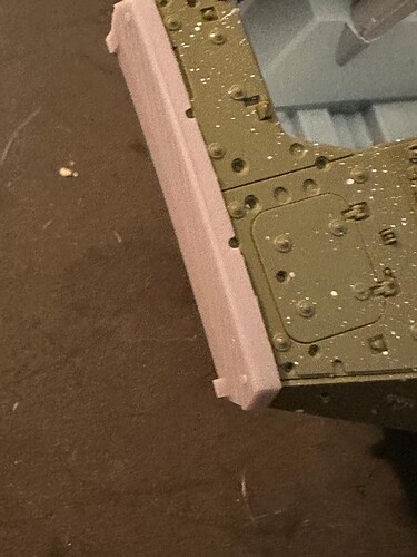

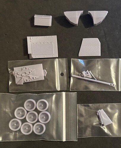

I’ve received the DVH-A1 Hull conversion parts from Ettore Galasso. They’re exquisitely done, and should be pretty doggone accurate. They’re for the AFV Clib hulls, which are more accurate, but a few of the pieces (fuel tanks and a few other bits) will work on the Trumpeter kits. Now I just have to purchase another AFV Club kit and put eveyrthing together. These, along with parts the Magic Factory M-SHORAD Bradley kit (and my references) ought to build up nicely.
I decided to show as much as I can of Ettore’s efforts. I’ve already butchered this AFV Club Stryker, and cemented parts onto it that would be in the way, but here’s a glimpse:
Engine access hatch. Bar in mind it’s just floating there as there’s nothing much holding it underneath:
New front nose piece. Perfect fit, but just being held on by gravity:
Frontal armor underneath. I had already cemented the kit armor in place, but it’s a perfect fit:
And finally, the modified fuel tanks. Again, kit parts already in place. They’re exactly the same width, so they will fit perfectly.
Ettore also includes some other pieces such as the hinge, and the altered side armor panels forward of the front wheels.
