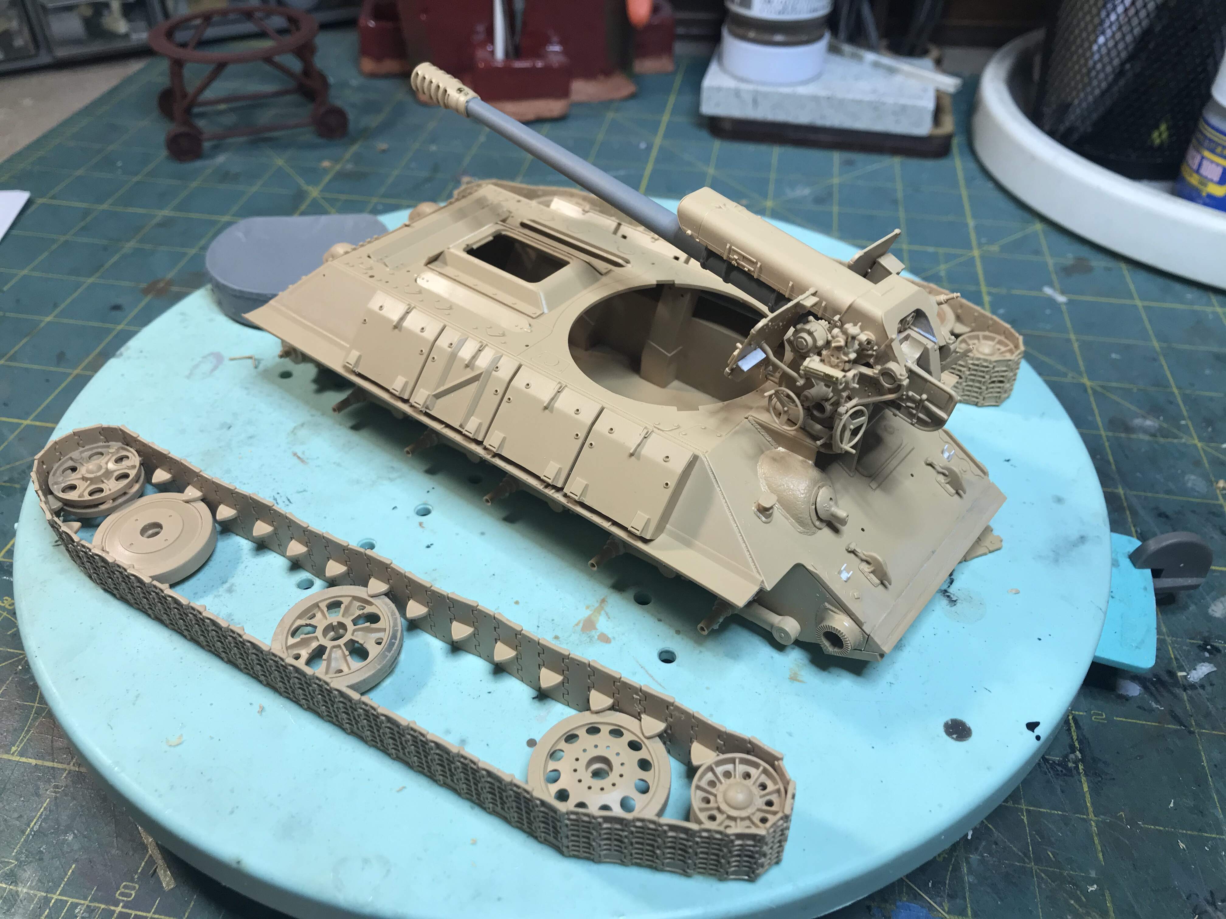

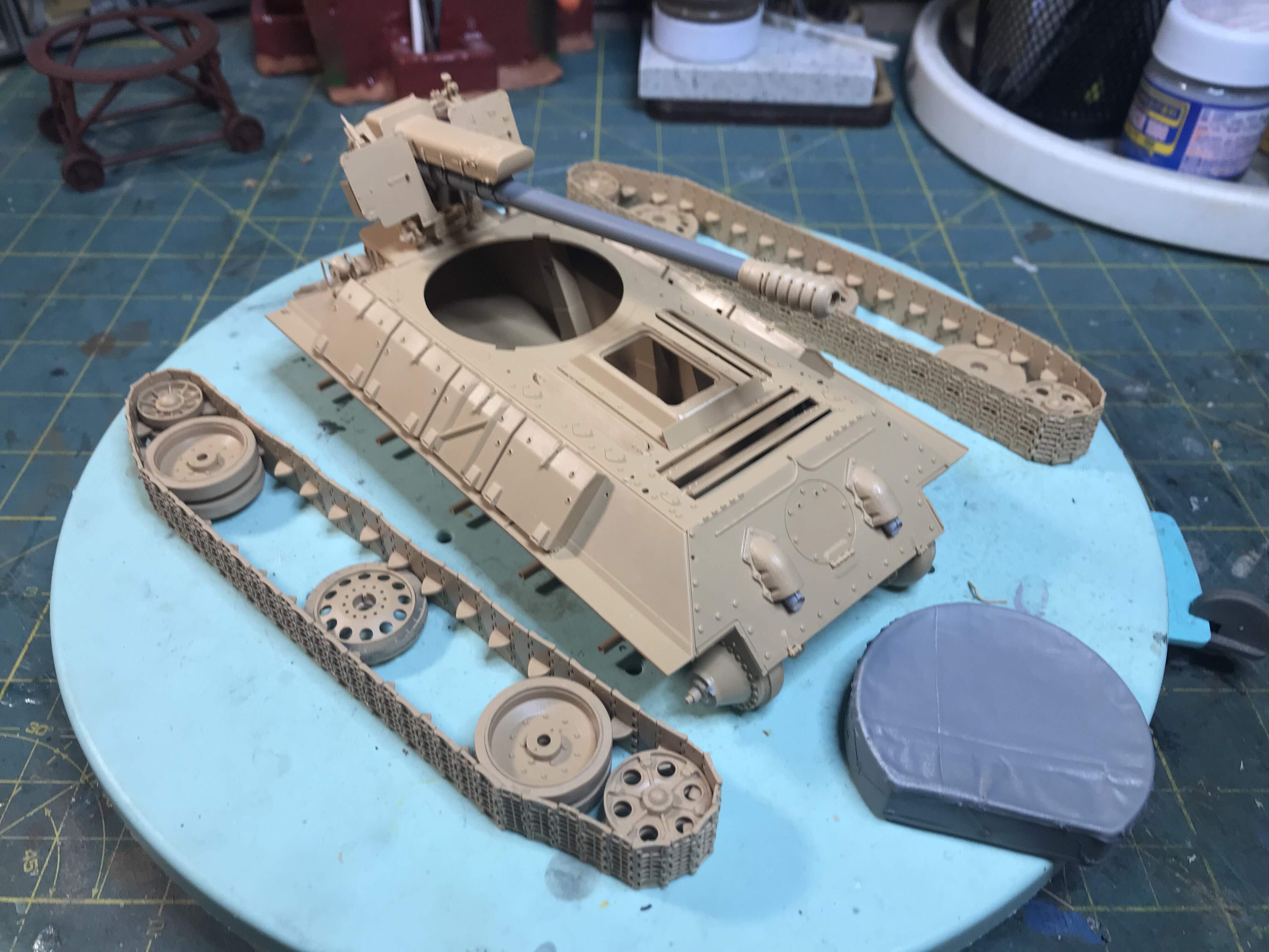

T34/D30 build finished… will be a few weeks until painting happens but good to get this far
This is where I’m at. Lights didn’t turn out well for me.

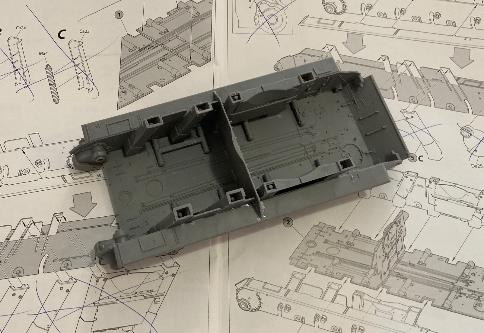

Having seen so many nice models and great builds, I got my mojo and would lik to enter with my Miniart T-34/85 kit which is built in the memory of my father who drove such tanks in the Hungarian People’s Army during his time spent in the Military college. My mother brought me his driving licens (will scan and upload later) and when I got it, I had an idea to build a T-34 tank and place it on a photocopy of that license as a base. Well, this campaign is a great opportunity to start this project.
A little bit of progress on Day One, with some challenge on the hull sides - I was pretty difficult to make the parallel but finally they are OK. I am participating in the regular Miniart campaign (with a T-55 kit) so I do not expect a light-year fast build but definitely want to finish before the campaign finish date. Progress photos will be uploaded regularly.

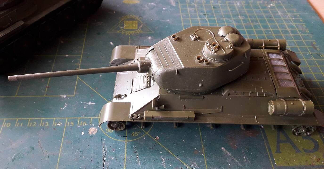

I don’t like my Zvezda T34/85 kit… There, I said it.
I just do not get the ā€œfeelā€ for it, don’t get into ā€œthe zoneā€ with it.
Don’t get me wrong, it is a nice kit. And the fit is generally good. I just… no. I struggle to get it done, don’t pay it the attention that is needed, which only makes things worse. I really messed up with the fuel tanks, which meant I had to chop up fully cured subassemblies. Which doesn’t make for pretty finishes, broken off pegs and slightly deformed tanks due to the force exerted.
Zvezda also has these ridiculously small parts. Without adding spares. So when of them zings through the air after leavig the tweezers at considerable speed… gone. Like the lifting hooks on the turret. Found one again, but another is lost.
And then there are the tracks. I used the kittracks on my old (also Zvezda) T-34/76 and they just did not fit. Had to cheat by adding one extra trackpad and cut off its joints.
For this kit I am using spare Dragon single link tracks and these just fit, even though they are bigger then the original kit version!

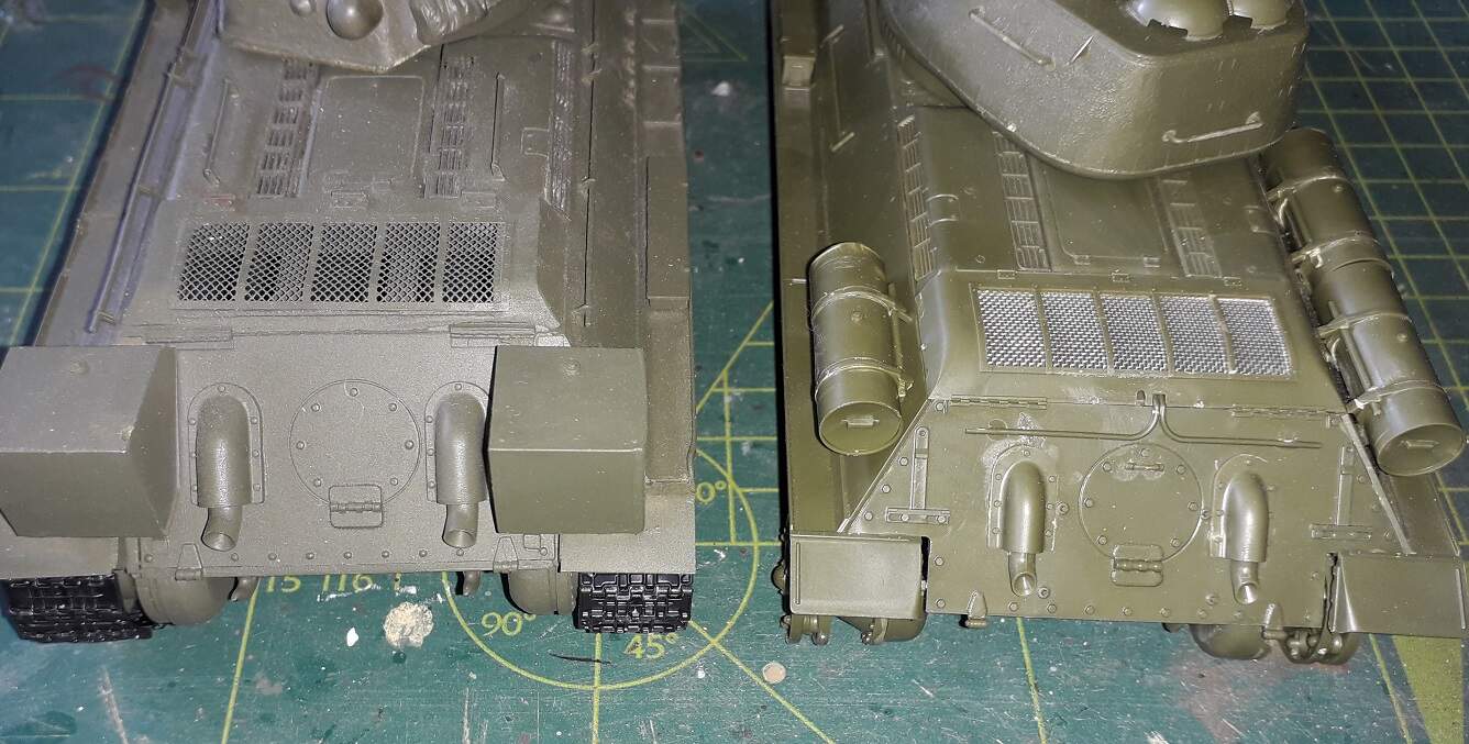

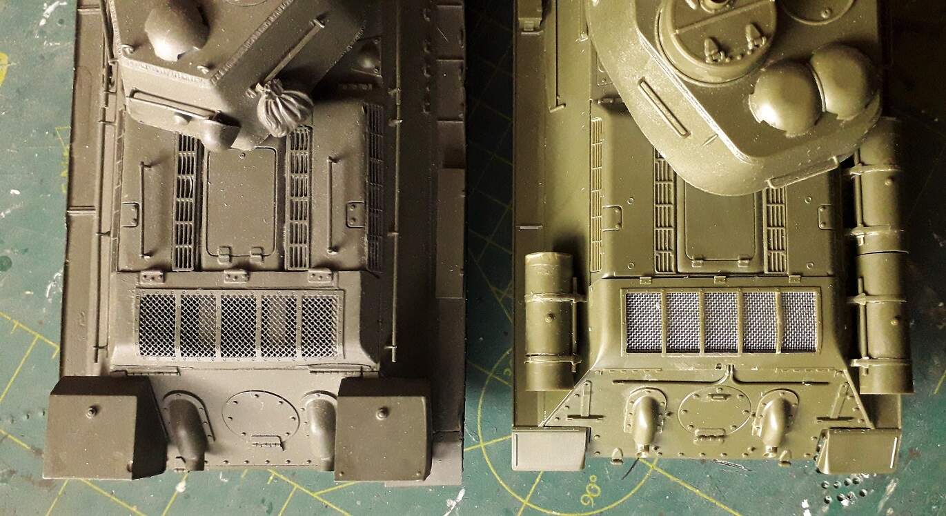

Dimnesion comparisson between the old T34/76 and the new T34/85. I have the suspiscion that the old one is too big.
hmmm… that T-34/76 is lookin’ a little big…

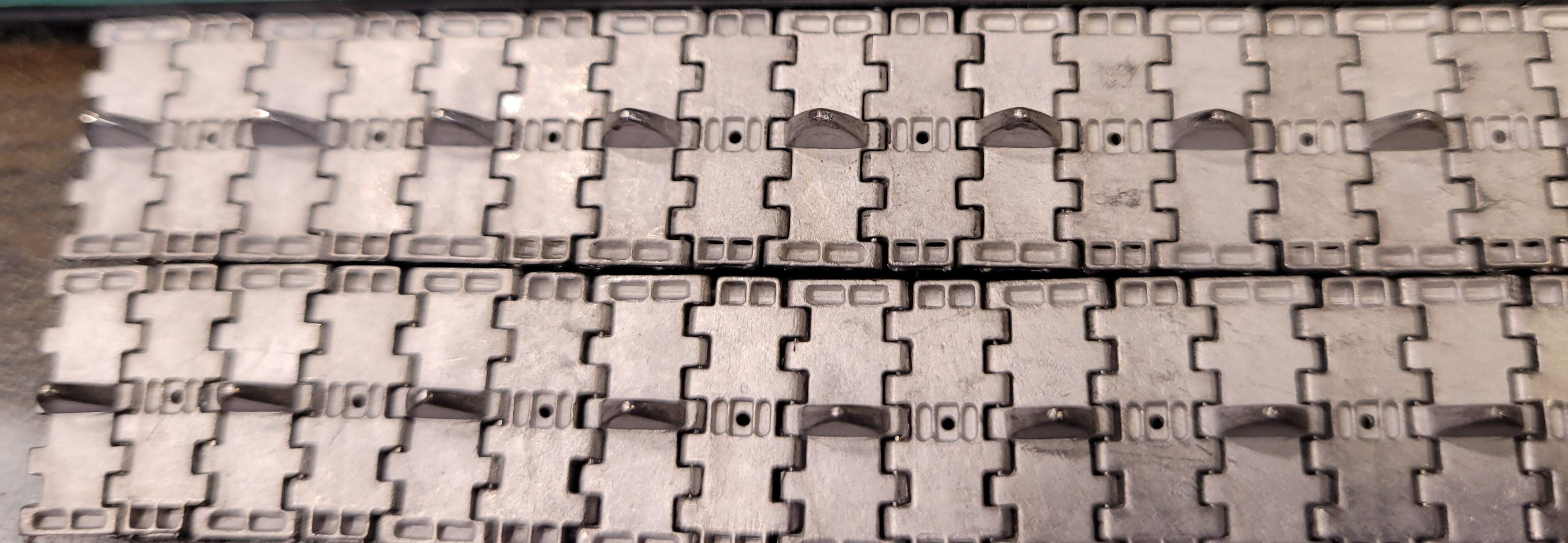

Notice due to wire flex & deburring the track pin holes two pairs of tracks may not line up link to link perfectly. Here’s an example.
Notice how they quickly start of off set? That’s why I mention it could vary a little on link count in some cases.
