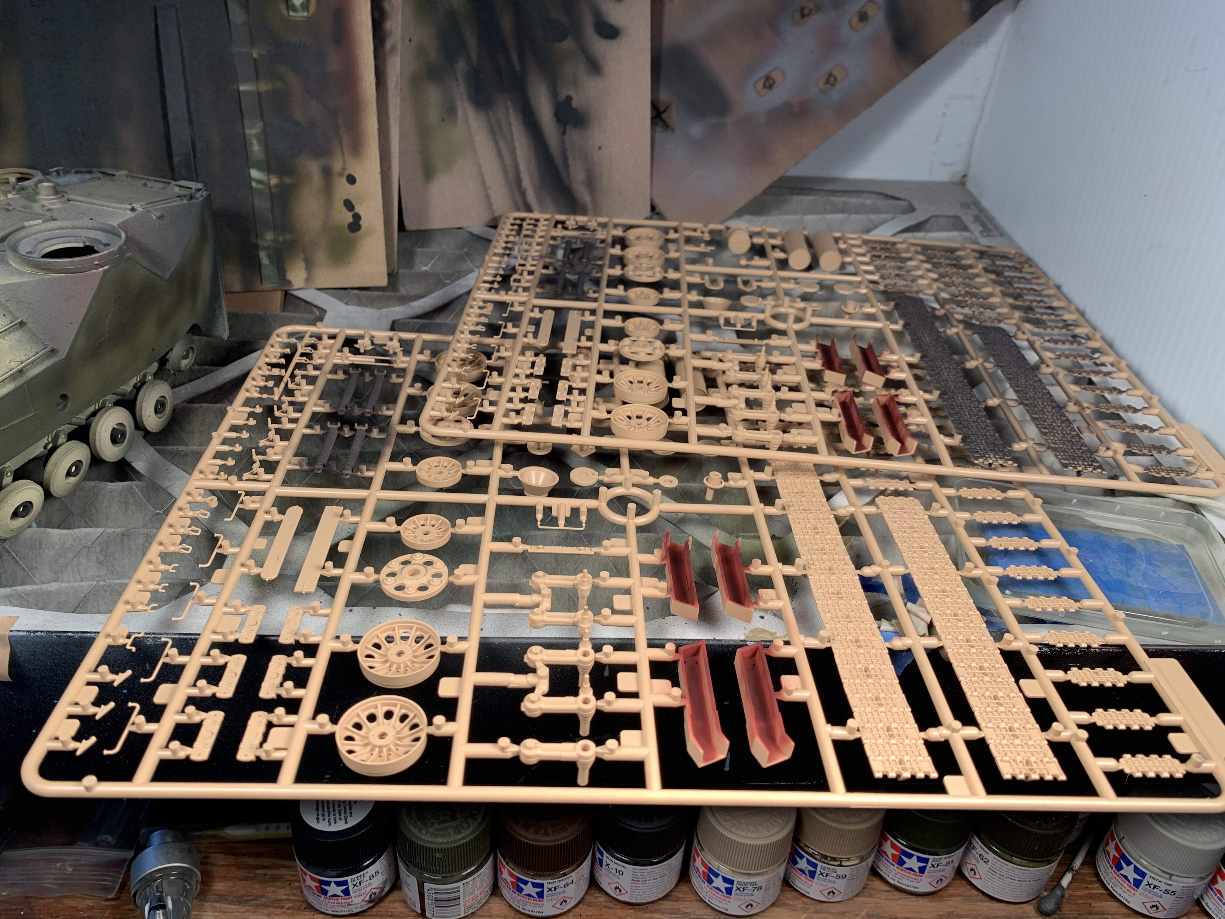

Would have done more but for the last couple of days, everyday was track day:
Thank goodness for magic tracks! Dealt with a few sets of track off of sprues, and it was not fun… The side of my pointer finger still feels tender to the touch where the guide horns kept pressing into my skin.

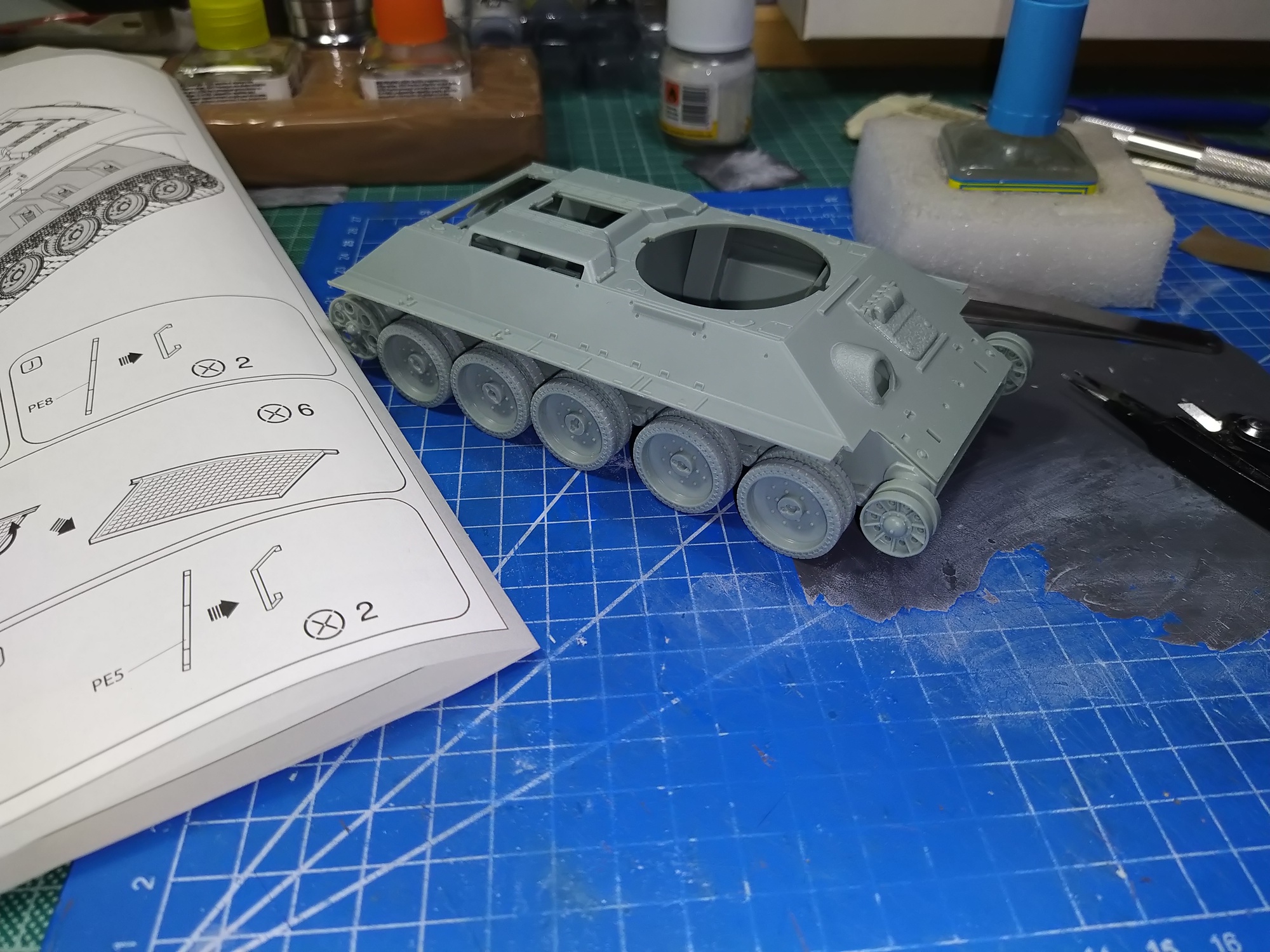

Started with the Academy kit which will receive the more attention.
It will be built into an Egyptian army vehicle in the early sixties with Star decals and I will use all the nice details from the dragon kit like photoetch straps and hinges on this one. Also Academy does not provide the smoke drums at the back but something lile fuel tanks, which is not correct.
I should replace the wheels with the late type ones but getting miniart stuff here is pretty difficult, so I will add the bolt head on the hubs and leave the pattern on the rubber sides as is. I will use the large hatch cupola and the fuel pump box included in the kit. Further details will be photoetch straps for the fuel tanks from the dml kit and smoke drums from the left overs of the Tiran 4 from miniart.

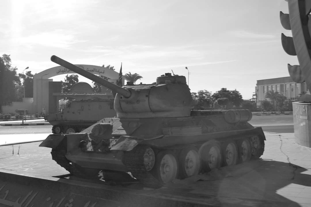

They had both. Finding photos of soviet made vehicles is difficult but I have found some. It is easier to find photos if T-34/100 vehicles on soviet made hulls. Syria also had both make of vehicles.
Egyptian soviet made vehicles:
