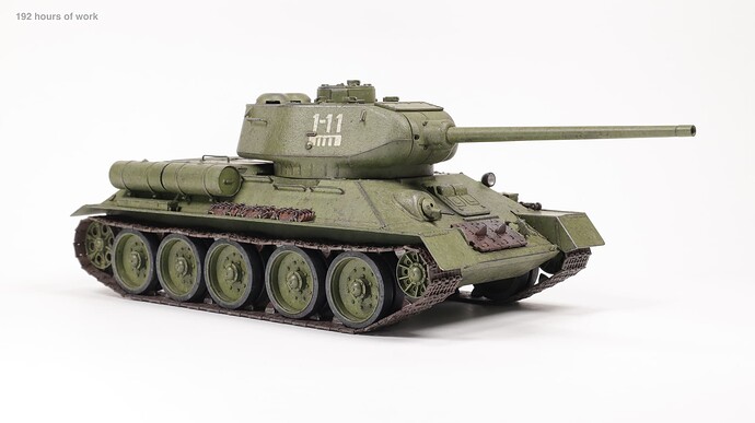

192 hours of work.
And splash again :laughing:
This time I used this:
Looks variegated.
But, most of this variegation will either be washed away or hidden by further weathering.

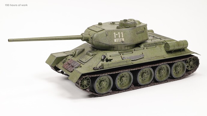

193 hours of work.
Today is one more hour of work.
Rubbed again with graphite powder :smiley:
And added fuel streaks and oil stains.

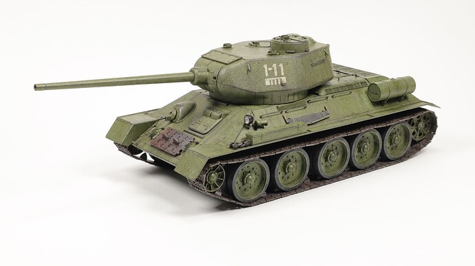

195 hours of work.
The next stage.
Made streaks. I didn’t try very hard. Since further weathering :laughing: will hide this too.
I used this:
Well, and…
Guess it once :grin:
Rubbing with graphite powder :joy:
