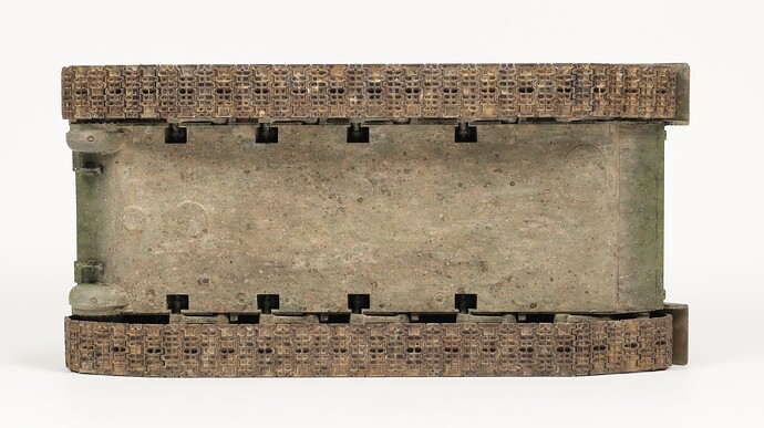

I continue to weather the lower part.
In addition to the “chemistry” that I used at the previous stage, I added pigments.
I added a little white spirit to the pigments and, using a bristle brush, applied it randomly to the tracks with random, pointing movements.
It turned out very motley. At the next stage, I will smooth out the sharp boundaries between the colors with a hard bristle brush. At the same time, I will remove excess pigments and fix everything with a pigment fixer.
207 hours of work.
I cleaned the tracks from excess pigment and smoothed out the colors boundaries.
A bristle brush turned out to be a poor help.
I had to use an eyebrow brush :laughing:
After cleaning, I fixed the pigments with a pigment fixer.
Result:
After fixing the pigments, the pigments themselves darkened and partially discolored completely.
