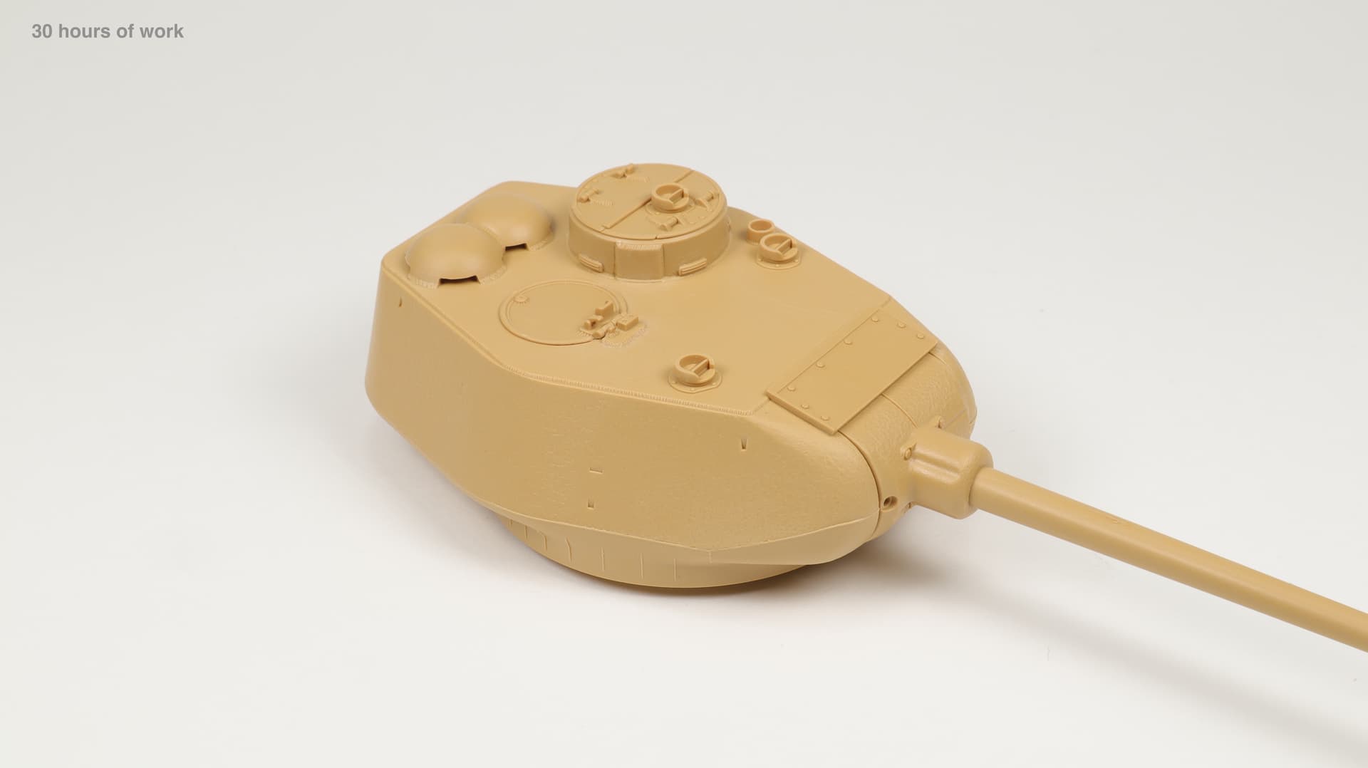

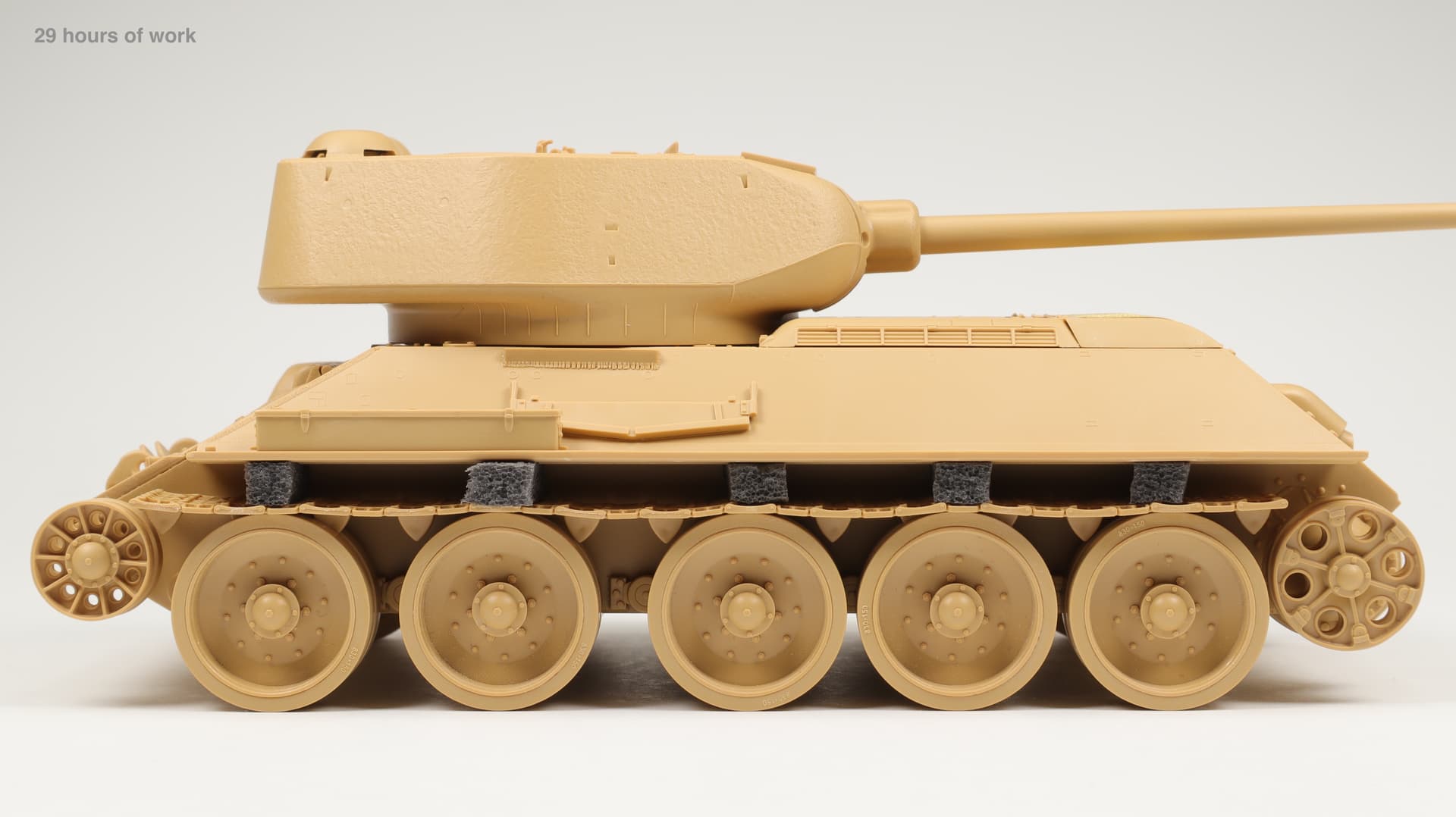

29 hours of work.
30 hours of work.

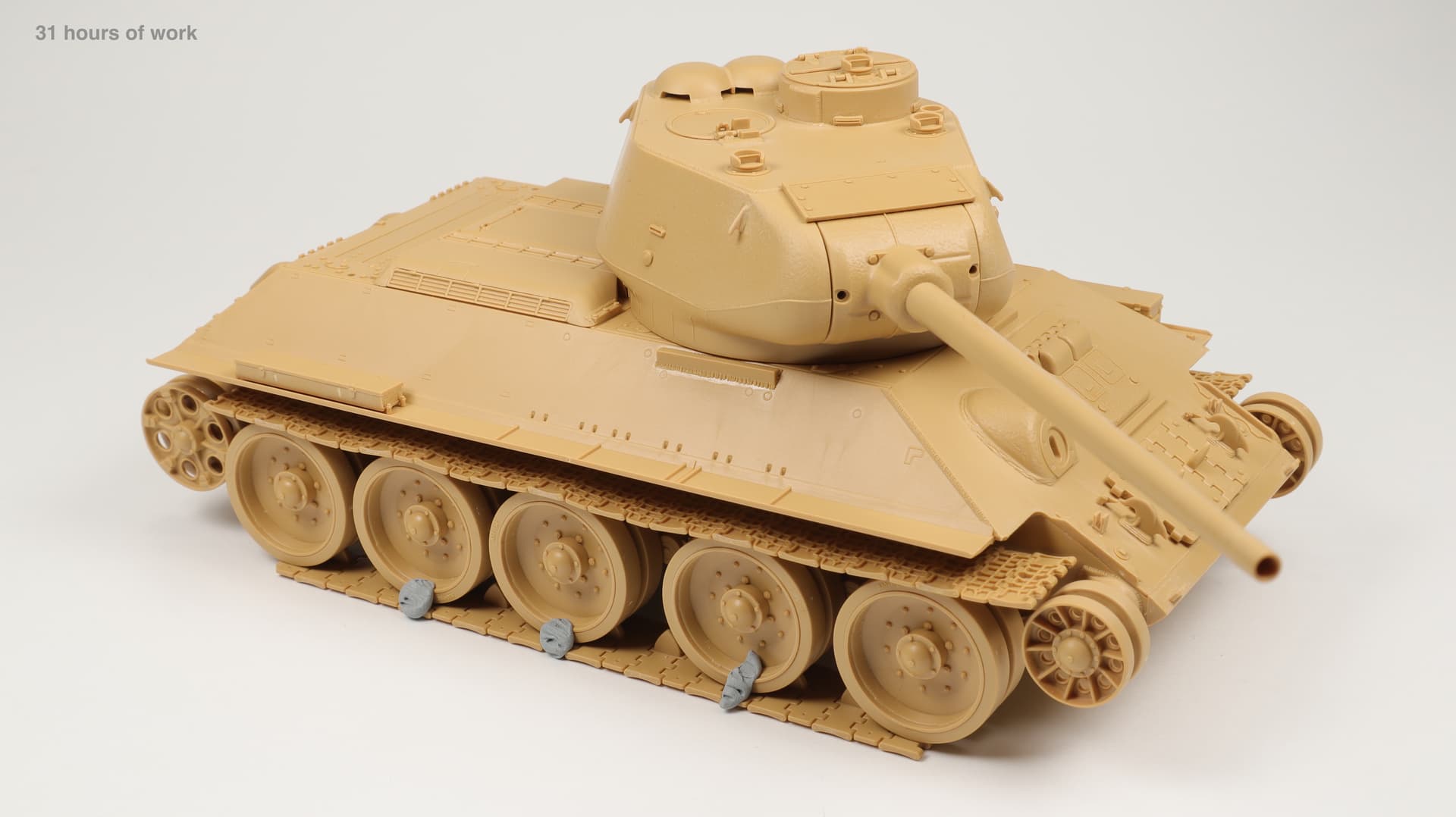

31 hours of work.

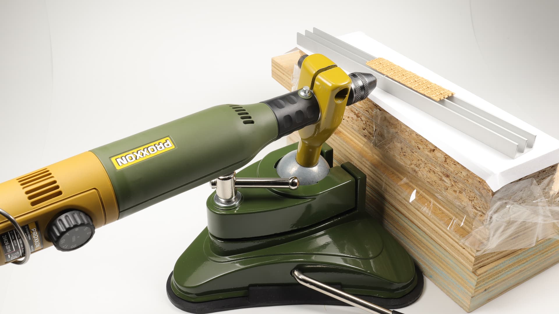

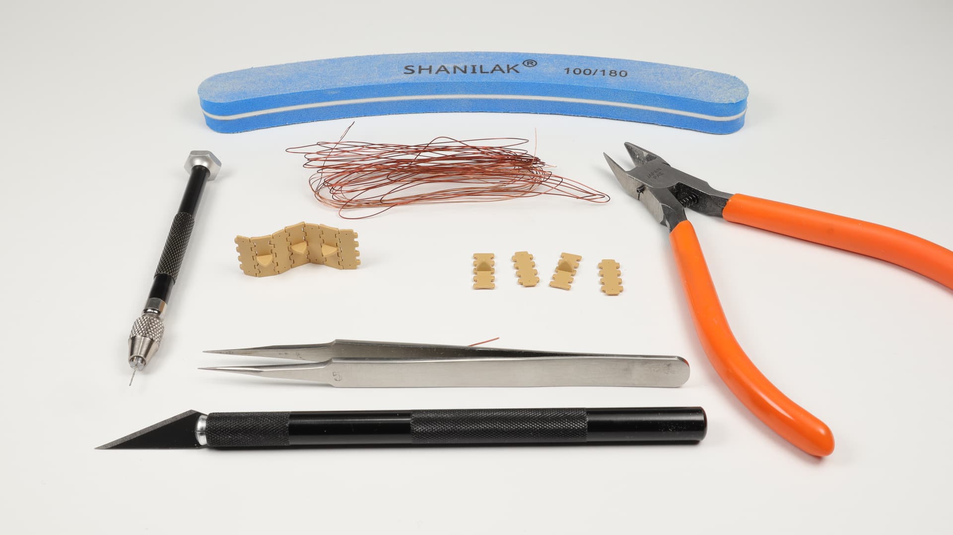

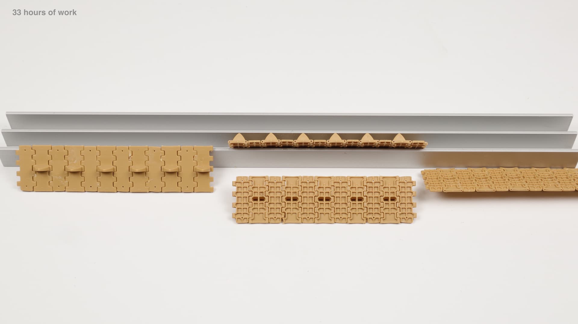

No. I will glue everything. For the purity of the experiment (painting a fully assembled model, without separate assemblies). But I will assemble the tracks in a different way from the usual one. :face_with_peeking_eye: I will show in the photo :grinning:

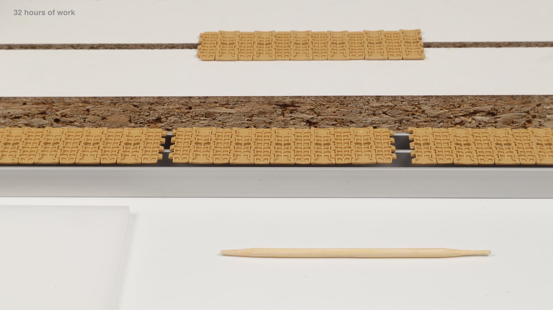

32 hours of work.

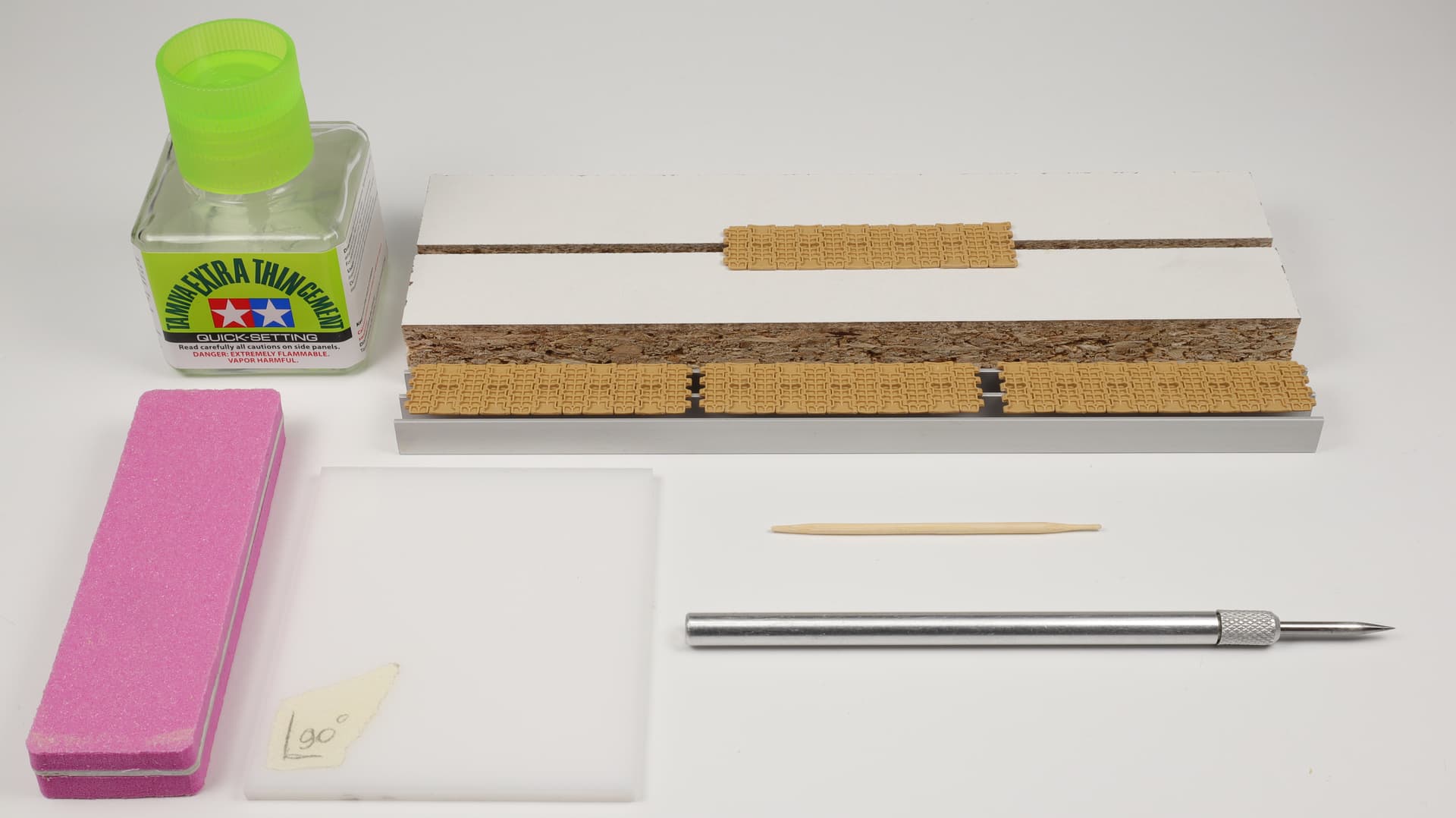

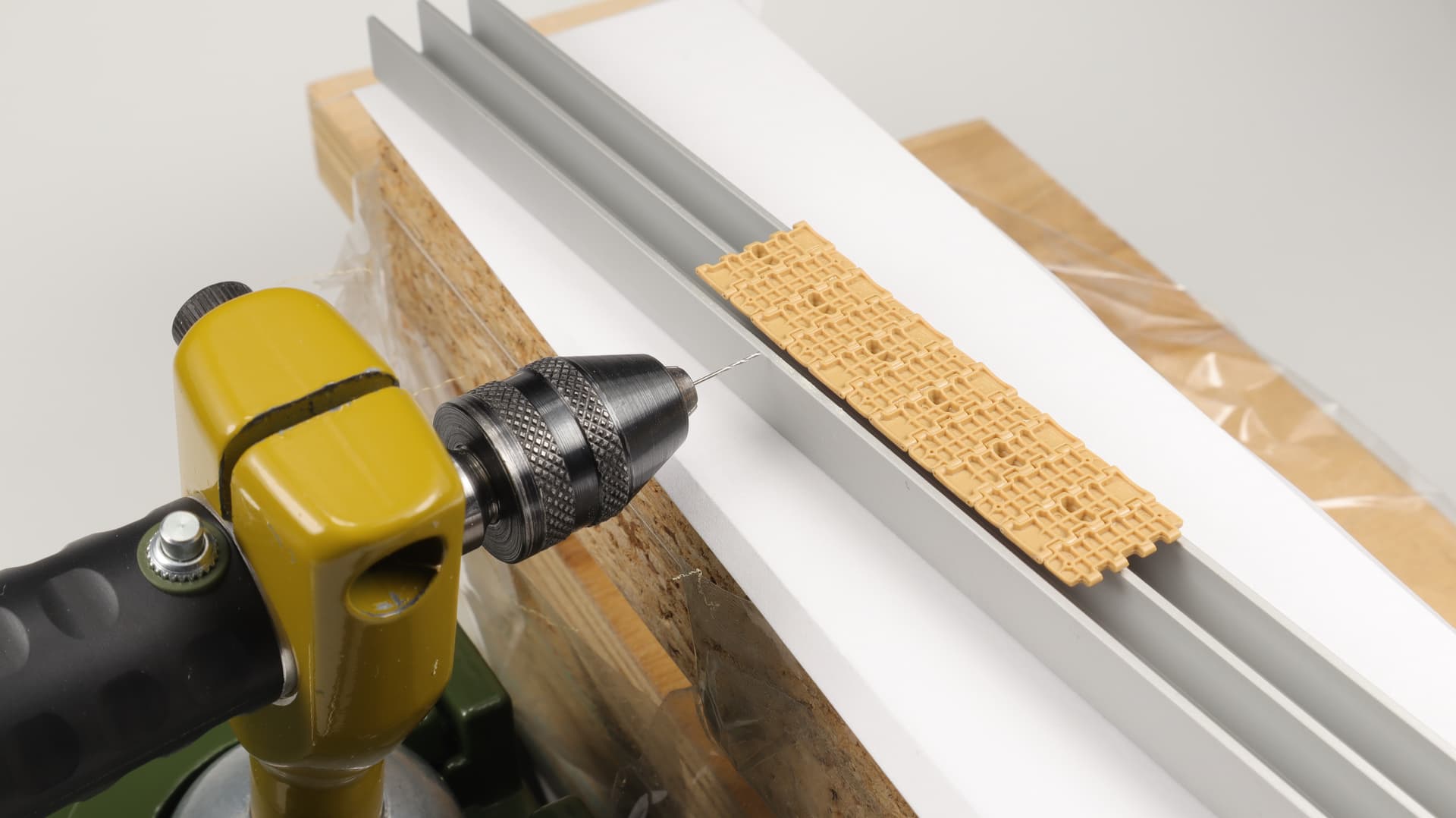

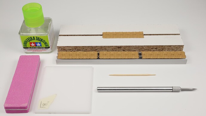

The places of future holes are pre-punched with a core.

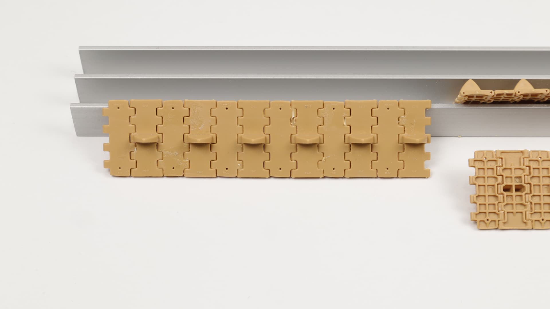

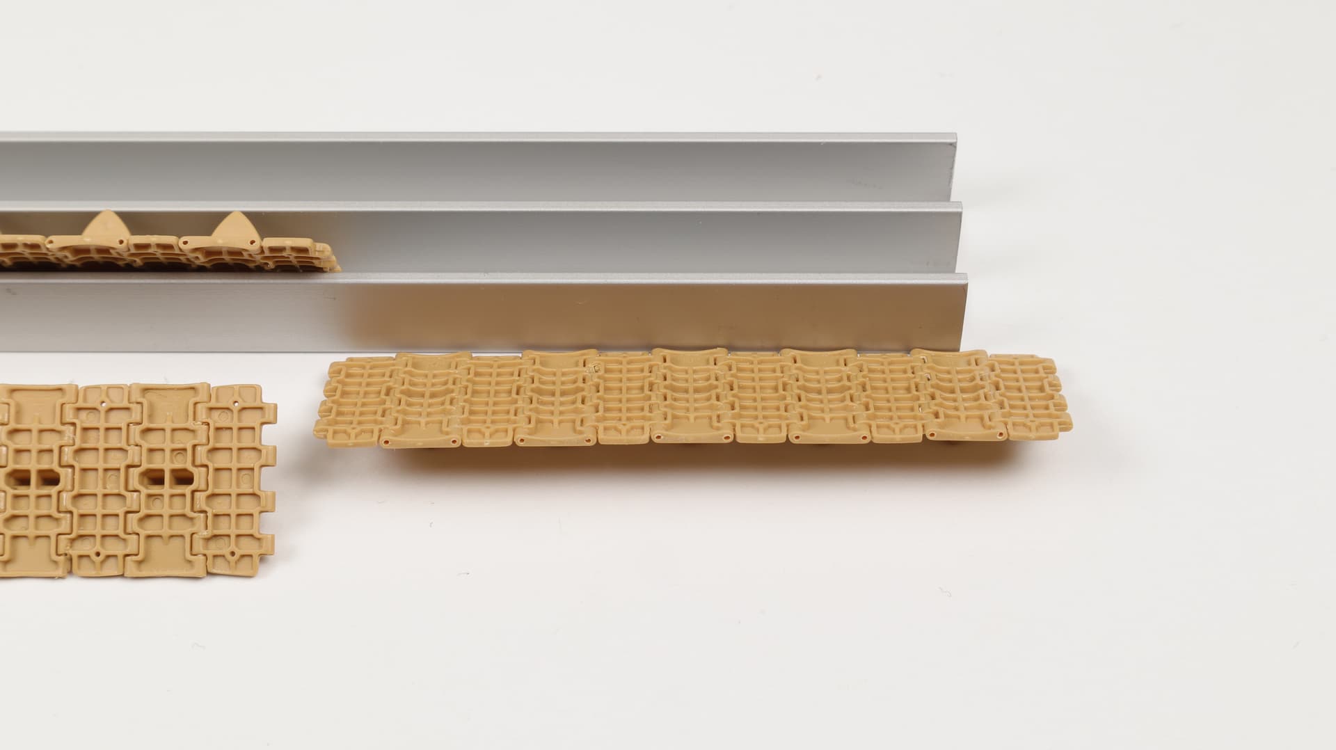

Based on the assembly instructions, I assembled four sections. On microdroplets of glue. So that during further manipulations the tapes do not fall apart.

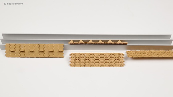

33 hours of work.

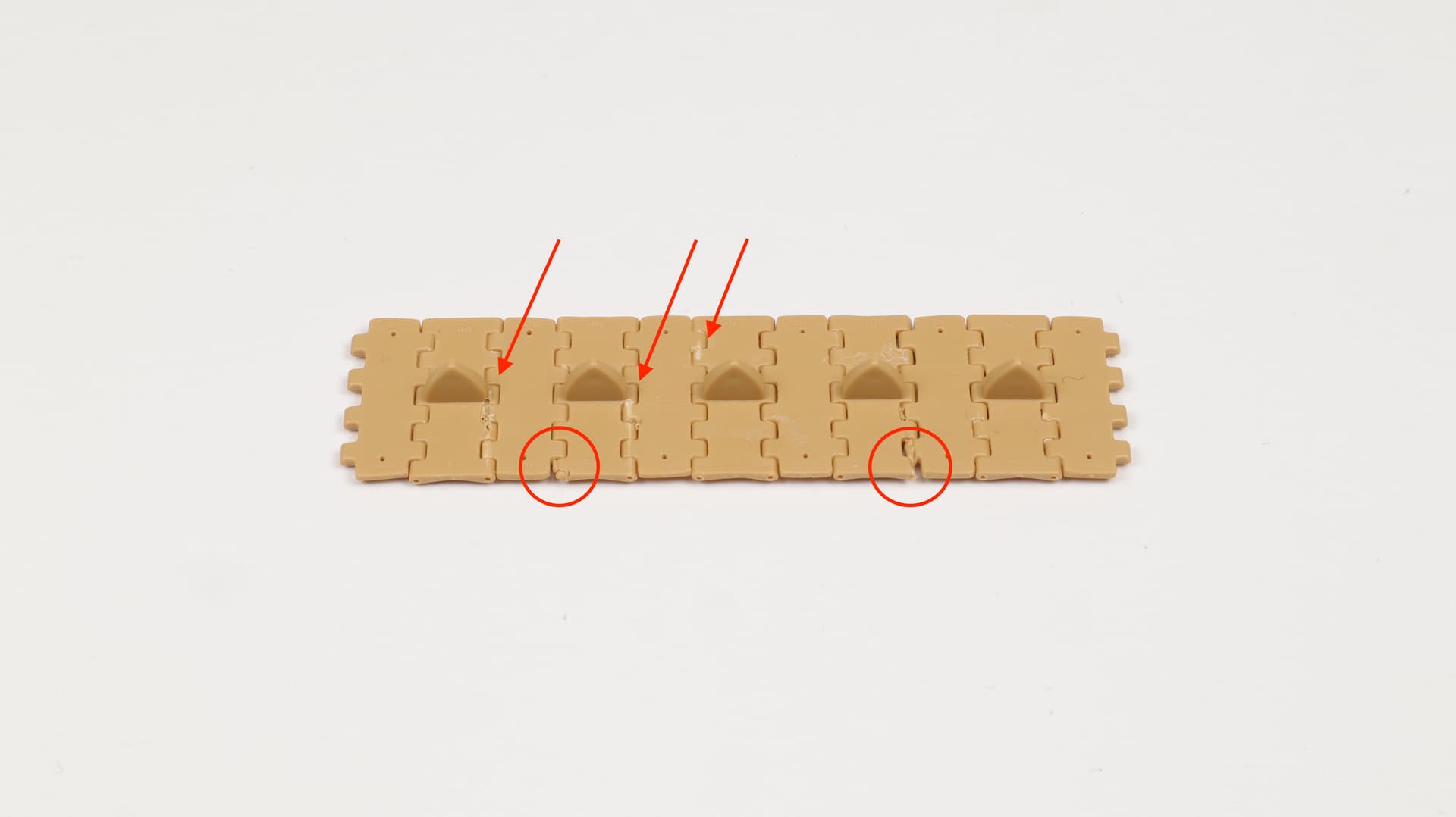

It wasn’t without trouble.
Melted plastic from high RPM.
Crooked drilling.

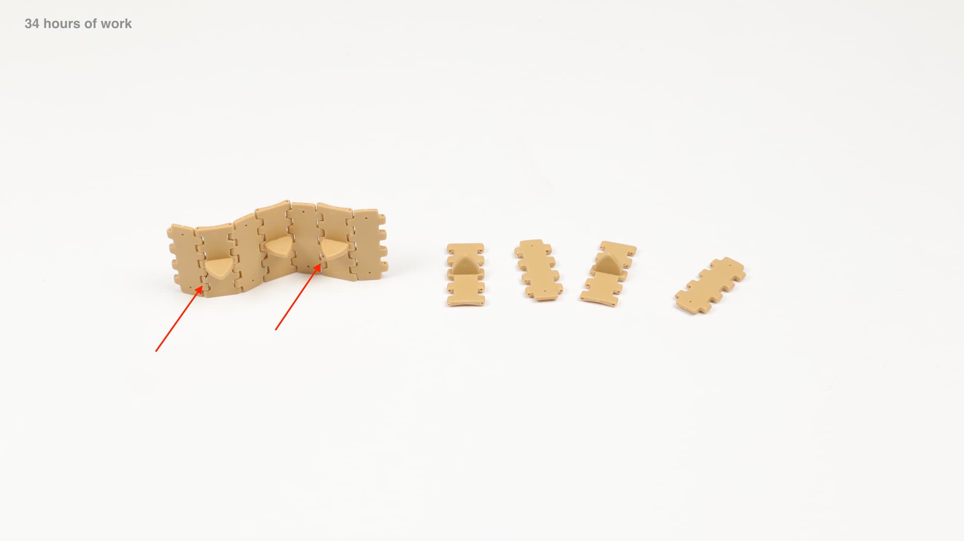

34 hours of work.

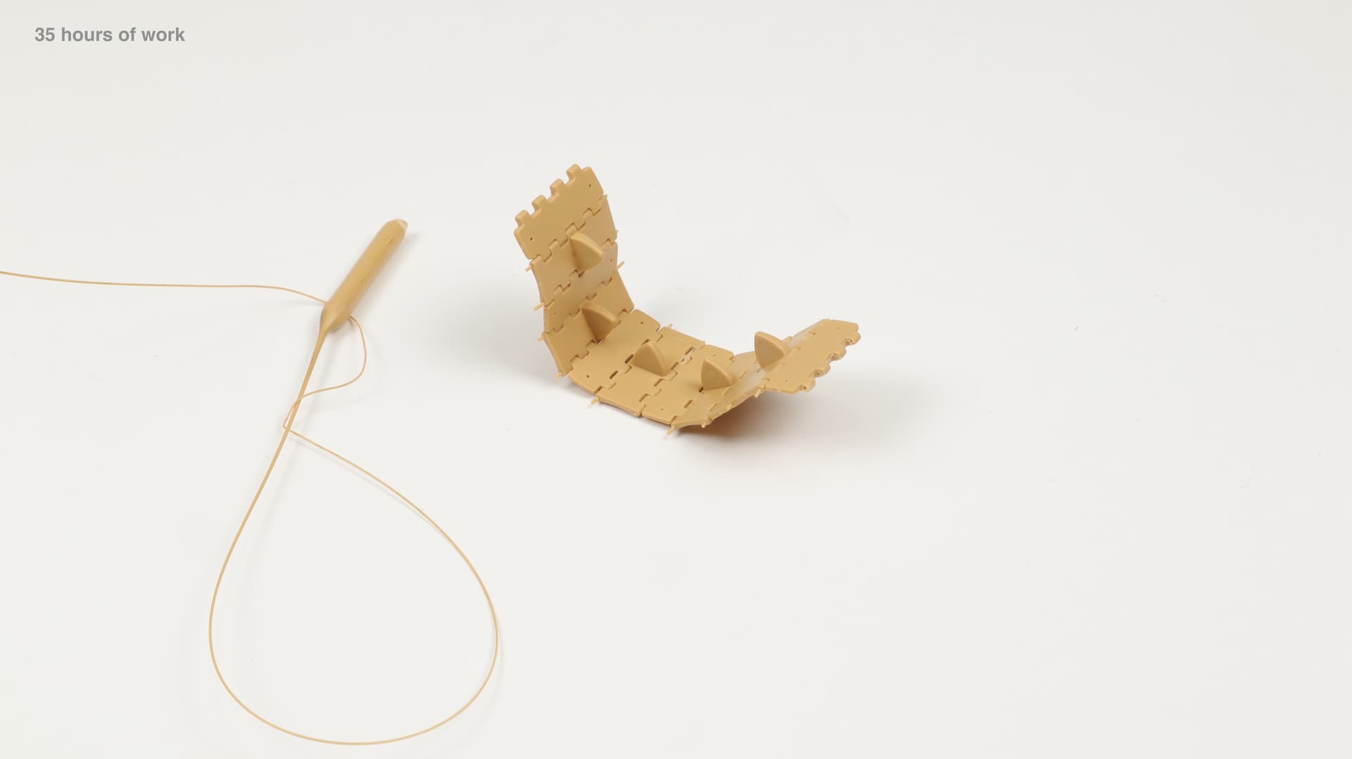

35 hours of work.
That is looking awesome, you have more patience than me.
Not that the tracks are bad but if replacing I would have went with the Tankraft tracks, basically what you did but for folks like me that don’t have the patience.
