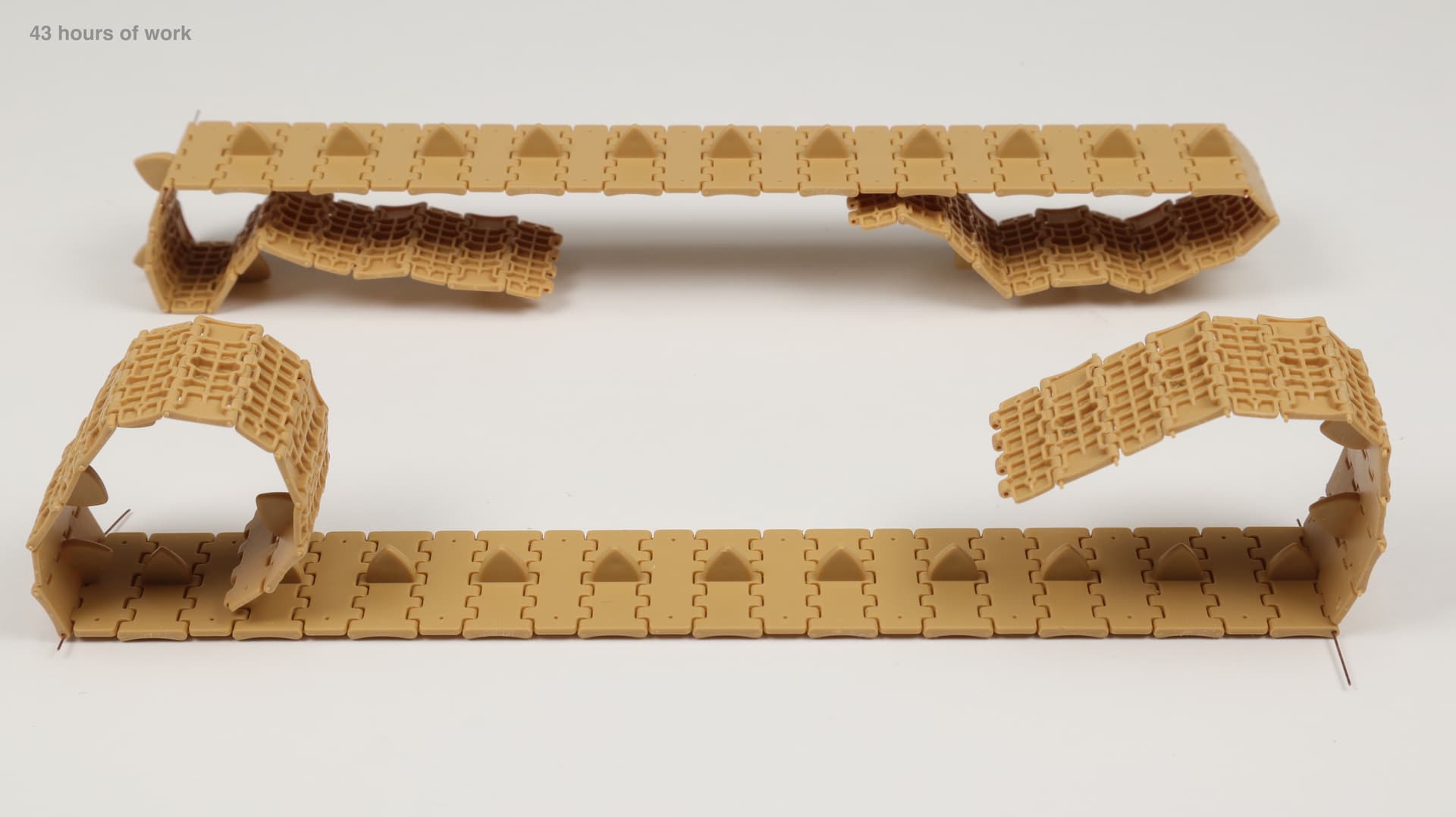

Tracks decided to make it workable for several reasons.
  1. I don’t like glue-filled tracks. At a minimum, in places visible through the light, the tracks should not be fused.
  2. It will not be possible to glue a pre-glued section on the drive wheels evenly. The driving wheels themselves do not sit tightly on their axles. Hang out.
  3. On idler wheels, the section is too long. I’ll have to move the idler wheels forward a bit. With glued sections, this will be very difficult to do. And with working tracks - very easy. Moreover, I did not glue the crank itself completely, but only grabbed a couple of microdroplets of glue.

Hi all!
I will continue. I’ll work for a couple of hours, take a break, and then continue again.

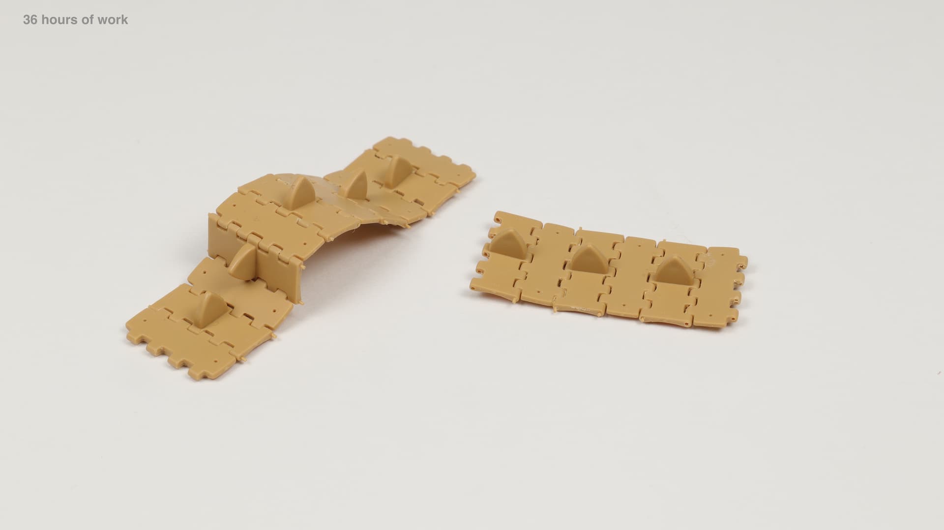

36 hours of work.

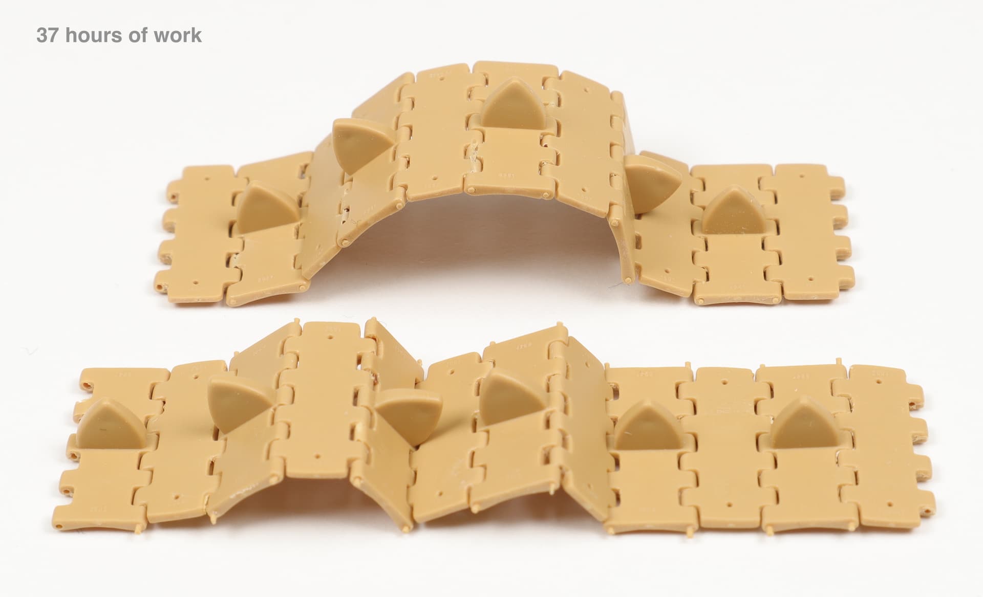

37 hours of work.

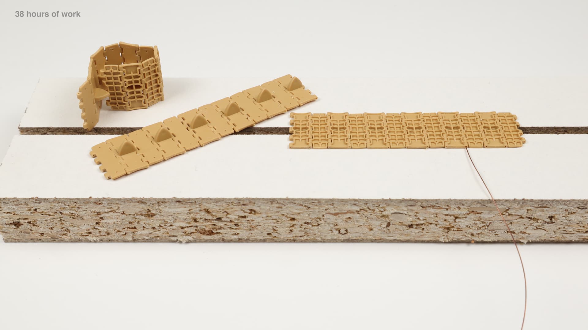

38 hours of work.
39 hours of work.

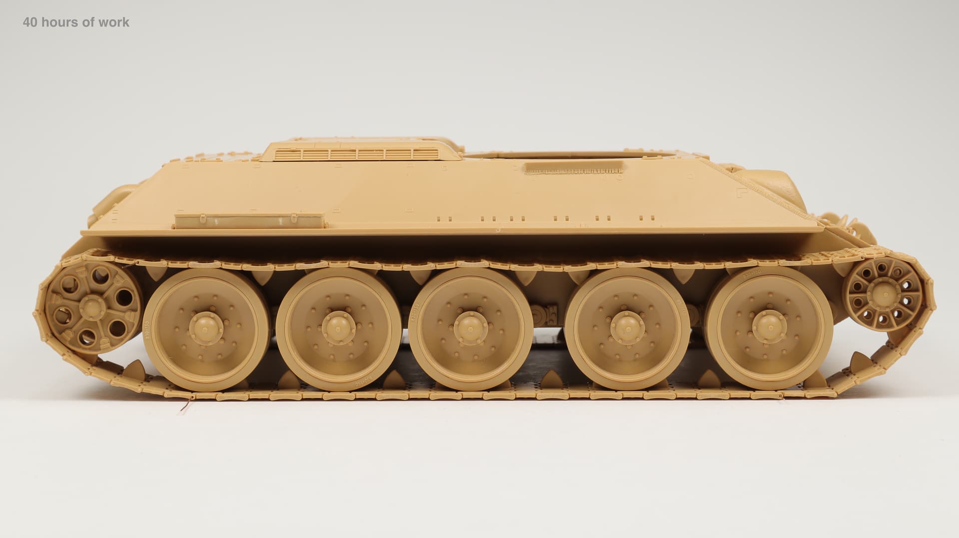

40 hours of work.
The idler wheel will have to be moved forward significantly.

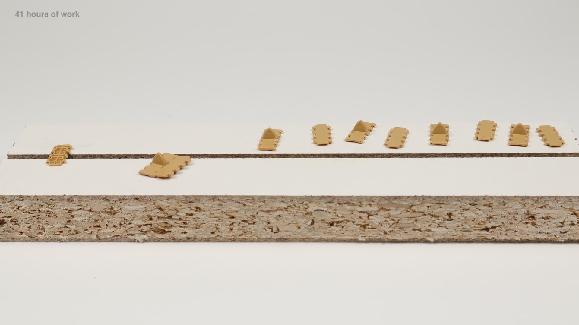

41 hours of work.
42 hours of work.
43 hours of work.
Left just a little bit! :astonished:

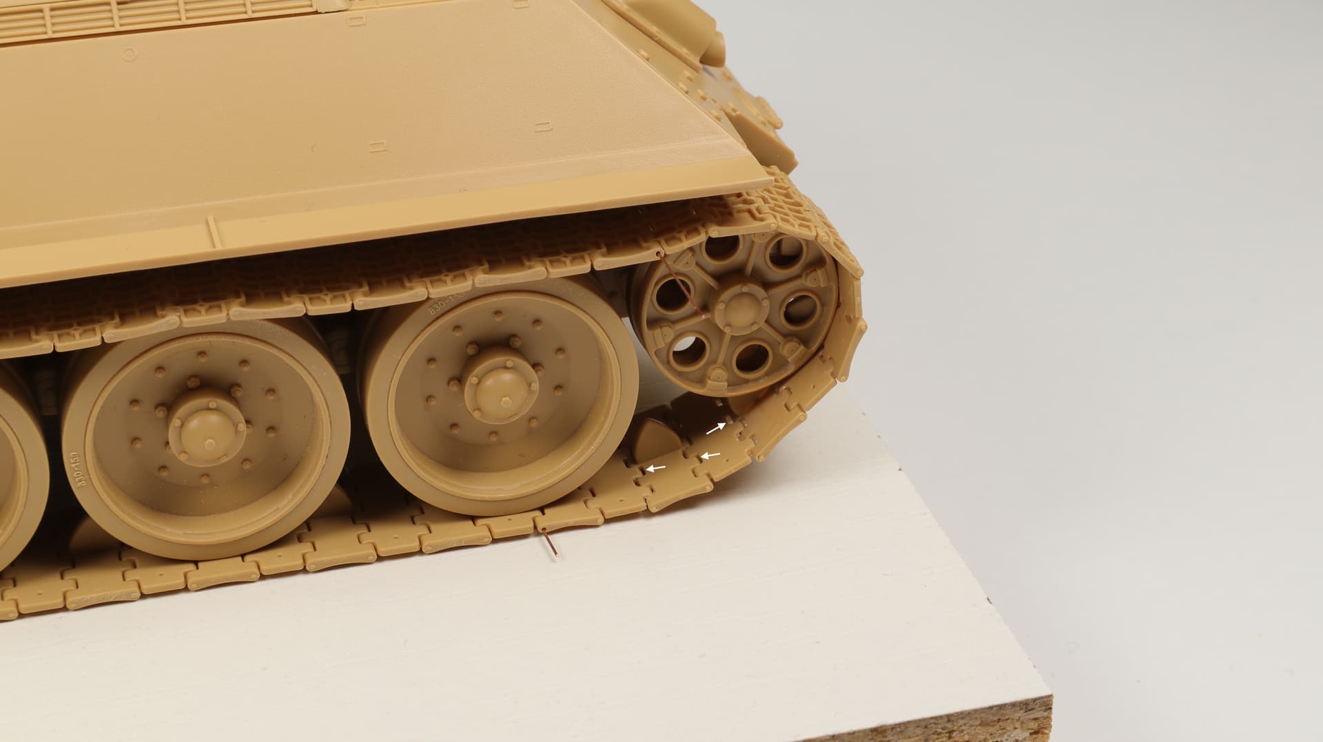

44 hours of work.
Oh, and it’s hard all somehow goes! :confounded:
I don’t like what it turns out. Too large distances between the tracks turned out. :unamused:
With manual drilling, everything is clearly obtained.
Okay, more about this later. I will share my impressions and conclusions from the results of this experiment with a drill.
checked the rest of the sections - it turned out more or less normal there. Such gaps only in one place turned out.
I’ll redo it. :rofl:
