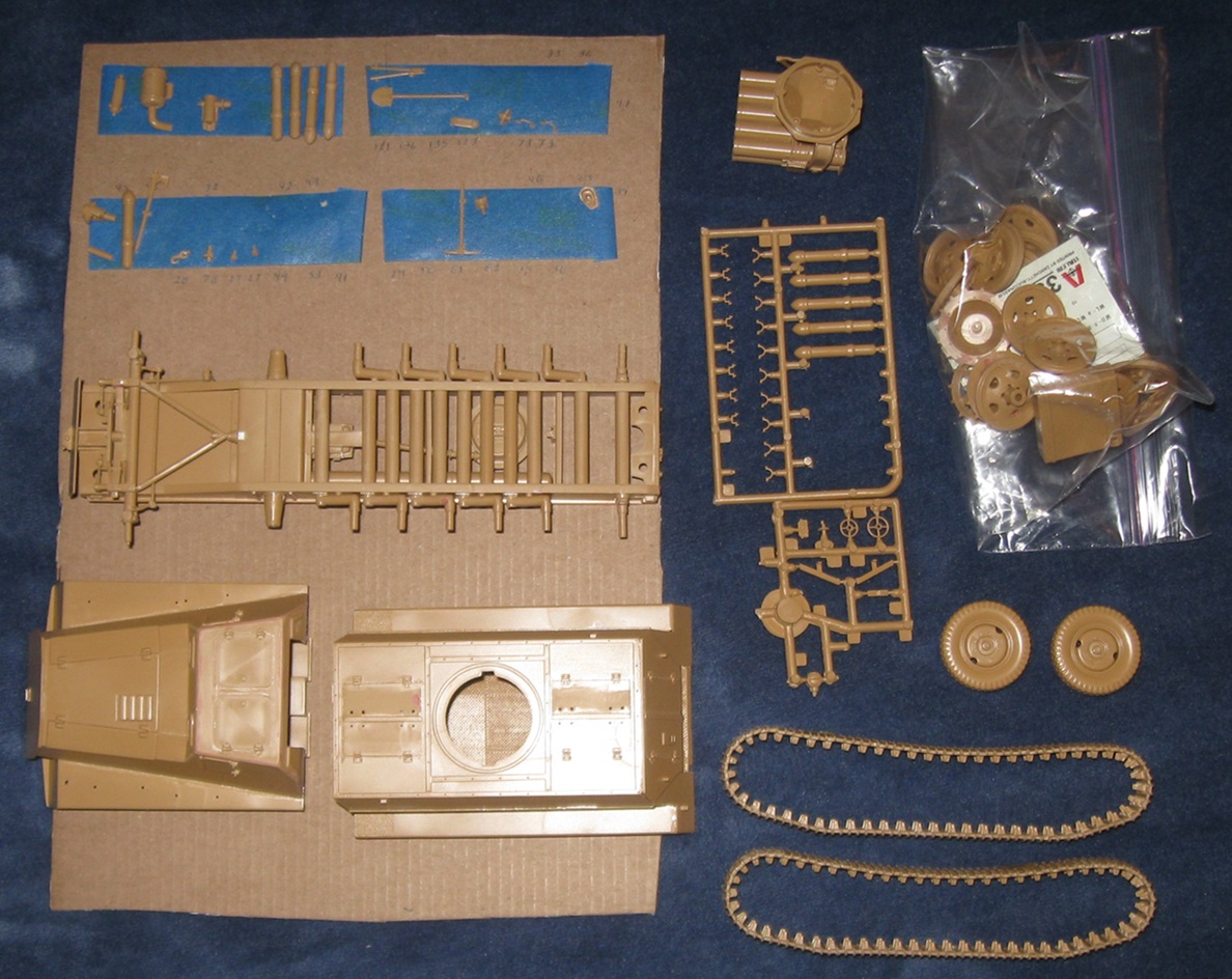

As I build, loose parts go into one plastic bag. Spare parts go into a different plastic bag. At some point in the construction process, I want all the runners gone. I take a sheet of cardboard, add tape strips sticky side up, clean up small parts, drop them onto the tape, and number them. I may also leave clusters of small parts on sections of tree.
The system above works well for short and medium duration builds. The tape will eventually let go so do not use this system for very long term storage.

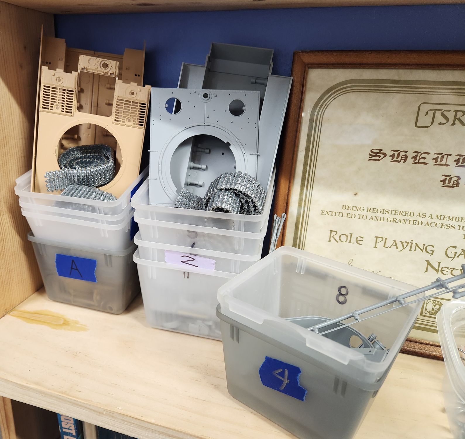

While not in bags because they are next up for assembly, here are two Tiger kits I have broken down and cleaned, ready to go:
As you can see the track cable is still attached to a section of sprue to keep it safe.
