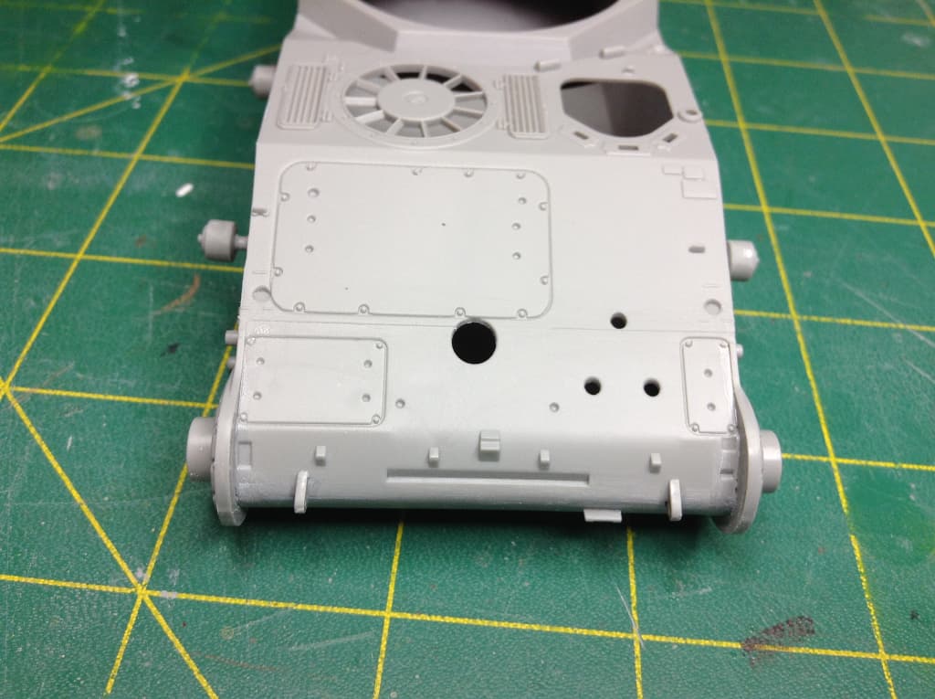

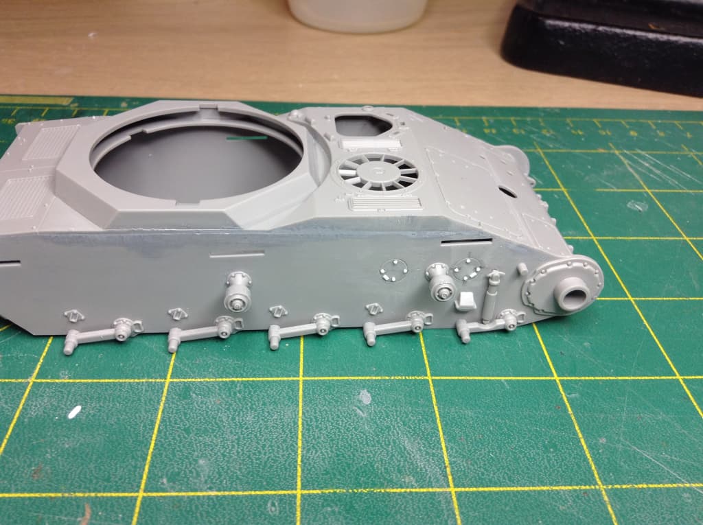

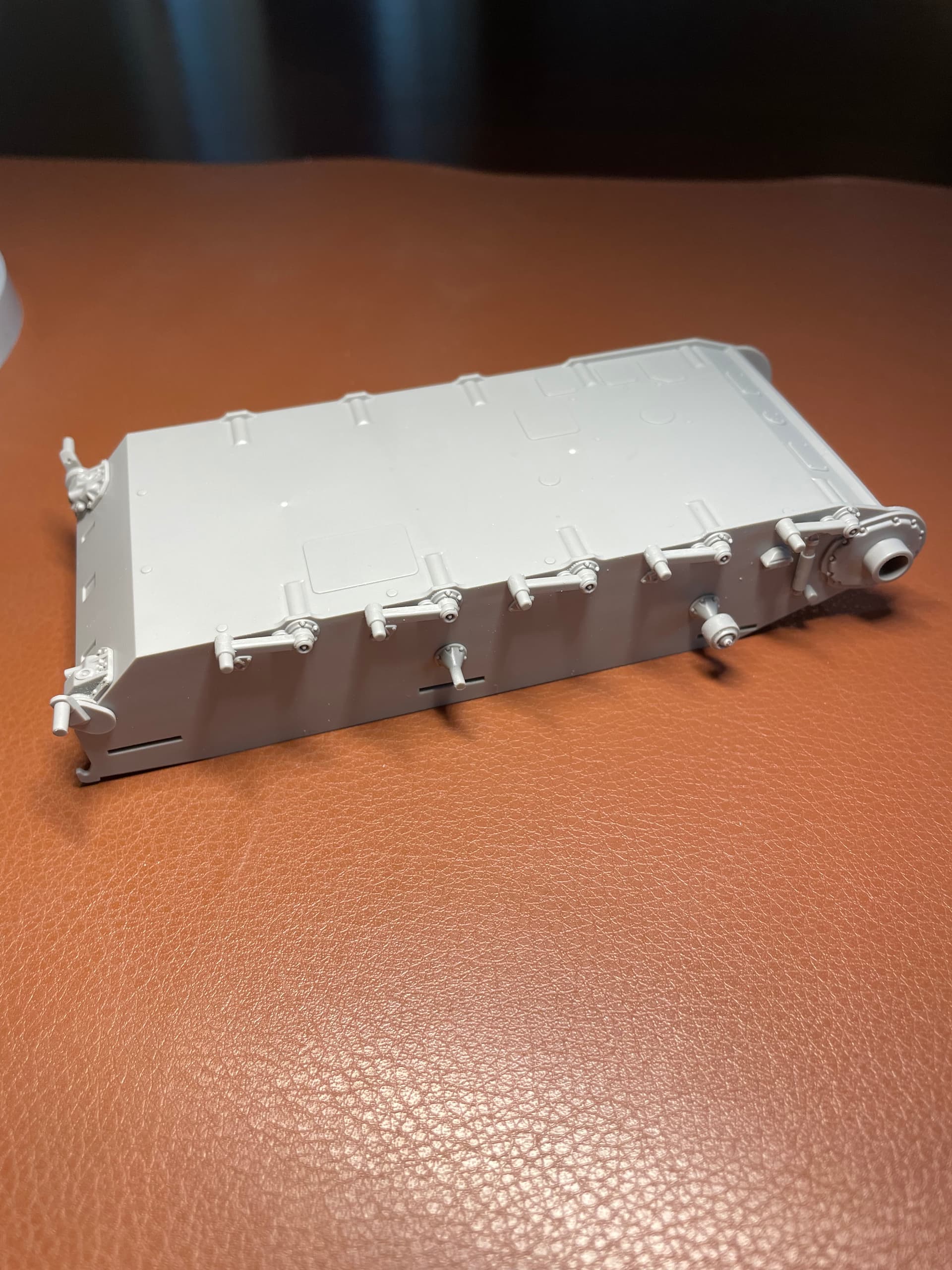

So while on a two week trip, I decided to bring something to work on since it’s not really a pleasure trip and we won’t be site-seeing. The wife will be working as well, remotely. I decided on this kit from Takom.

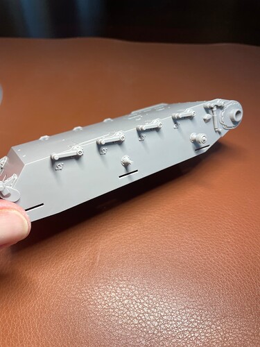

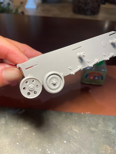

This is kinda the reverse of the kit I built a few years ago of the Chaffee hull with the AMX-13 turret. Love these kinds of odd balls. My progress so far:
Some observations:
The sprue gates are kinda big but easy to cut off and sand smooth. The suspension parts all fit very good, the road wheel arms are a tight fit in their key holes so I hit a few with a file and no problems.
I’ll leave the wheels off til I get home and paint them separately from the hull which is my norm.

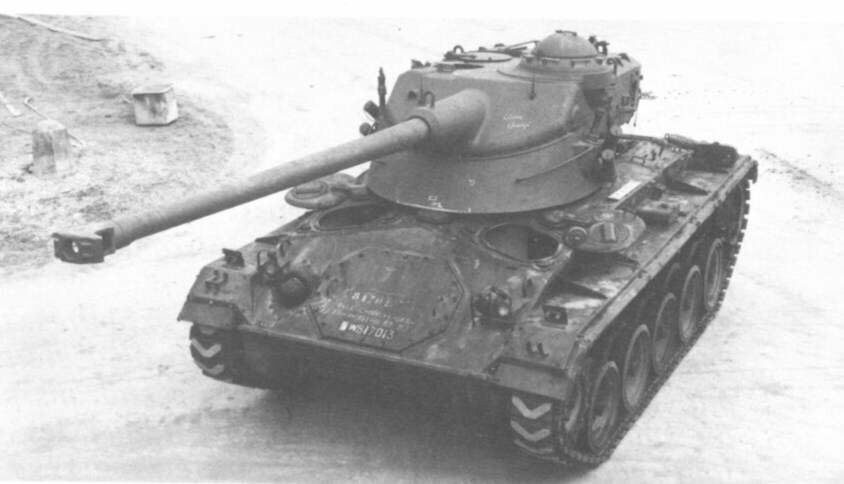

I have this excellent book as a reference. My only minor gripe is there are no line drawings but there are a couple of illustrations. Otherwise it’s excellent.

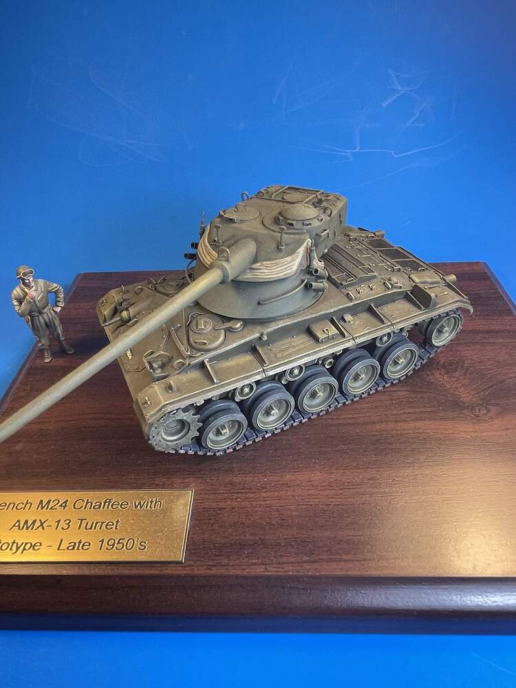

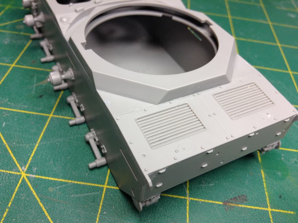

I managed to find a pic of the previous model I did back in 2017 I think. This was the French AMX-13/Chaffee hull.

I remember your model Russel and it’s quite impressive. Excellent job.

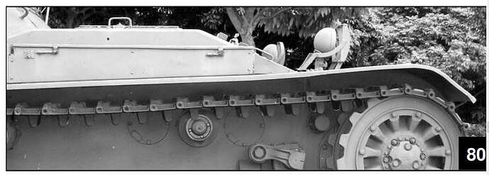

I’m looking at a chart in this book and it lays out the various features for the different chassis styles. It mentions a shock absorber for the front and back wheels but I only see the ones for the front in the kit. Nothing in the directions.
Did your Tamiya kit have both front and back?

The Tamiya kit also has shocks on the first and last road wheel stations only. If I recall, that’s typical of the early ones, pre-rebuild.

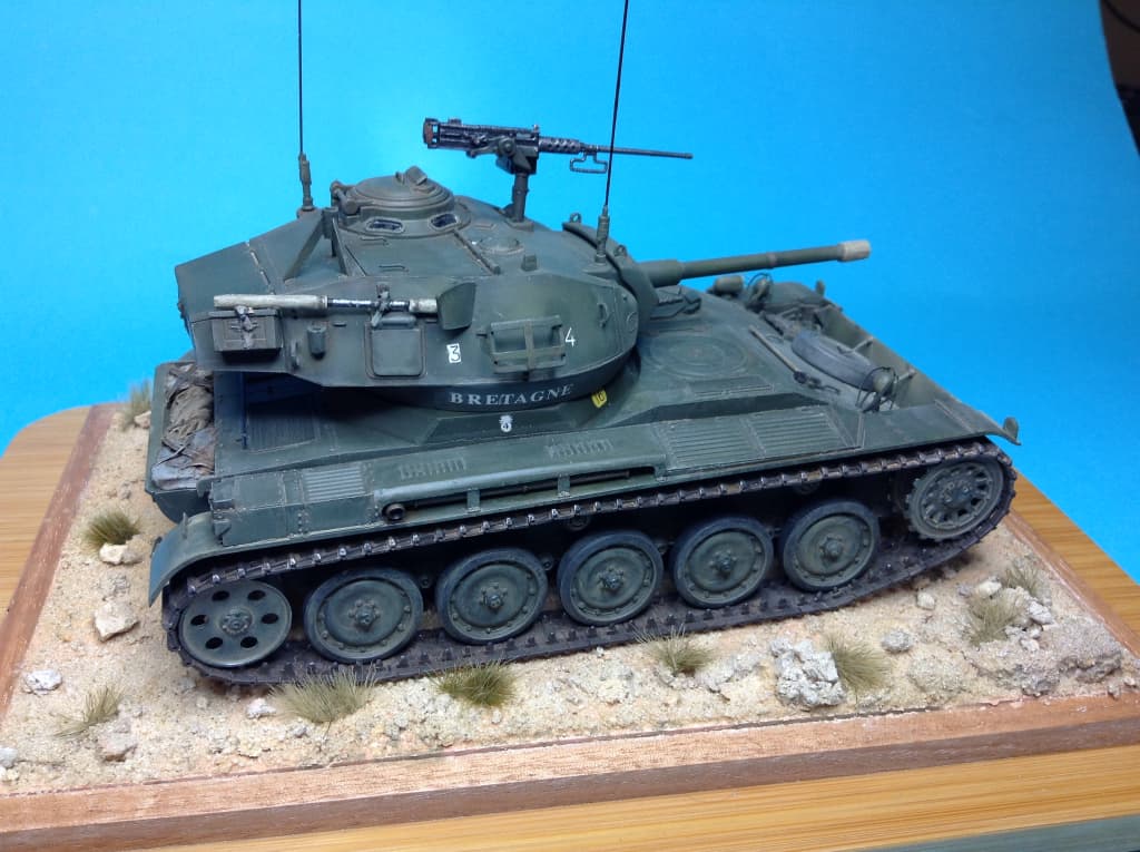

I built this one a while back Richard. Not sure if accuracy is your thing, but the kit has a couple of issues.
One is the access ports on the side - they should be flush, not protruding:

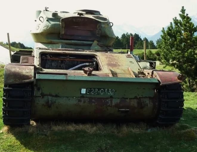

A panel joint needs to be added along the front and one along the rear:
One of the biggest fixes is that the wheels should be bolted, not welded - the welded wheels were not used on these ones:
Weld bead and corrected bracket on turret:
And the spare barrel for .50 Cal and its boot ends:
The one I modelled:
The panel line:
Peter thank you so much for your reply and the pics. Your model looks excellent. Love the corrections and especially the finish!
Also, I’m not sure if I’ll replace the road wheels. I will try to scribe the panel lines though. As for the access hatches along the hull I’ll probably leave them as they are.
What color did you use? And is that a mortar mounted on the right side of the turret above the ammo boxes? Again, outstanding job !

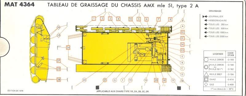

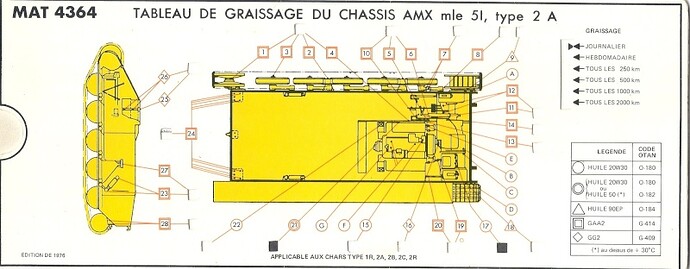

Concerning your question, the early suspension (type 1 to 2C) had a second shock absorber internally fitted to the rearmost wheel arm. Here is a drawing from the technical manual where you can spot it.

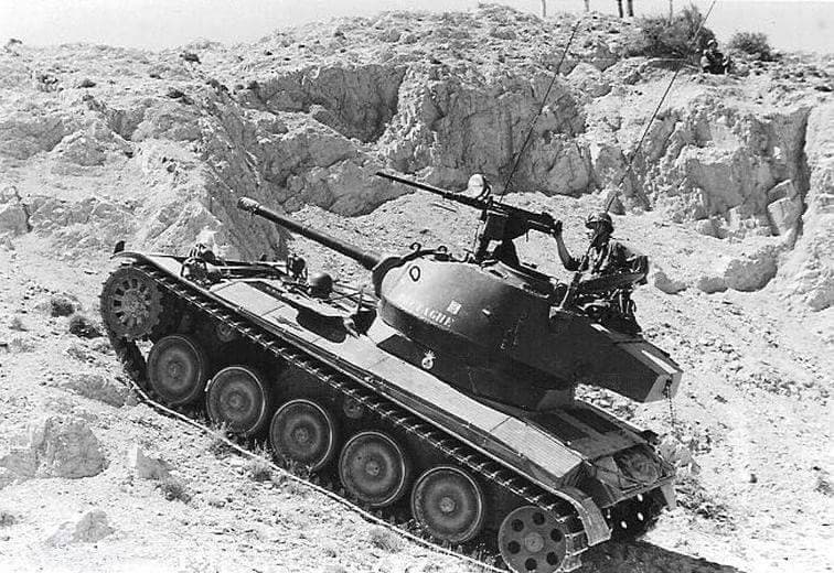

So this was a actual vehicle? The turret seems a bit heavy for the hull.
Yes it was. During the war in Algeria the need for anti-infantry support raised but the the AMX 13 autoloader and the French HE round fuse weren’t good friends ! So extra Chaffee turrets were adapted to existing hulls. This experiment was short lived though probably because the weight was too heavy for the hull and suspension and the number of stored rounds not high enough.

If the second shock absorber is mounted internally, is any part of it seen out side the vehicle? I don’t think a second one is provided in the kit, I’ll have to check.
Never mind Peter, I see that it is the extra .50 Cal barrel mounted there.
