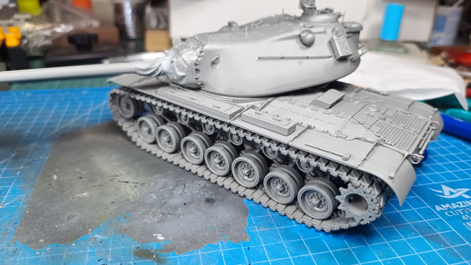

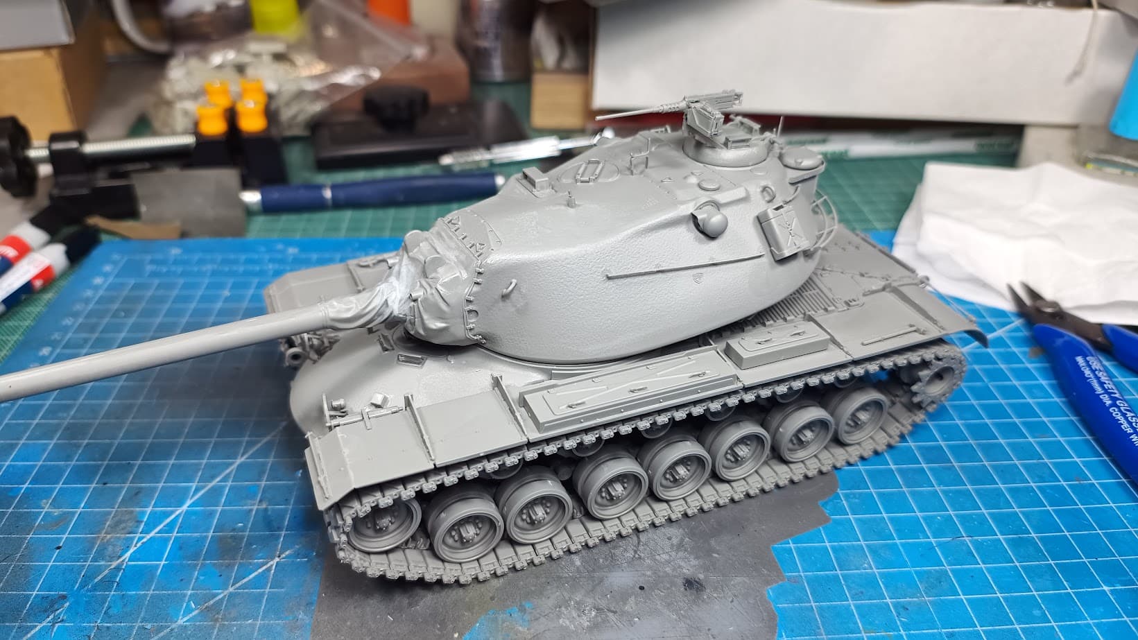

Now that is looking really very sharp’; 'looking very forward to seeing the paint scheme.
Looks great. I hope one day to see a replacement barrel.

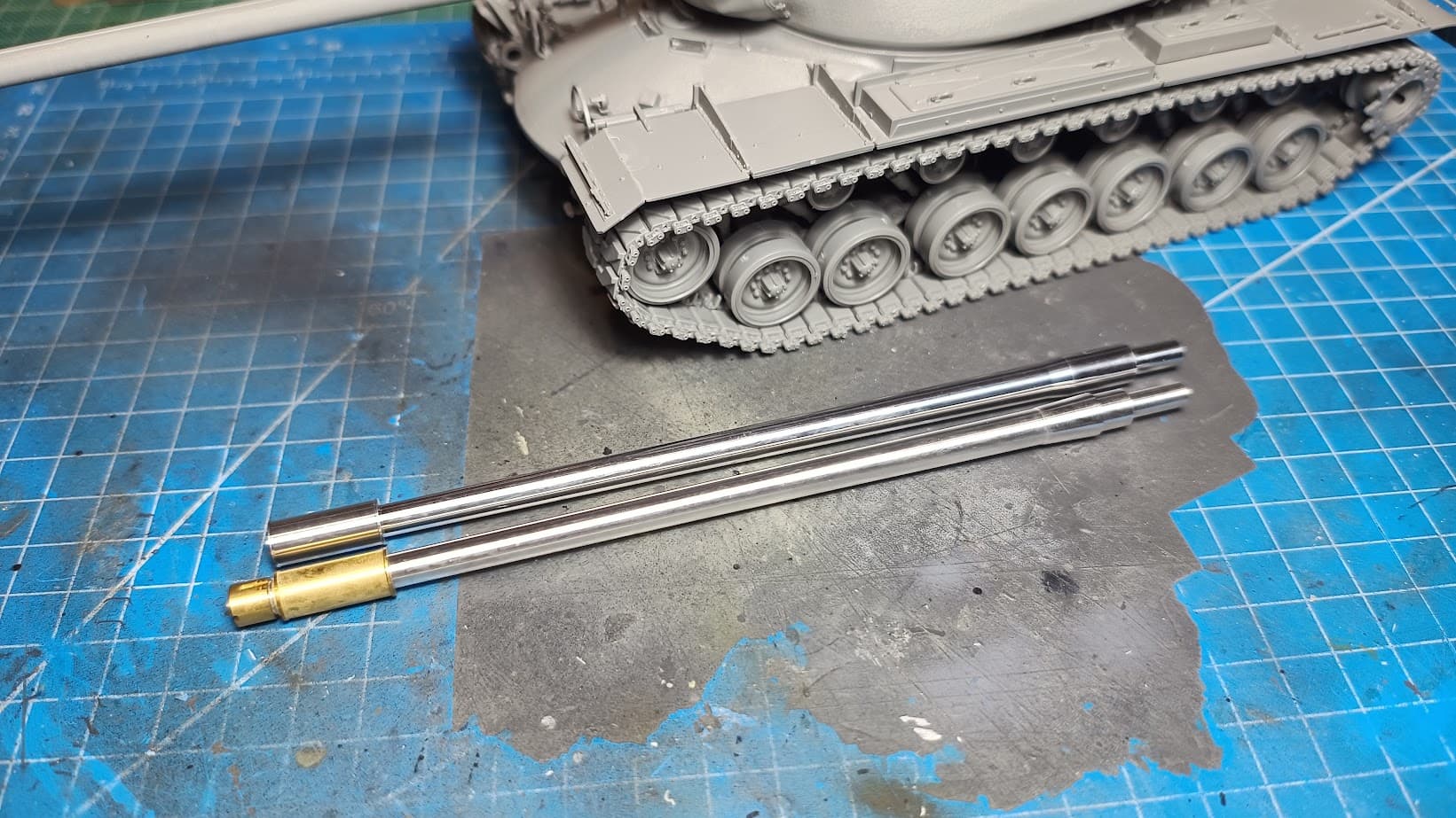

Dan, did you mean you’d like to see a replacement barrel on this particular build, or were you asking generally? Metal barrels are available, although I think initially for the Dragon kit. Aber make them - I’ve bought 2 - as I still have the Dragon kit as well as the Takom version.
I do not think the Aber barrel or the RB one released for the Dragon kit will do for the Takom kit.
In the photo, the kit included barrel for the matlet without canvas cover and the RB barrel for the Dragon kit
I’d actually forgotten that; I purchased the barrels, added them to the boxes then retired(!)
As I will probably display them together I shall try and adapt both of the barrels as necessary; I suspect this will mean I have to fashion my own mantlet cover but I don’t mind that.
I mean generally, not this nice build.
I’m not good a puttying and sanding a barrel.

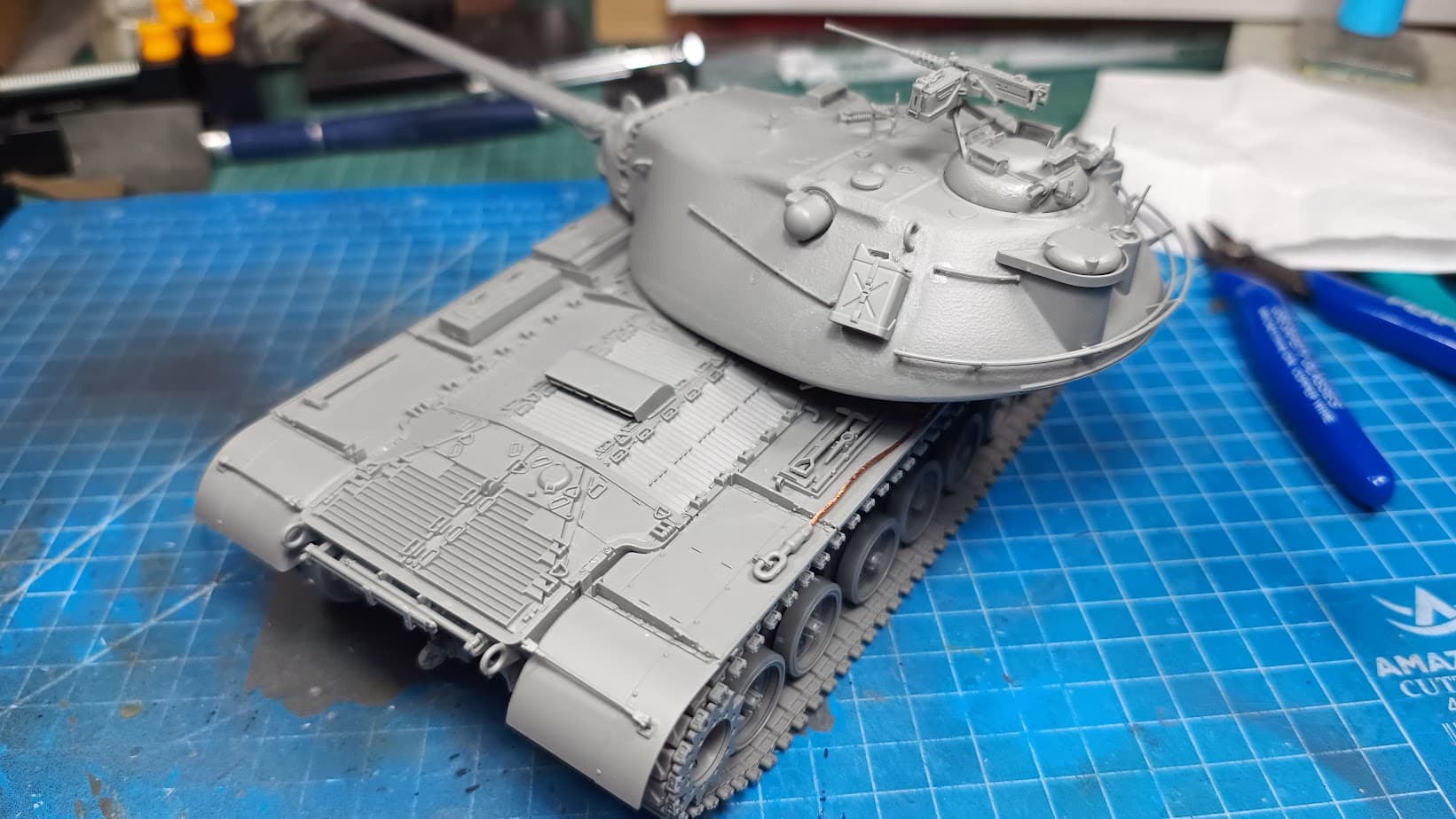

Can this be backdated into a M103?
I would say that yes it can.
- Hull details: Everything is there, the only details missing are the muffler for the auxiliary generator on the right fender, as mentioned in previous posts, and the tow pintle mount at the back of the hull next to the left transmission cover, indicated N in the photo:
- Turret details: You will need to get a Chrysler cupola, luckily some 3D designers have worked in producing one. You will also need to remove the gunner’s periscope from the front of the turret and the equivalent bulge. It would be wise to use some material to fill the inside of the bulge from the turret piece inner side so as to make your work easier.
Then you need to add the periscope and its cover on the original position on the turret roof. I am pretty sure that the optimal choice is a periscope and the cover from a M47 tank.
Another detail that needs to be added to the turret roof is the .50 cal storage mount.
And the final detail is the barrel counterweight. Here you either need to work on the kit part and modify it by etxending it and adding the hole on either side or make a new part.
I am pretty sure if someone wishes he can 3D design a conversion/backdate kit easily.
P.S. The US Army decals included in the A1 kit will do just fine for a M103.

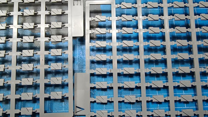

A final addition to this review is that TAKOM correctly includes T107 tracks in the kit, not T97E2 tracks like in their M48 kits.
E sprue is included in the M103 kits, T107 track, A sprue is included in the M48 kits, T97E2 track. The difference is in the grouser shape, minor change in the angle and width.

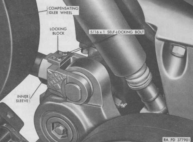

Front idler adjusting mechanism. The kit parts are similar.

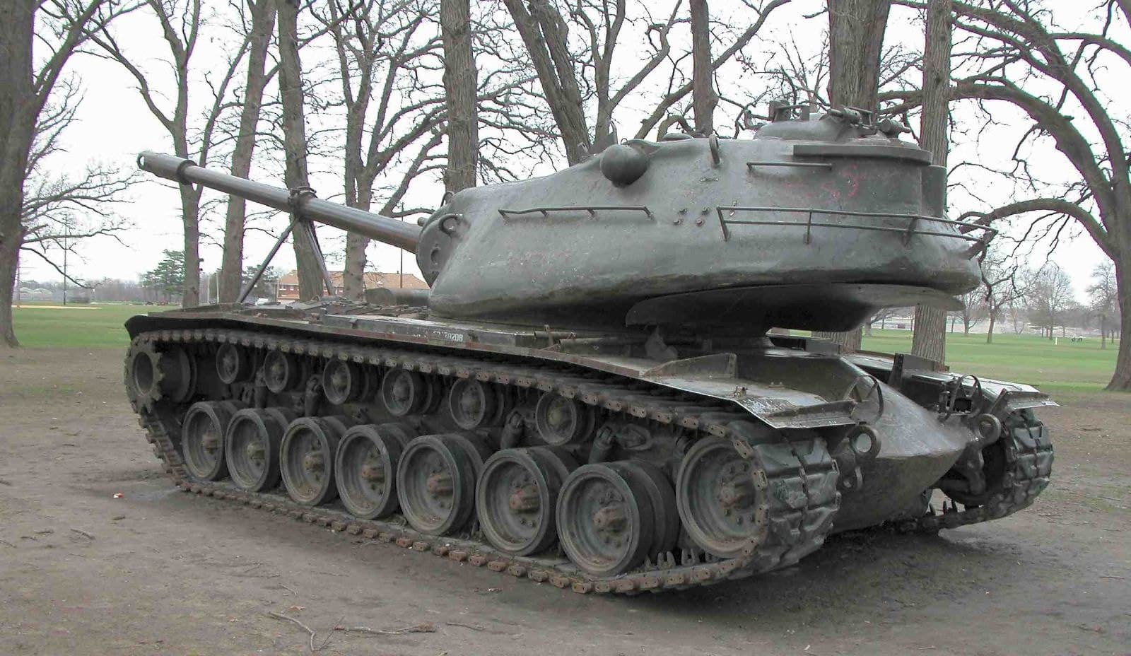

This is the Davenport T43E1

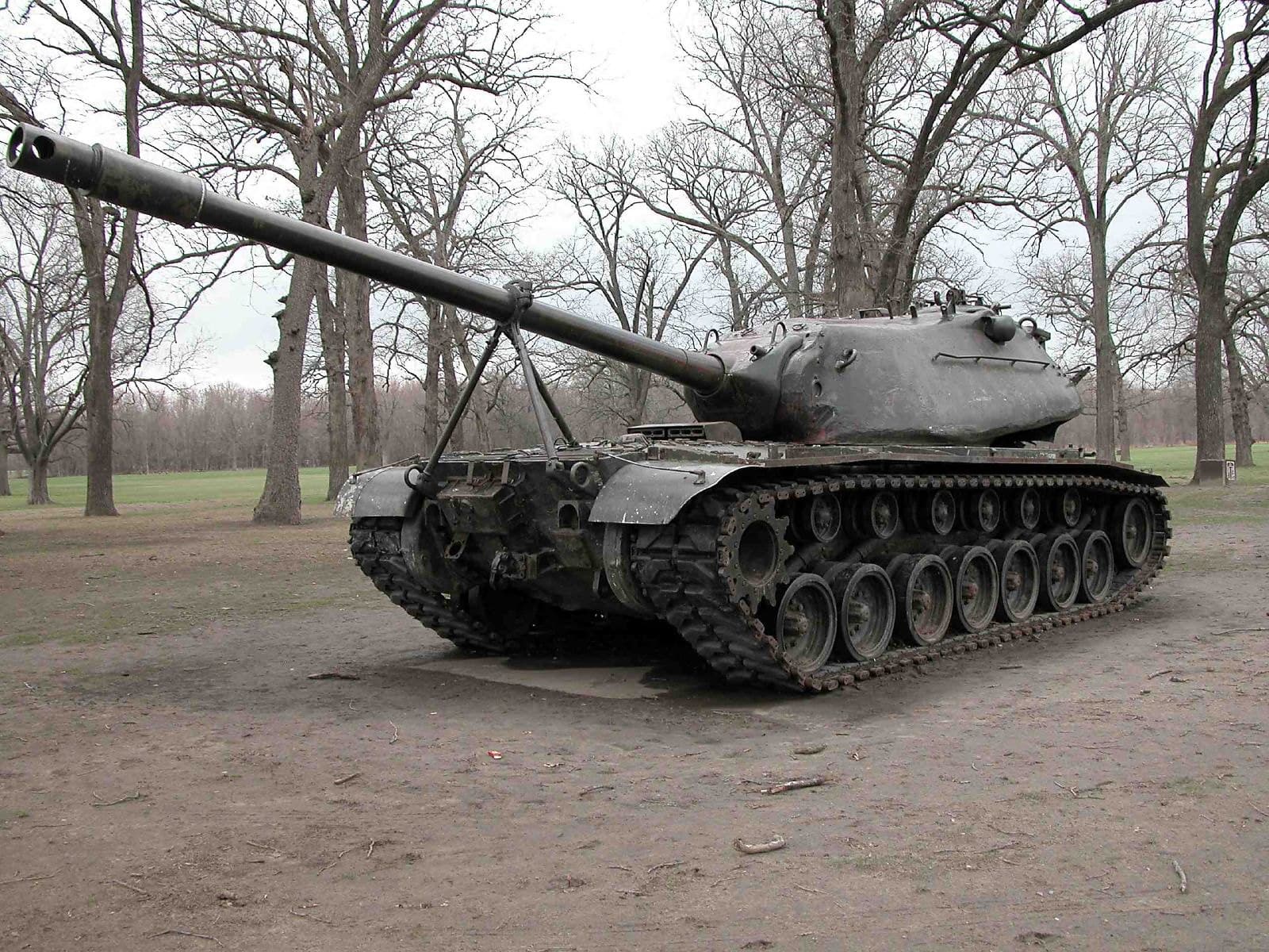

This is a walkaround of the Dowagiac one, which shows a single spring front bumper

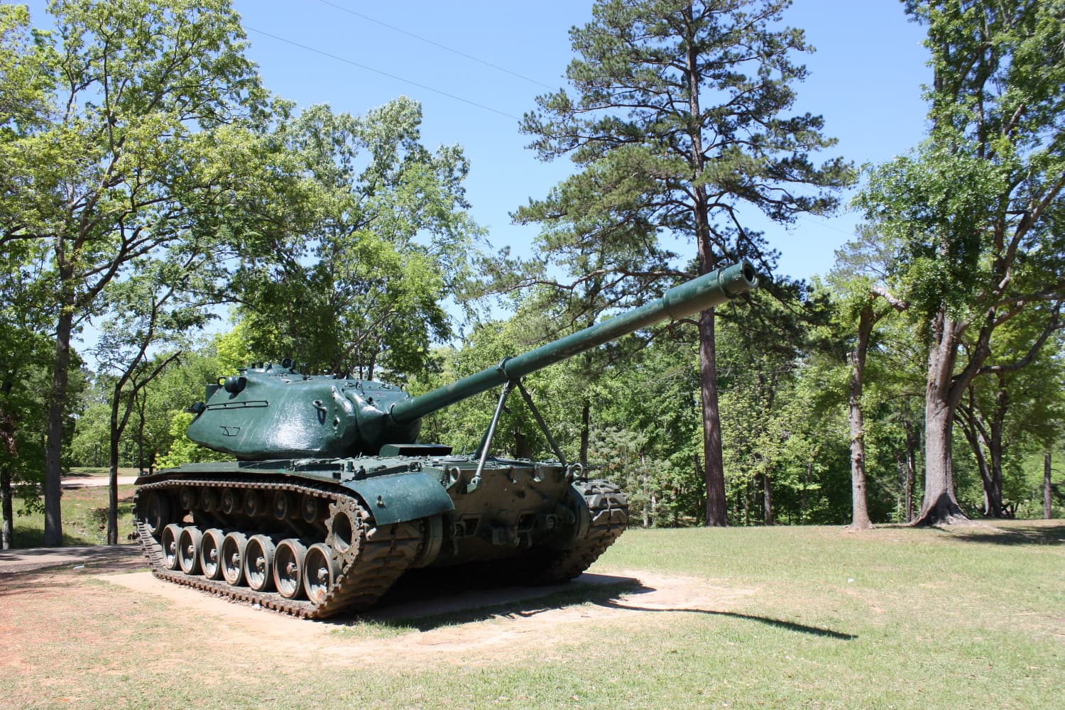

This is in Newman Park Sweetwater, TX and looks like a M103 to me and is also pretty interesting because it has the lower mounts for the barrel mount at the rear.
