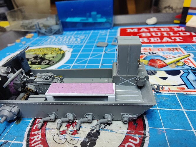

The rear seat matches up nicely with the PT drawings, Dragon’s is too small.
But Takom and Dragon gives a box for the seat to rest on-looking at a photo in the PT book, it seems to be attached to the side wall.
Now for the shelf and fuel tank that the storage locker rests on.
For some reason Takom has groves molded on the parts and I can’t find one photo of this set up.
I’ll either putty this up or add a cover over the parts with .005 sheet.
Some rod will be glued on, left to dry and sanded down and probably puttied.
Done.
Cleaned up the groves, and the fuel tank area is not glued in.

Thanks, I just realized that the fuel tank shouldn’t have a rounded edge on it. I expected better from Takom on this kit.
I’ve added a small chunk of plastic stock under the seat and probably will cover it up a bit later with gear.
Here is a 3D replacement for the kits undersized extra MG barrels.
Mounted.

The backrest/hull storage box.
Kits match the PT kit exactly and Dragon’s is quite large.
Left side wall done. The MG 50 round holder is pathetic in the kit and I found a better set in my spare parts box. The fire extinguisher is 3D, the kits is ok. The tarp supports are not in the kit.
