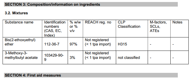

I read from this product data sheet
I did miss the acetate (3%) though, it might be these 3% that provide the styrenesolving …

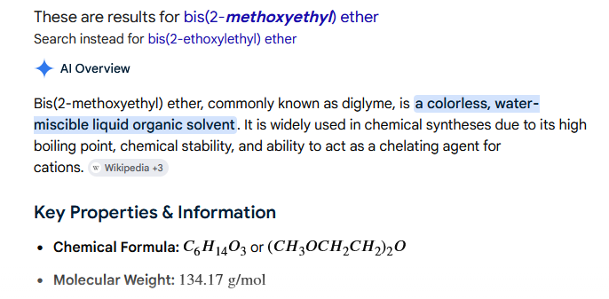

I suspect Googles farking AI which always inserts itself in all searches misdirected me to the methyl variant:
I HATE that AI but I keep forgetting to include -AI (minus AI) in my searches
