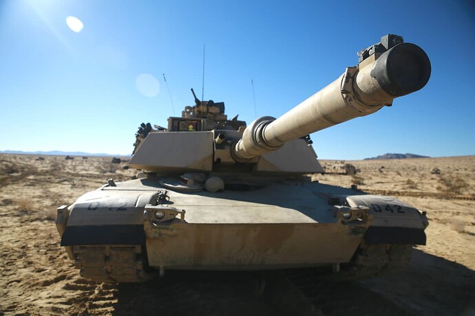

Be careful about that, the M1/M1IP and M1A1 used different sensor mountings. The 120mm uses a mount machined into the top of the muzzle which the sensor bolts onto:
The 105mm has held on using a crappy clamp system (did not work very well):
The 105mm muzzle is also visibly smaller.

I also just remembered; I have to modify the left-hand side of the hull to add the fire suppression system handle and the circular hole, which I assume is an exhaust port, right?
Its for the personnel heater.
Thanks for the heads up, Ken. I can just grind the MRS from the kit muzzle and glue the MRS I have and add some .010 strip styrene and a little rod on the bottom. even better. :smiley:

You also need to add the bilge pump outlet nozzle on the right side:
Ken
