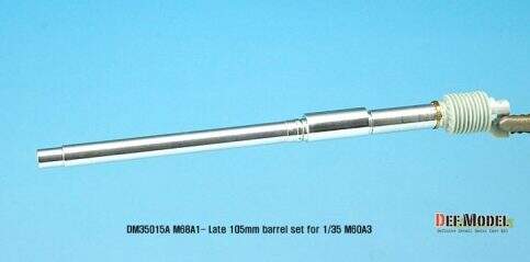

I am thinking of just using a metal 105mm thermal sleev ed barrel (I know, not the same), but i could modify it slightly, make it look as close to the original as possible.
Yup, the barrel is crooked. The DEF Late M60A3 metal barrel (minus the baffles) looks pretty close. Add a few bits and the MRS and it will look like an M1 barrel. You may still have to replace the section below the bore evac though.
That’ll work. Thanks Gino. :slight_smile:
