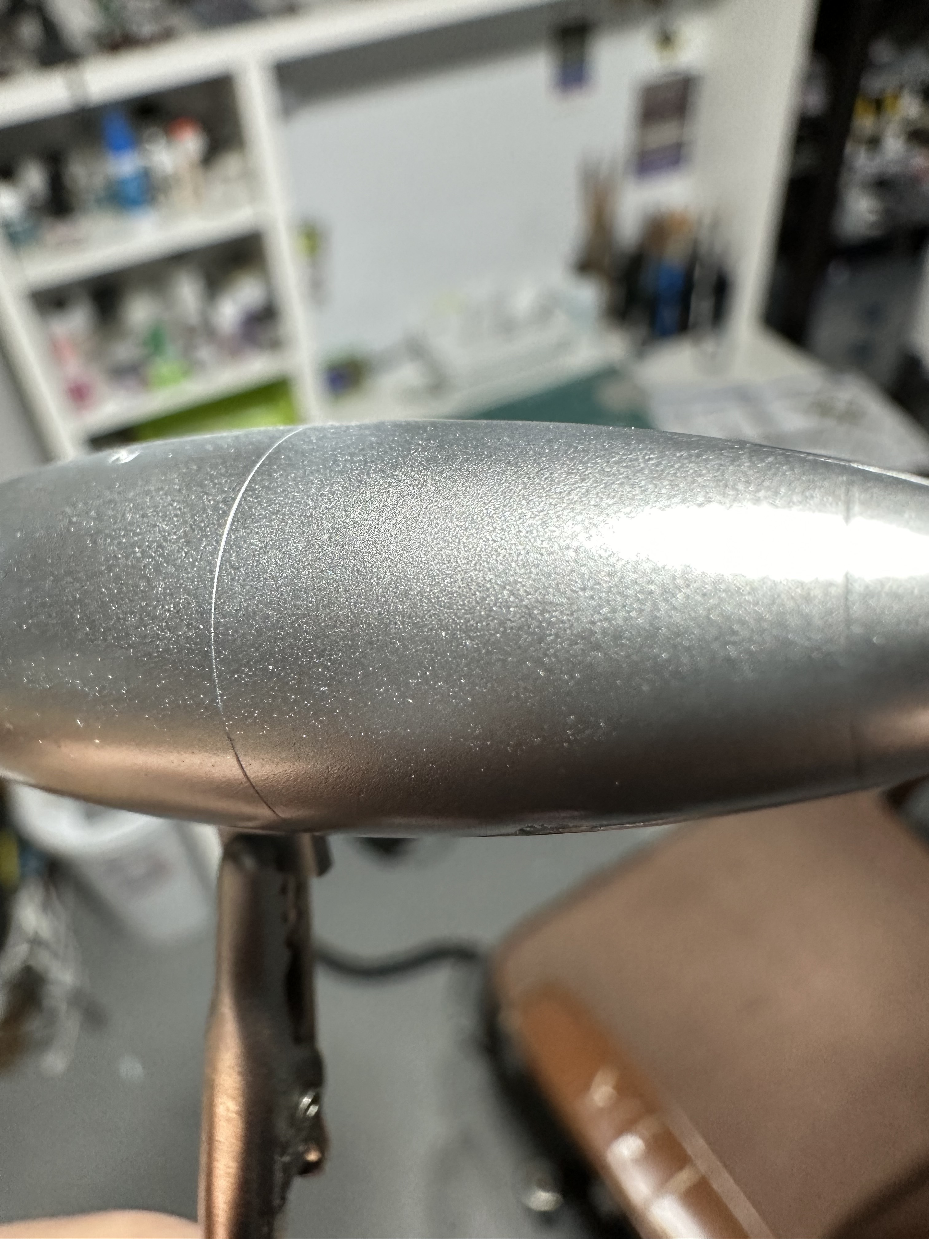

The universe told me to be flexible and figure things out. When masking to paint the large black panel it looked good, but upon removing the tape a large chunk of metallic paint came off. Seen here are my attempts to cover it up. Will have to go nuclear on the nose cone. Next time will put gloss coat down before masking red and black to play it safe. There initially wasn’t any red overspray I just knew all hope was lost and started free handing for fun.
Nuclear option:

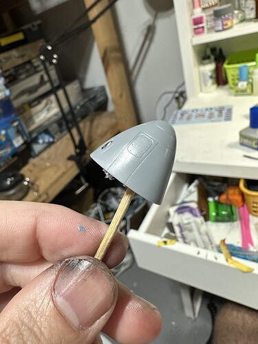

Thought: what if I mask off the gun panels now so they stay black instead of painting the whole thing silver like I did the first go? How would I mask these tricky shapes? Part of me is thinking to surround one panel with tape and the. Use that as like a cookie cutter template to make four ovals.
Tried cutting tape into a mask didn’t look good. Now will see about masking fluid, but so far it’s pulling away from the edge. May just paint the metallic and hand paint the black.
Holy micro mask. Just a little bit of surface tension made this easier than I thought.
