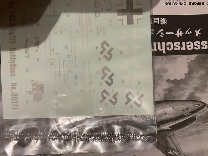

Is this a law where you live? Often like on the Me-262 I bought the swastika is in two pieces on the decal sheet and on the box art it’s just a square

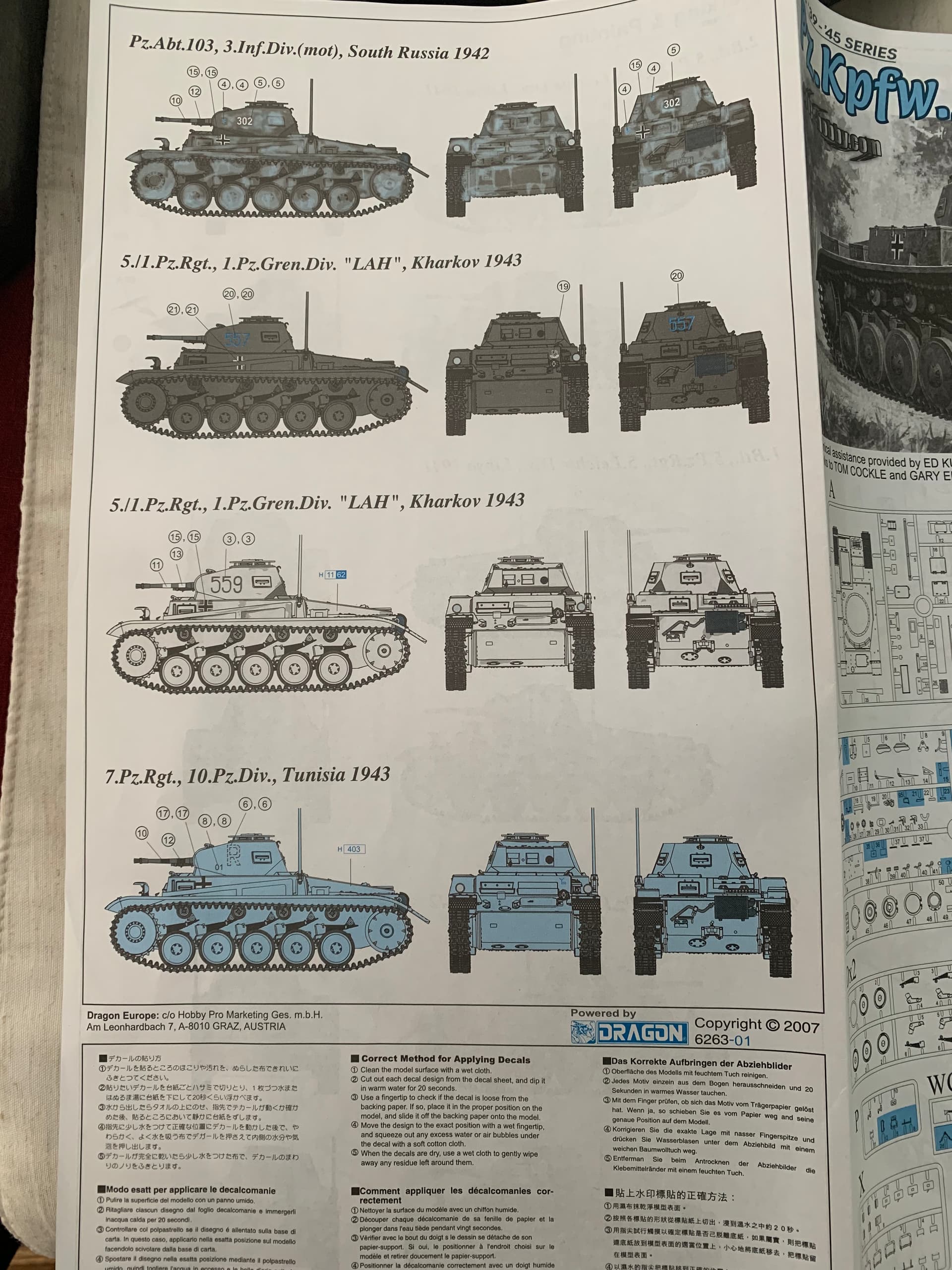

Here is the marking guide from Dragons Pz II F if that helps?
None of the Africa ones appear to have a bin

Was the DAK palm tree common on panzer II? None of the Africa variants in the dragon kit have the palm tree and the decal sheet doesn’t include it. Wonder if it wasn’t as common on early DAK vehicles or if dragon got political too

Here is how hobby boss gets around it.
The black diamond should be a swastika, I think it is illegal in Germany if I am not mistaken to sell the swastika so a lot of companies have resorted to the two piece one to get around it
