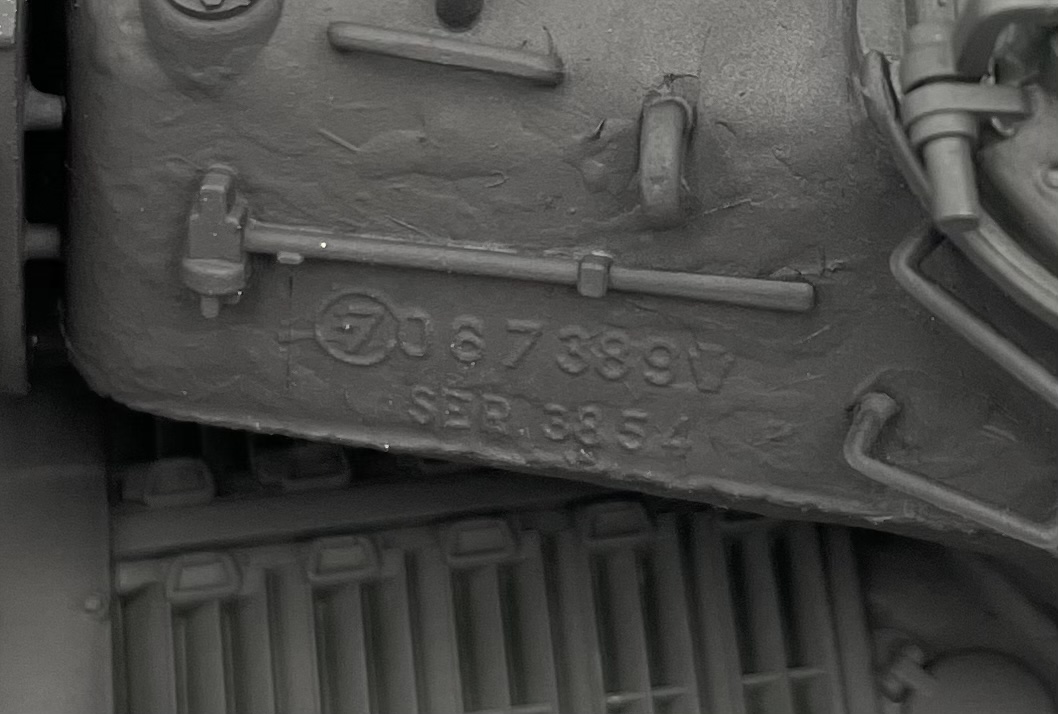

And this one at Ft. Hunter Liggett:

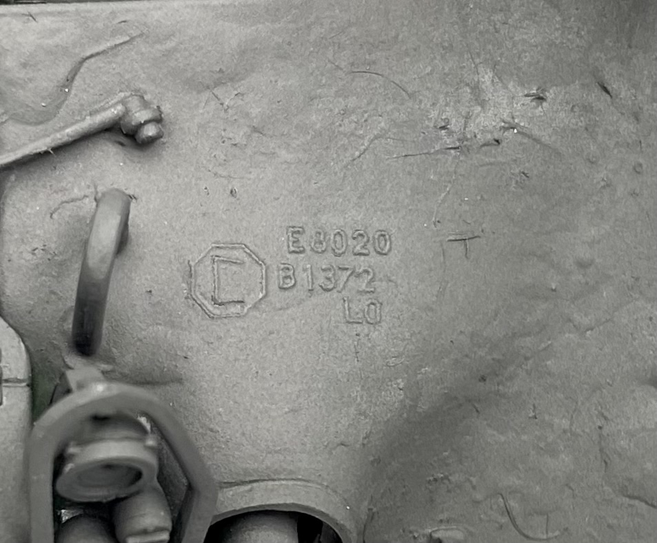

Monday and back in action with this one. I added some Archer raised resin decals casting marks to the turret and hull. We shall see how they look under a coat of paint soon.
Yeah, these are for a Sherman, but most likely only a M47 fanatic would know that they are not proper for a Patton

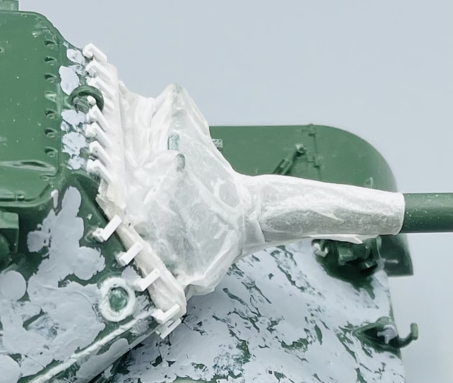

I found one more casting mark in some photos over the bow gunners position, so I added another casting mark decal. Some tanks had ‘em, some didn’t. But I figured why not for mine. And then later I created the dust cover for the mantlet using white glue and tissue paper.
So next I have to come up with all the little clamps that hold the dust cover in place around the edges…

Thanks guys. I’m gonna try some strip styrene and see how that works for the clamps.

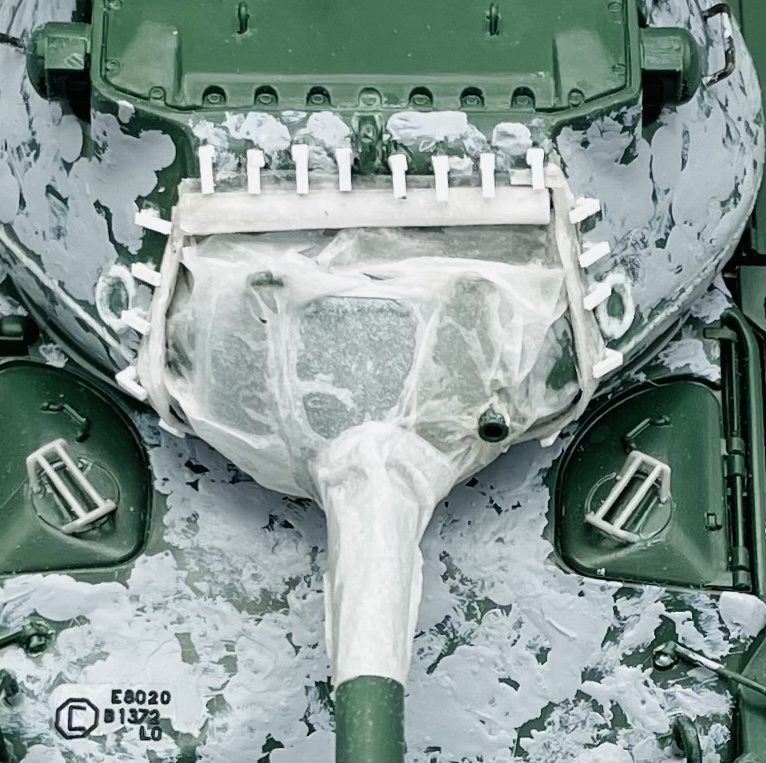

Yesterday I finally got around to making the brackets to hold down the mantlet dust cover
Almost ready for paint now. I just need to add a couple of things first.
Looks great Carlos!
Thanks Richard. Once it’s all under paint it should look the part. I am so ready to get this one finished.
