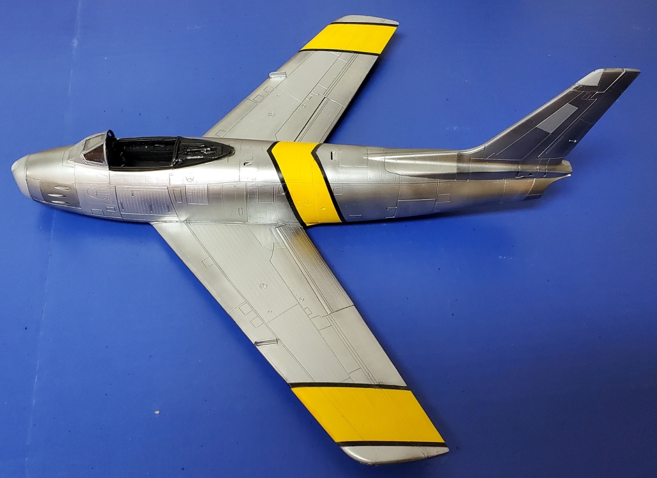

I am working on a Kinetic 1/32 F-86 I rescued from the Shelf of Doom. I’ve actually gotten to the decal stage and was putting on the yellow/black fuselage stripe when guess what: it shattered. Damn.

I spent yesterday afternoon masking the heck out of things and am going to try to paint them on. I have a bad habit of laying on the white too thick, and will try to avoid that this time, but painting it over bare metal is not something I’m looking forward to.
Michael :israel: :confounded:
Bare-Metal foil? Wipe it down with 90% isopropyl or ethyl alcohol (Everclear™) before painting. Don’t soak the surface. If this is going on thicker metal, sanding the surface with 2000-2500 grit or finer, and clean it before painting. I’ve never tried to sand Bare-Metal foil. Good luck!
I’m using Alclad, and it actually went pretty well. The big problem was that I used the wrong shade of yellow at first. But it’s easier to paint yellow over yellow, so that’s fixed. Getting ready to mask off for the black now. And then… fixing the overspray areas. Sigh.

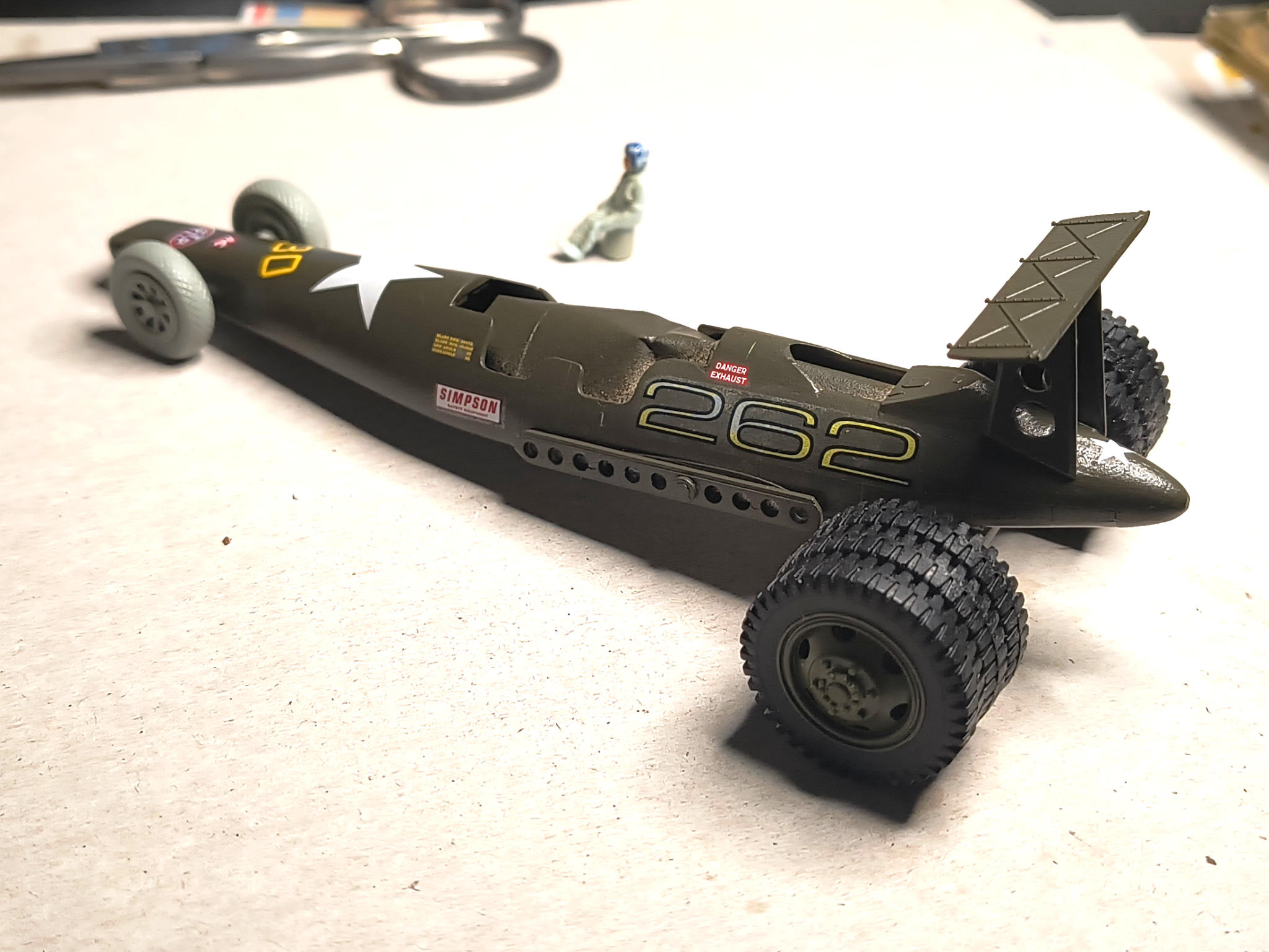

I have tryed the very nice Vallejo glossy PU varnish as base and coating for my decals , that went very easy with the brush and additional GLAZE and thinner.
The self designed 262 decals ( printed by decalprint in germany ) got a small damage at the yellow color from MIG decal fix .

For those interested in the outcome of my little issue, here it is:
Stipes painted on in (close to) the right shade of yellow and overspray areas touched up. Now, hopefully, back to trying to decal it. Thanks for the ideas and support!
