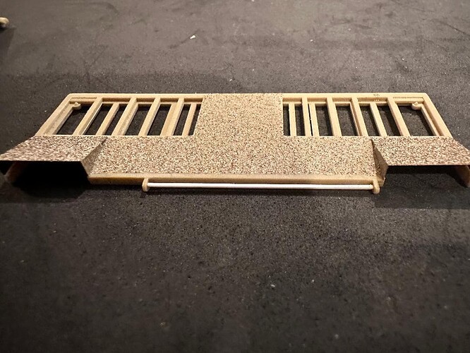

I worked on the trim vane, I drilled the little holes in it and replaced the torsion bar with square profile Evergreen. Still needs a few bolt heads here and there.
Most of the holes are partially obscured by the torsion bar. Yes, they should be off center - a little lower than the centerline.

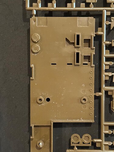

Now is as good a time to mention the difference in the kits. Some say the Tamiya kit is better. I’m here to tell you, looking at both kits side by side, they’re the same. The only difference quality wise is that the knock out circles are a little deeper on some of the Academy parts. You have to fix them on either kit anyway so no big deal.
Because a pantograph was used to make the Academy molds you would expect them to be identical, but they’re not. Underneath the floor of the interior is a row of rings. The rings are slightly larger on the Academy kit - probably so they can point to them and say, “See, we didn’t copy the kit, these are different.” They’re not visible when the kit is built. So why are the rings even there?
Well, that’s one of the things Tamiya left off of the kit - the small circular rings welded to the hull. These were pockets for some of the supports for the swim barrier. My theory (and I’ve never seen anyone mention this ever, so I could be wrong) is that the rings underneath the floor were meant to be shaved off and added to the hull. Tamiya’s design engineers forgot to tell the art department this, so it never showed up in the instructions,. I’m certain that’s why they’re there, and I use them as such. They’re just the right size, are there are almost exactly enough to do the job. Academy didn’t know why they were there, but chose to make them a tad larger.

Interesting, never noticed the rings, but they could possibly work for the fording screen mounts, but they would still be missing quite a bit of the other doodads that go with it :thinking:
I assume you used sliced sections of aluminum or brass tubing. That’s what I used to do before I discovered the rings.
Sliced styrene rod, glued down then drilled out
