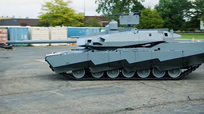

General Dynamics Land Systems AbramsX technology demonstrator with 30mm remote weapon station chaingun on top, remote turret, autoloader, three crew in the hull, 360-degree “see through armor” camera system, hybrid-electric engine, and lightweight 120mm cannon.
Hybrid-Electric engine - Dr. Porsche wasn’t wrong after all.
It saves 50% more fuel for the same range as the M1A2 and has “Silent Watch.” GDLS didn’t confirm if the range is the same or thus doubled.
Locomotives use this system for decades.
Porsche stole the idea from G.M. who introduced it in the early 1930’s. he couldn’t make it work.
gary
the power packs are already going thru the 25,000 hour test on the dynos. I’m hearing fuel usage is roughly 60% of what it was before. There may well be a second power pack developed for the same hull. It’s primary use is for extreme cold weather.
gary
I wondered about that. I guess this would because battery performance is diminished in extreme cold.
today’s battery packs are heated and also cooled, and that will go a long way in performance. The power pack used in a city transit buss will get the job done well, and come in at about one fourth the cost with about a 20% loss in performance due to the way the gear box works (they can get around this pretty easy). I’ve heard that they are looking at another much smaller gas turbine in combination with the electric drive. Hear that Roll Royce and Garrett are the interested parties, and the turbines are right out off the shelf military issue. Roughly 1200hp. and less than half the size of the Lycoming used in the Abrams tank. Thing is they will be much cheaper than the other one. Advantage is an instant light up at a minus forty degrees, and a virtually flat torque curve (ideal for the charging circuit). To this very day the best diesel engine for a hybrid circuit ever found is the old Cummins used in a Dodge pick up truck (they’ve played with hundreds of different engines over time, but this one has the right power curve). There is yet two other combos that would work, but also little interest in them right now.
I still think the auto loader will be dumped sooner than later as a human is much more reliable at loading the main gun, and lessons learned in the Ukraine have also shown us why. I also see the 120mm gun going away sooner than most would think, as the new power supply will lead you into better things. I also can see the advantage of the 30mm cannon, but still think they are better off with a couple good old 30 caliber machine guns for people
gary

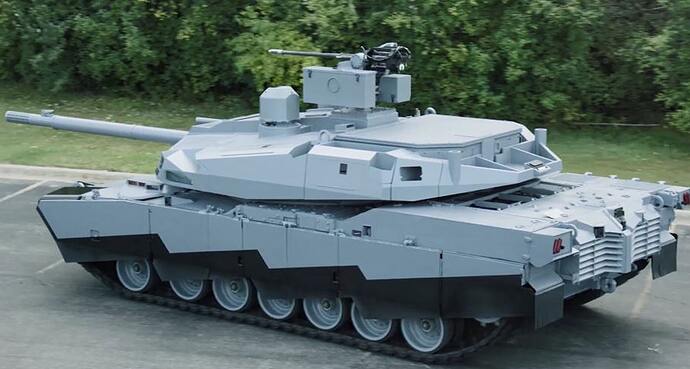

I think that the AbramsX hull will be vitally important.
If the US Army accepts the AbramsX, having three crew in the hull can produce a wide range of AFVs besides a MBT if GDLS removes the turret such as Air Defense missile carrier, radar, 155mm unmanned turret howitzer, unmanned turret mortar, loitering munition carrier and launcher, drone carrier and launcher, microwave zapper, engineering and bridging unit, C5ISR, and maybe even an APC variant with the door out the rear like the IDF Namer. One can even place Hellfire Extended Range or JQL/JAGM VLS cells in the turret basket space for a bank of missile launchers out to 16 miles (25 KM).
Minor correction, I think you mean Achzarit not Namer; achzarit has engine turned 90 degrees at the rear, with a personnel tunnel exiting to the rear. Namer has the engine to the front and personnel exiting via door to the rear. I like the idea of an HAPC based on the M1 hull and wonder what that would look like.
