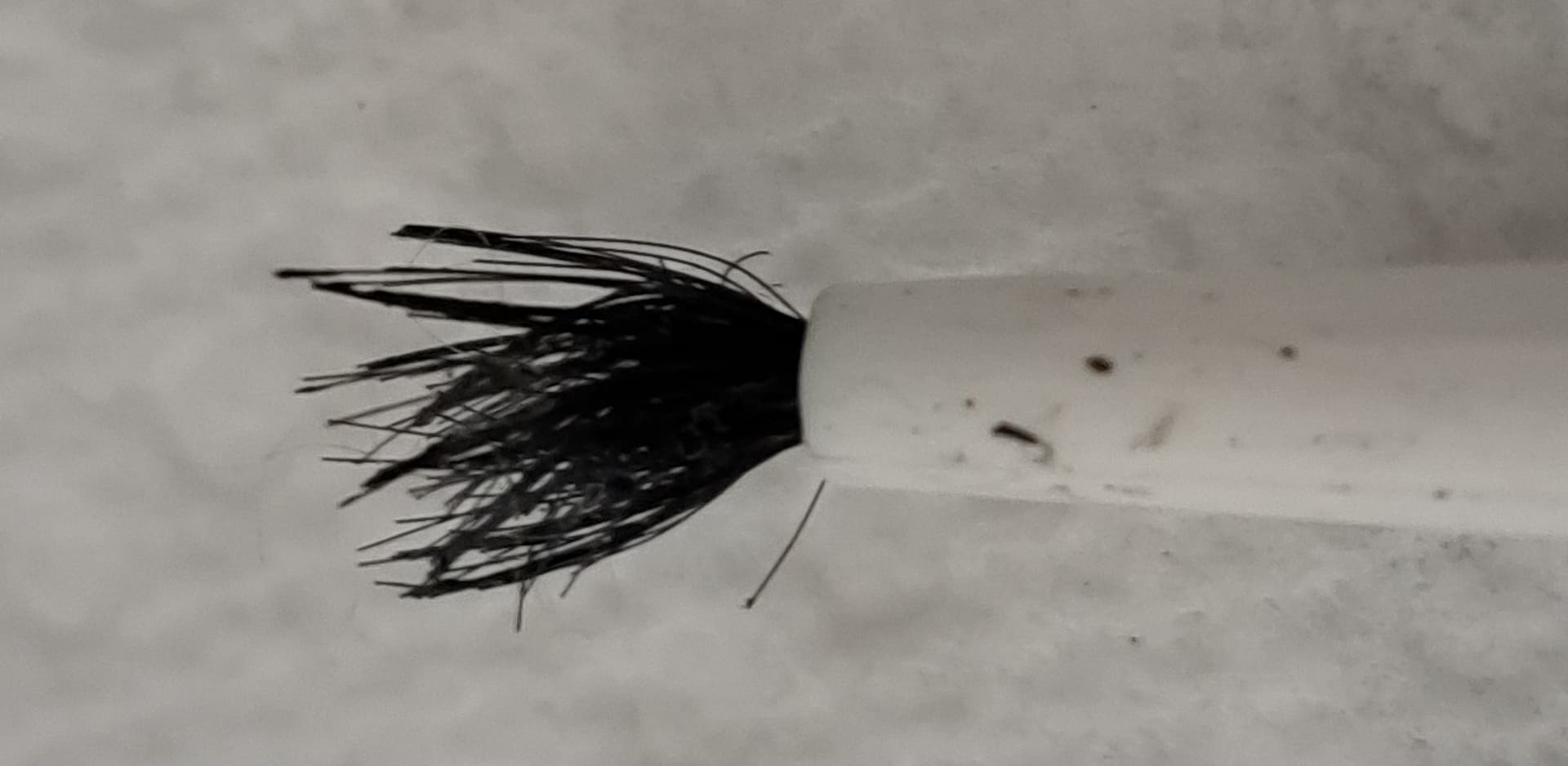

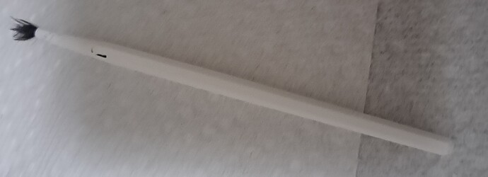

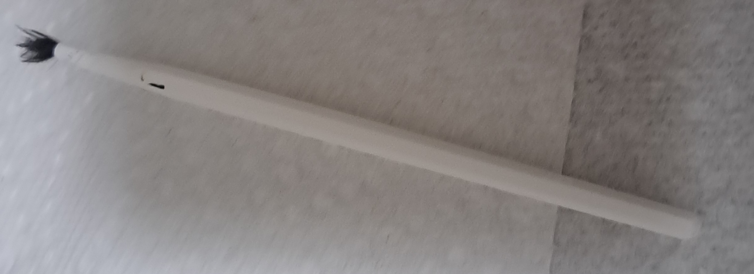

The Pz III was stippled with this…
…a chopped .50 cent Testor’s nylon paint brush…also perfect ego checker.

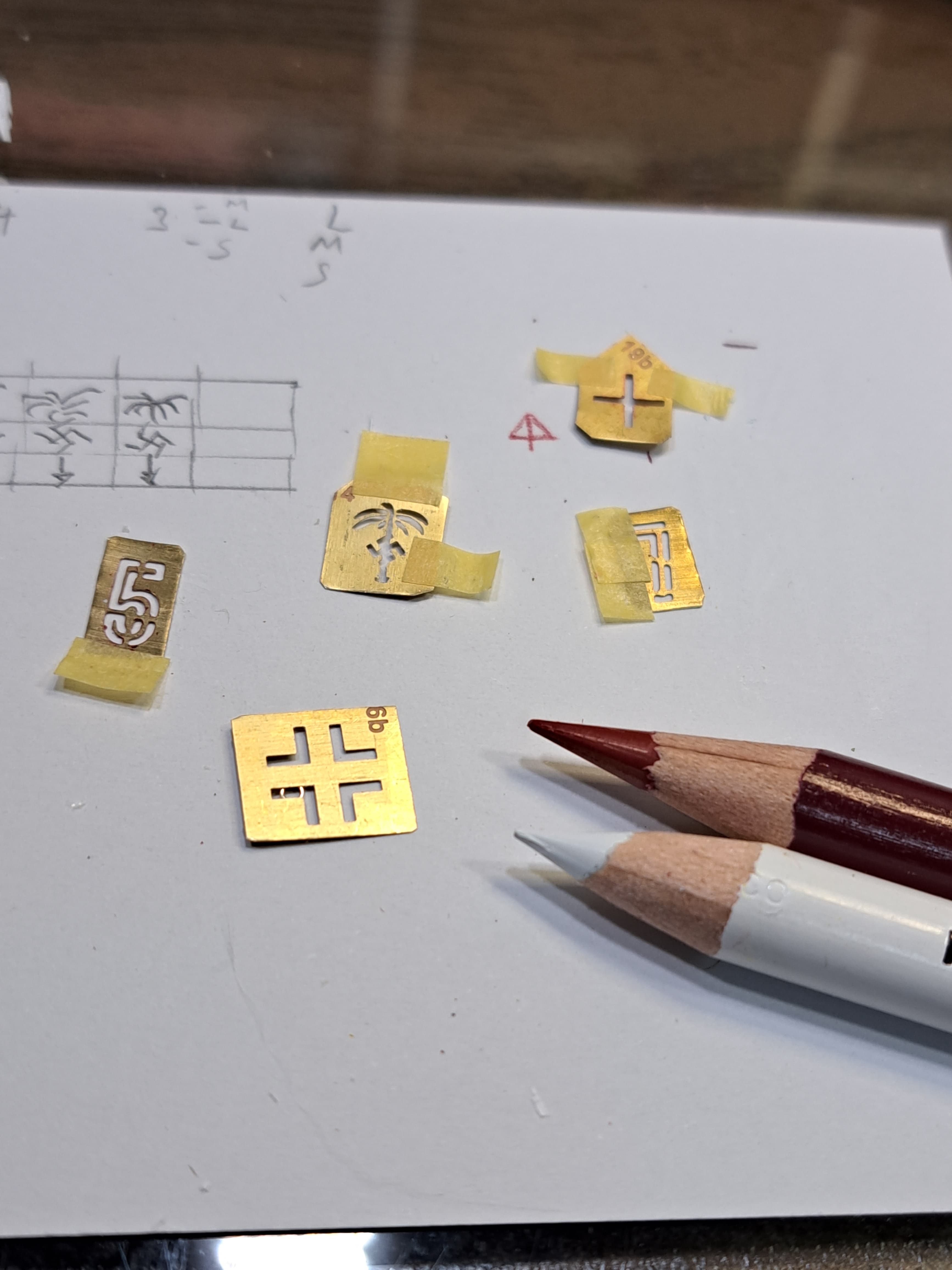

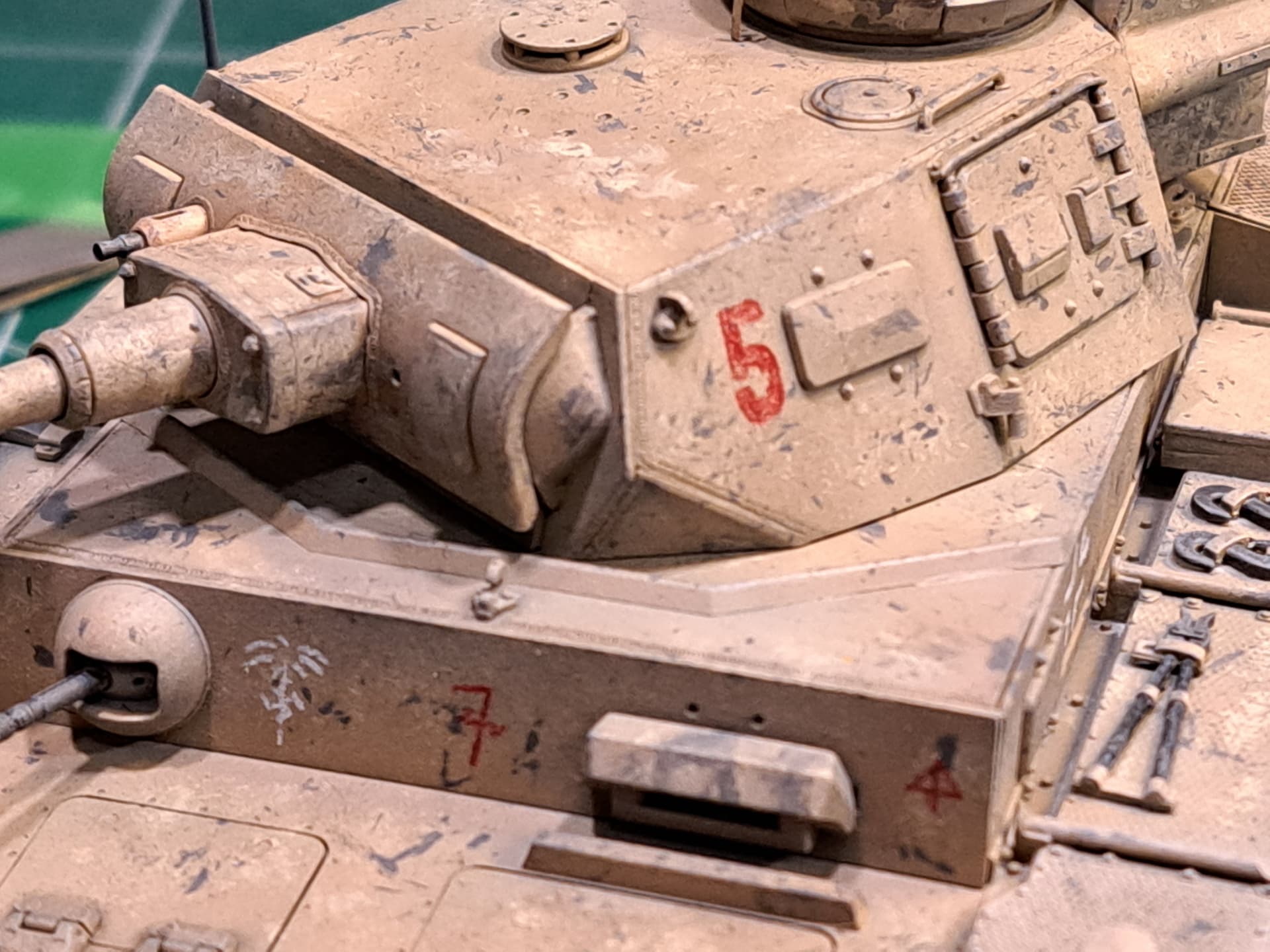

Worked on the markings and the Academy Pz III Ausf J edged closer to the finish line today.
Tested on scrap and discovered while the white & yellow pencils will wash off with water and little hassle, that isn’t true for the red pencil. It left a noticeable pink :heartpulse: stain. With five of nine of markings in red, practiced a fair amount on paper before applying to model.

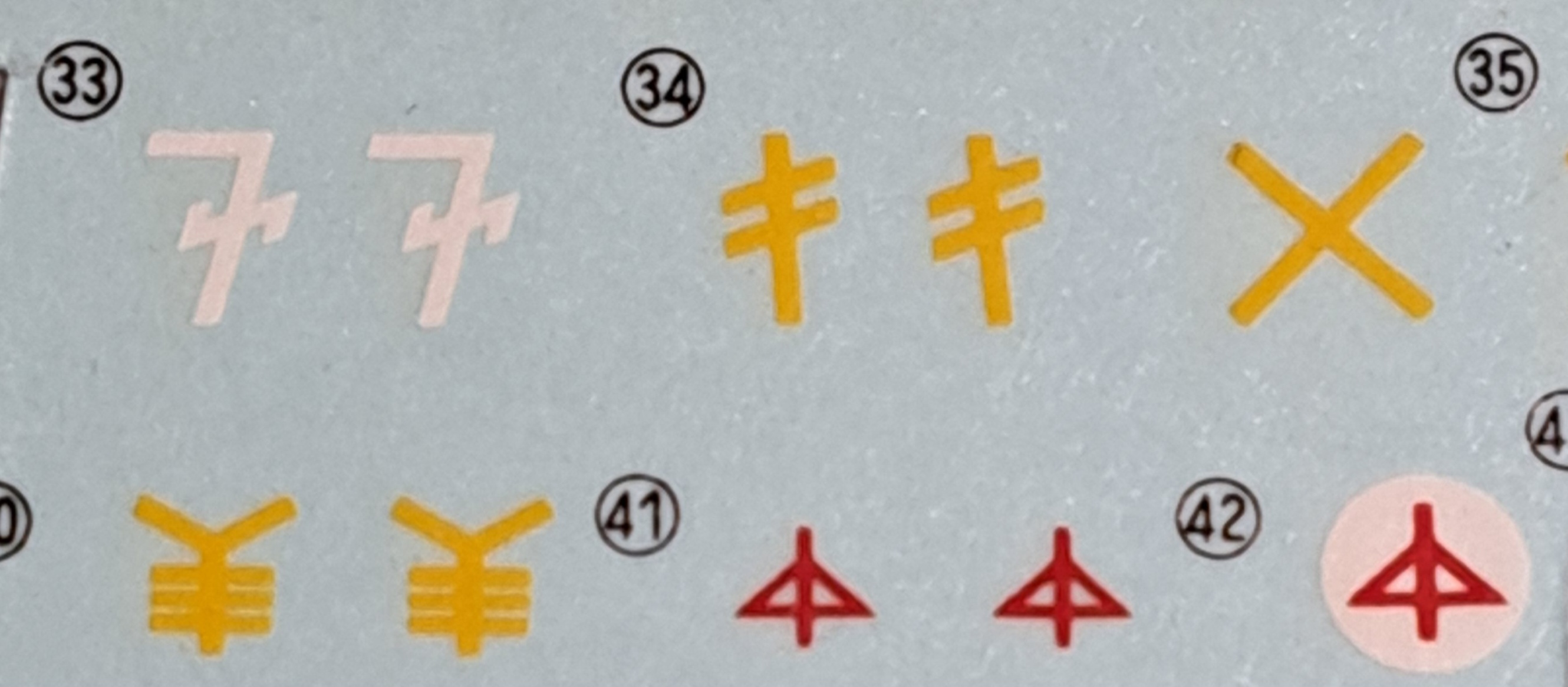

The 15th Panzer Division had it’s own version of a wolfsangel that was applied to some tanks. Tamiya hasxa decal sheet with the symbol #33. Also number 41 & 42 are the 15th PD’s division symbol.
While I can’t find the photo at the moment I recall seeing one 15th PD Panzer with a red or black wolfsangel so the Tamiya wasn’t what I wanted on this model.

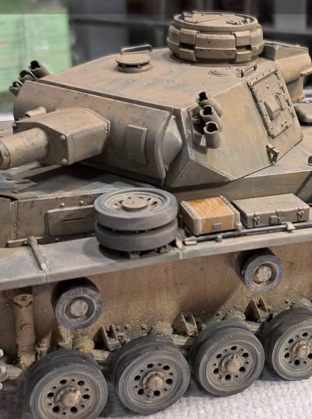

Decided for better or worse, increase the suspension weathering otherwise this Pz III will just look like the other one above. Both are 15th Panzer Division, so I want to try to get some distinction.

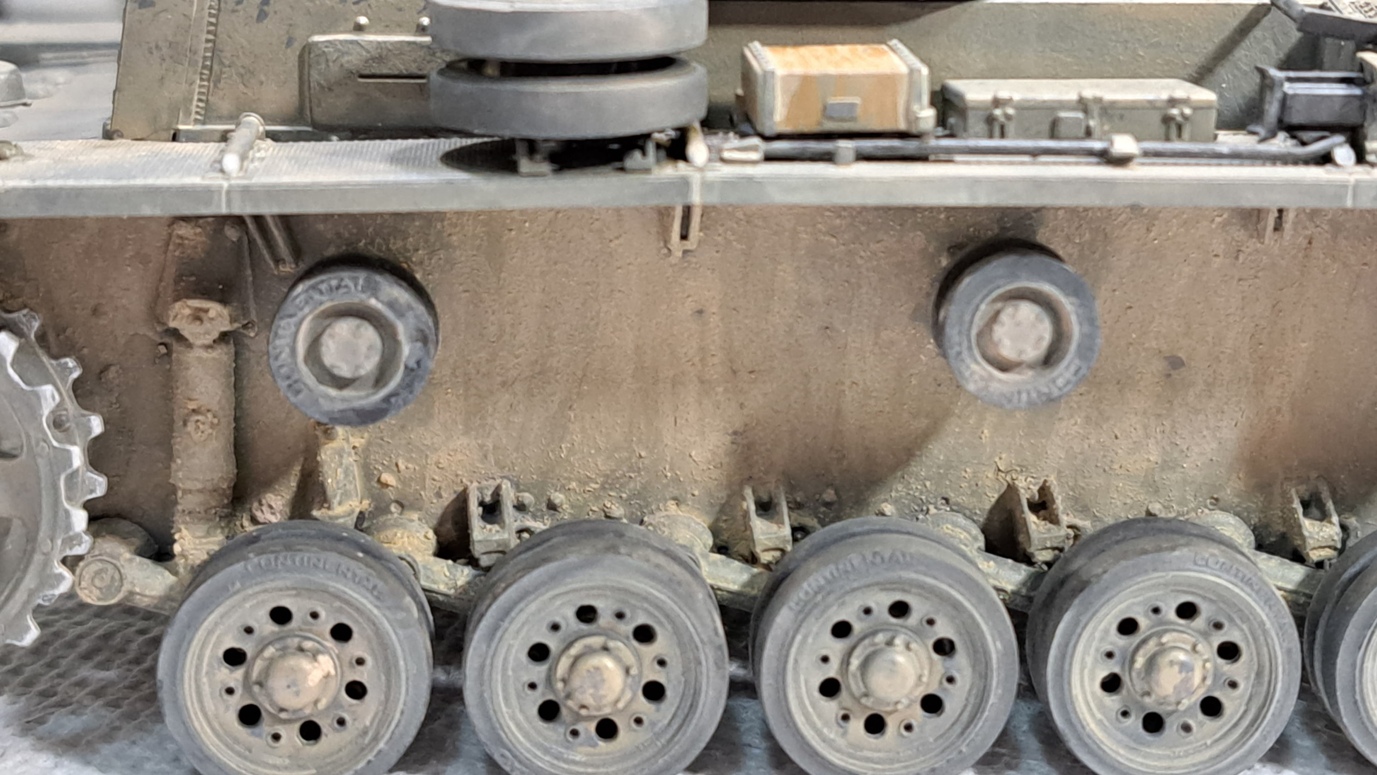

Going very much against my inclination, applied MiG’s Sand mud paste to suspension, a dust wash and a little mix of MiG pigments :pig2: :pig:
After applying wash.
Needs to cure overnight.
Good call Wade. Fantastic effect, impressive results.
Matt, thank you very much. It’s interesting to try a few new (to me) techniques and revise a couple of old one.

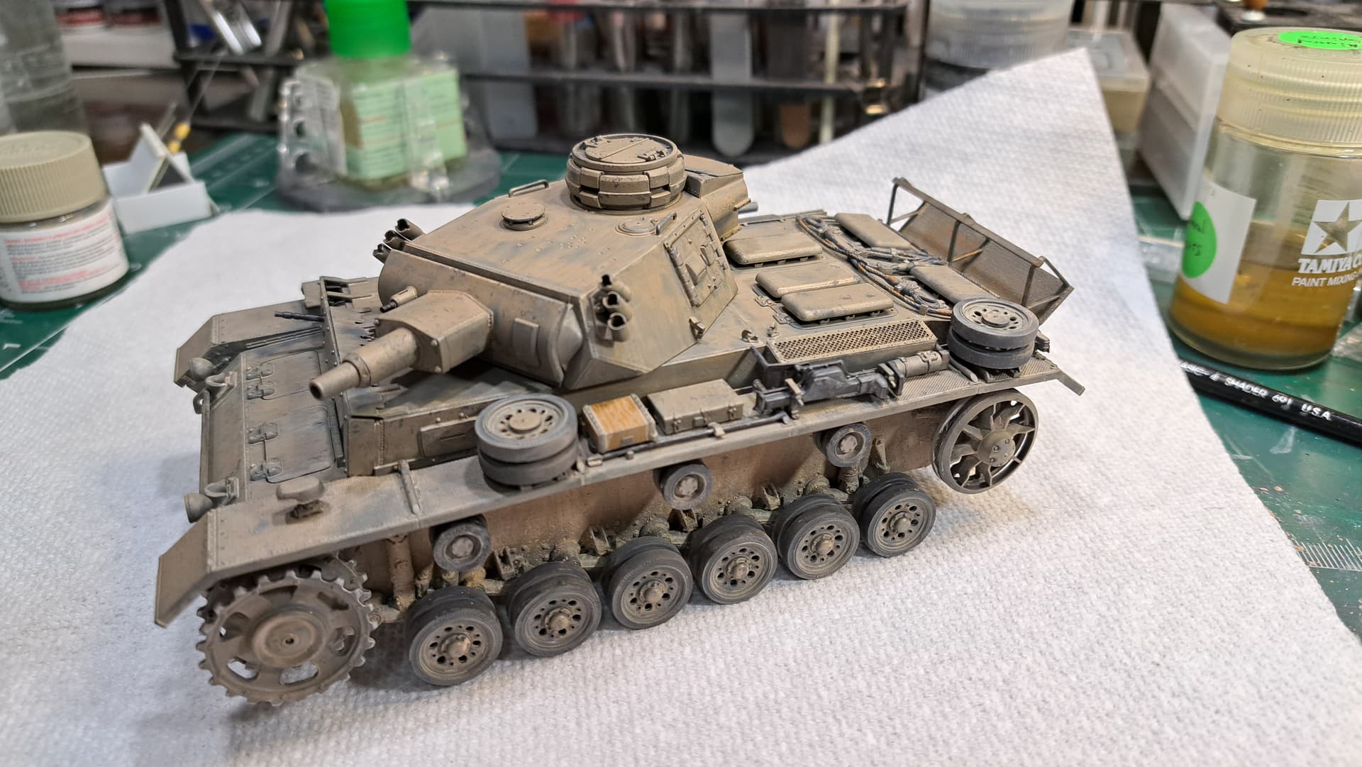

Had a minor mishap breaking one of the tracks. I pulled one run too hard and tight and broke several plastic pins in the RFM Pz III/IV tracks. Solid reminder that 3D printed or plastic neither are as robust as a set of Fruilmodel’s or Sector35 or other metal & wire track.
Anyway repaired the issue and installed tracks today.
What Matt said, and more. Further proof right here that (as far as I’m concerned) Youda Man for AFV painting/weathering. You do your research diligently, you really, really, really look at the visual references, and you replicate what you see so accurately. Seriously, you keep on hitting bullseyes and few (not including me) get anywhere close to your overall effects.
So, now that your head’s too big to get out the door, some rectifying pickiness: in the 2nd of your 3 latest images, the front plate with bolts – there’s a sliver of a gap along the top that starts just right of the MG, fixable. Also, the track from the rearmost roller to the rear wheel looks too straight compared to your reference photo, any chance of sagging it a tad? By all means ignore all of that, because otherwise it would be perfect - and that’s just not allowed :wink:
Thank you, Tim. I appreciate the kind comments on the paint but I value your excellent constructive criticism even more.
That’s a good catch on the front plate & PE cover, looking top down usually at the model, I completely missed it. :flushed: :face_with_peeking_eye: :face_holding_back_tears: :flushed: Will attempt to fix.
The Chieftain might say, “Oh Bugger! The tracks are too tight.” Agreed. I broke five links replacing one that sheared its pins earlier. Afraid to risk adding the needed extra link to each. I probably should accept my screw up…but what sort of xPanzer Police would I be letting my goof :crazy_face: slide?
Stay tuned, will see what can be tweaked. :blush:
Tweaked track and working on plate.

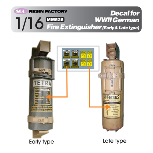

Decided to add a fire extinguisher decal. Used this as guideline.
53c34851975ab56077625cc44cd79121
Discovered my Tetra dry transfer marking for the early style was too big to fit the kit supplied fire extinguisher.
Anyway, the later style marking fit. I think it’s wrong but close enough to be sort of in the ballpark.
