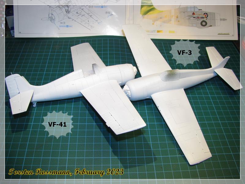

Here comes what not only Dragos is waiting for. Paint! Finally! First it was primer all over …

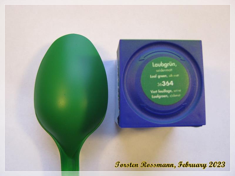

… the rudder of VF-41 is painted with Revell 364 Leaf Green, which I think comes close. The RAL tone is 6001, which is named Emerald Green …

Thanks for your feedback, Joel and Peter! I have used the same white primer as on the rest of the models, which you can see in Post 667. Usually I also go from light to dark colours but Red is more difficult to paint/spray than White, so I decided to go the opposite way. Sometimes I do this what is sometimes also called “reverse mottling”. I did this years ago on my first Hasegawa Ki-45 and on the Italeri Macchi C 200. They both have sharp mottling edges, which is correct for the Ki-45 but not so for the C 200. But as I said, the paint repairs on the rudder look only - well - not so well done on these macro shots. Wait until you see the finished model … :wink:
