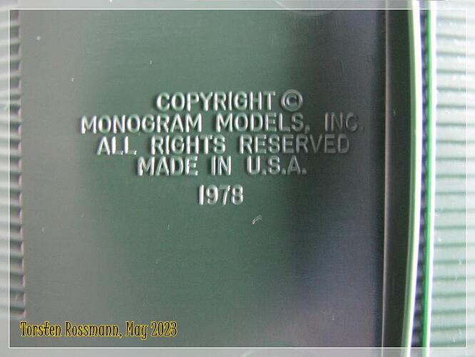

… inside the wings I found this … :blush:
… there’s another marking on the outside which I will sand off …

ooo… 1978 and raised panel lines!
