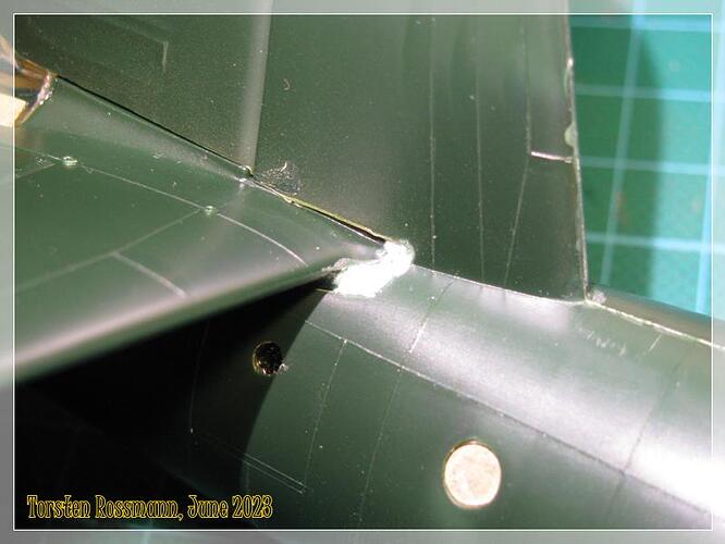

Test fitting of the elevators already showed big gaps, especially on the right side … :worried:
… on the left side it looks a little better …
I will use some putty and see how it comes out. At least the masks for the canopy and tail turret fit quite well …

I have filled the gaps on both sides of the elevator and surprisingly it went so well that I decided no sanding is needed here, also not to destroy the panel lines. Though it looks worse on this macro photo than in real … :blush:
