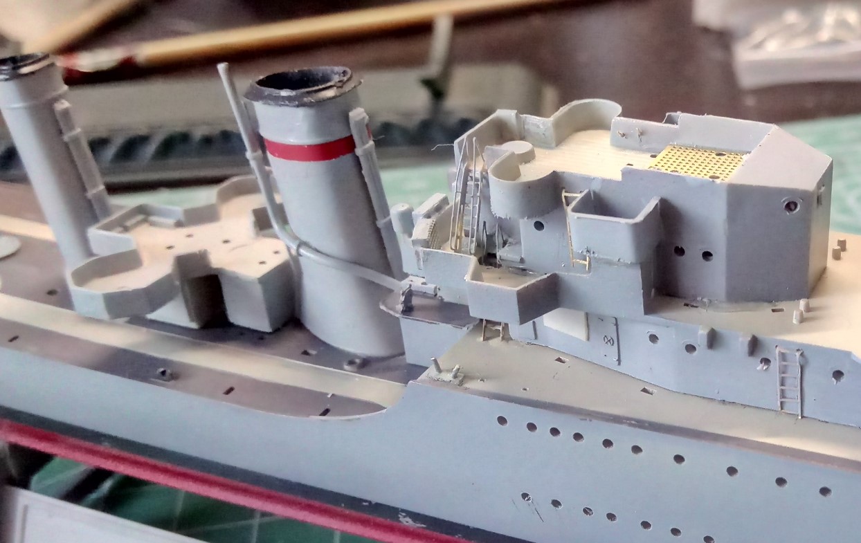

Slowly moving forward. Installed the funnel and added 2 steampipes at the aft end of the forward funnel.
The deckhouses between the funnels are quite wrong. There is one bigger one under the middle of the platforms. This is housing boiler room fans and an entrance door to the boiler rooms. Forward of this is a smaller room aft an empty space whe a manual pump is standing
Under the bridge I added the searchlight platfoms. The structure under it is closed at the forward side to offer wind protection the doors into the superstruture and probably the signaldeck.
At the aft end of signal deck you can see the flag lockers.

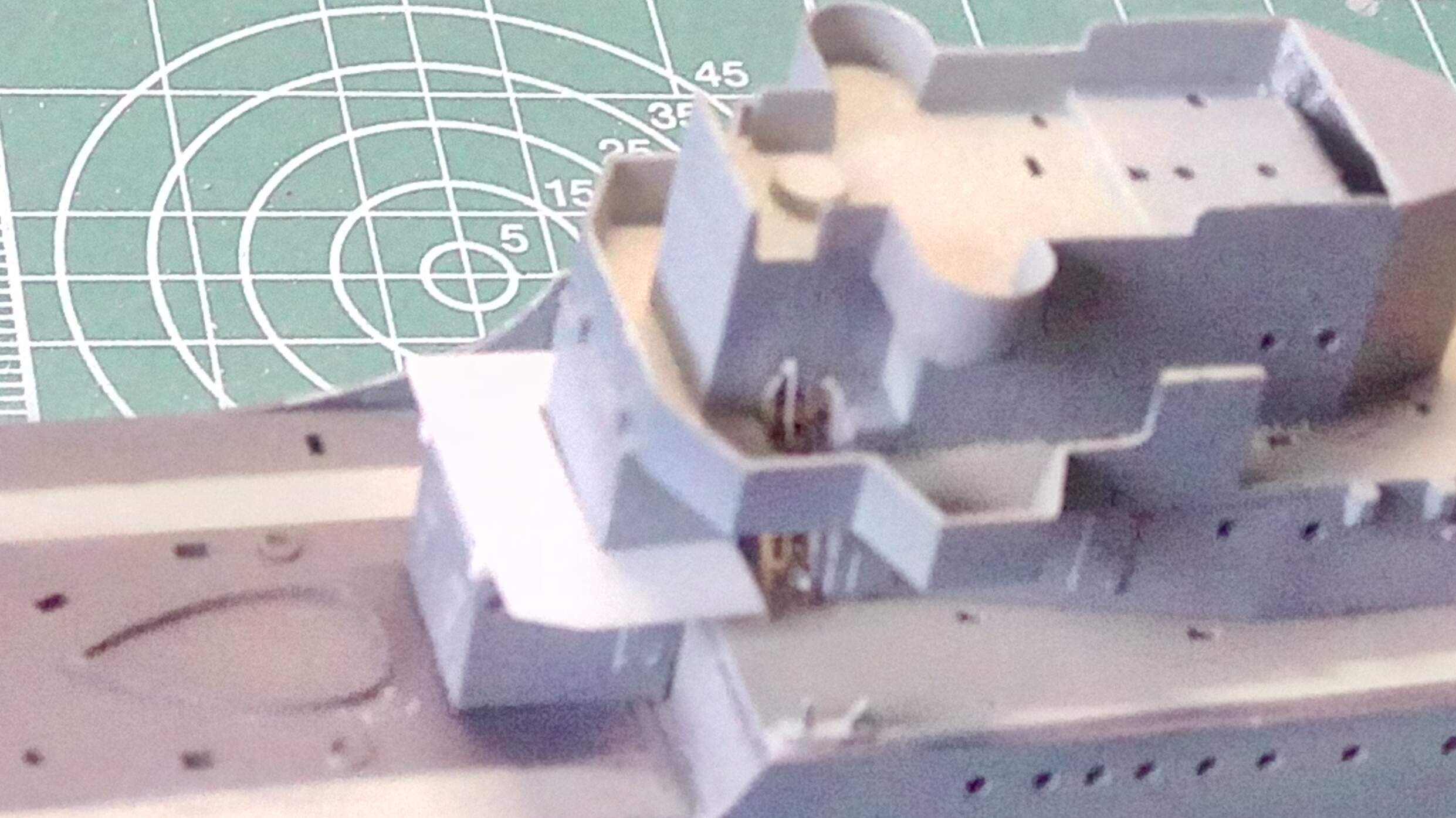

Bridge stairs and ladders installed (spares). I opened the bridge under the sloped part because there are a window to the chart table and some instruments, not a wall.

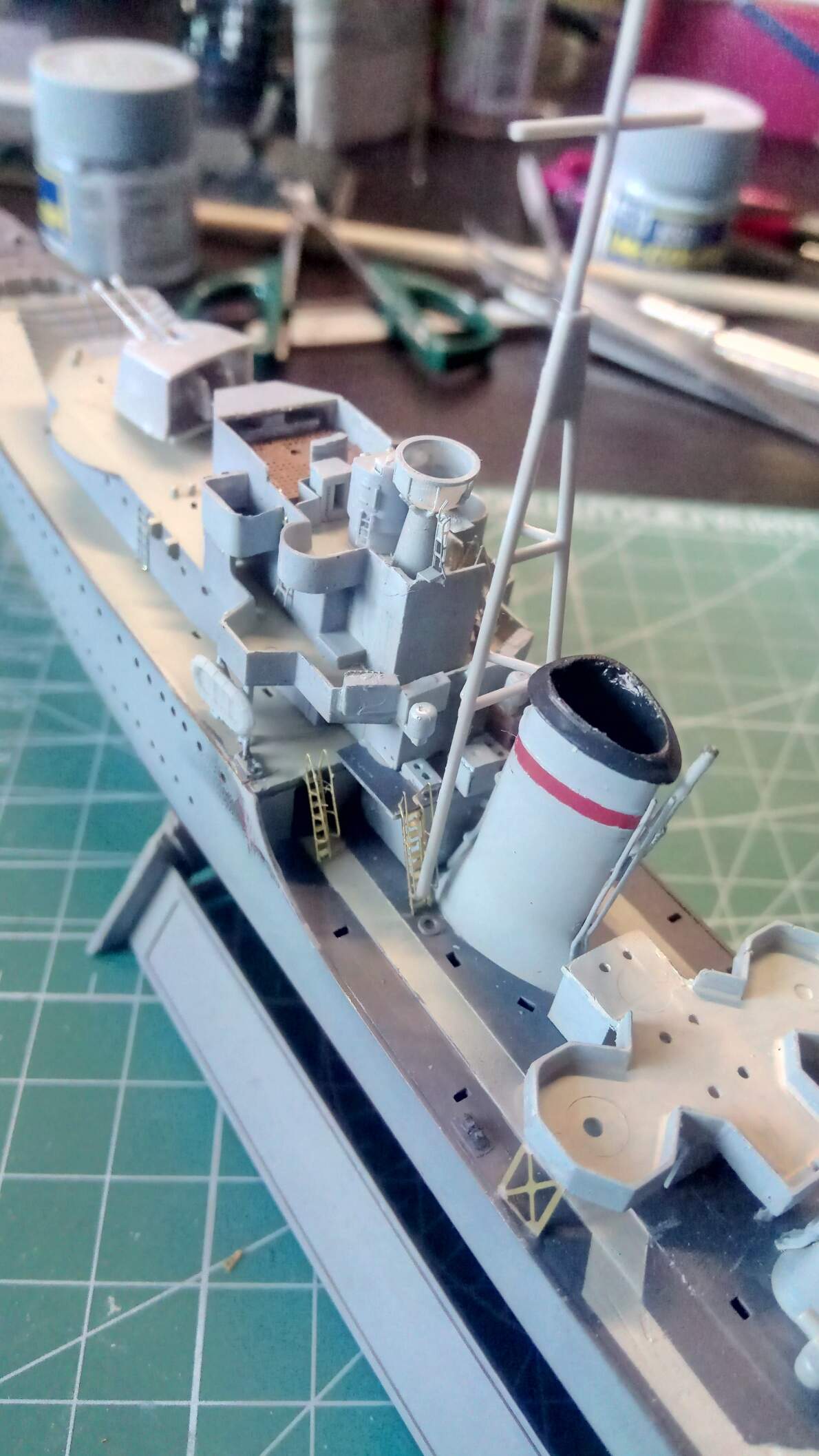

I installed all of the ladders and stairs. You can see that there are actually 4 stairways from the main deck to the fo’c’sle deck There should be a passageway leading into the foc’s’sle but i realized it too late (I thougth there is a door) I simulated it with a black square :wink: The mast is just loose too check the legs clear the stairs.
The platform for the rangefinder and the fire control tower are from Black Cat. Really Nice!. I just shortened the column for the rangefinder a bit. It looked to high for me.
I installed the small gallery on the aft funnel and the aft steering platform from PE parts

@nd post on this board…with regards to the Trumpeter Tribal kits, apart from the already well documented errors and omissions with this kit, has anyone noticed the angle of the funnels? The after funnel looks to be at a slightly different angle compared to the fore funnel, and I’m thinking they should both be the same angle, as I can’t think of any reason for them not to be. This is also the case with the Iron Shipwright resin kits. Thoughts?
Chris, in Victoria, BC
@ Chris: I checked the angle on my drawings, they are parallel (and they are on my version). Maybe its an optical illusion because the aft funnel is shorter and thinner?
What I corrected was the hight of the upper bridge because the funnels appear too short in comparison with the bridge. Acc. to my measurements the bridge is abt 2-3 mm to high. It is surprising how much this changes the appearance.
