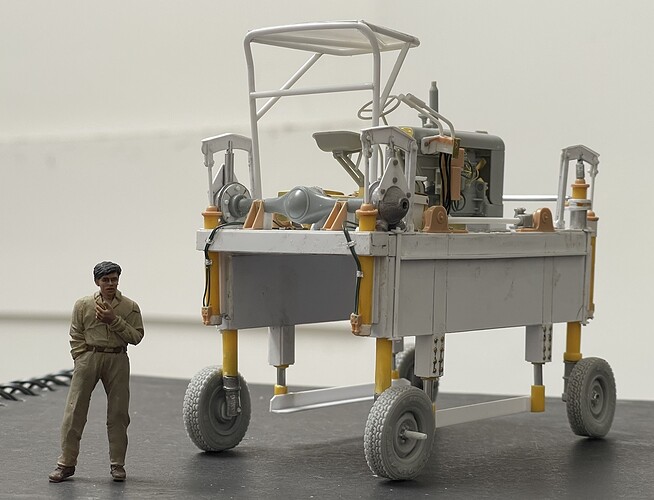

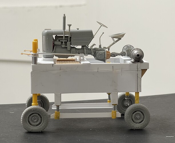

Hi guys,
This has turned into a really interesting build. There is more going on than meets the eye, and it has taken me a while to understand this, and then figure out how to represent it. I say “represent” because I’m still not sure of how this works, but am fairly confident that this is what it looks like:
The idea here was to build what I can see from old photos, and then guess how they work. This little machine’s apparatus appears to function mechanically, but, there are also parts that look to be hydraulic, and I don’t know how to confirm which is which. So, I decided for myself! it remains chain driven (something I’m still working on) with mostly hydraulic apparatus. I added a hydraulic PTO, valve block, some controllers and so on.
The four arms, on each corner - I think those are used to adjust ride height. If you look at photos you can see that there is an arm on top that pivots, with a fixed point on the inside, and a variable point (hydraulic ram) on the outside. The more I looked at this, the more this seems reasonable, something like a rocker arm in an engine - a lifter and spring, but in this case a lifter and pivot, which forces the center point up or down - or, not! :smile: :man_shrugging:

Looking at your photos I can’t figure it out either. Your representation looks on point tho :face_with_monocle:
It seems as if a research trip is in order, complete with local pubs and other entertainment.
