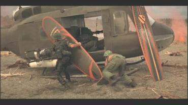

I am trying to recreate/ rebuild my uh-1d to make it “death from above” from Apocalypse Now. I am using my old Revell 1/32 UH-1D. There are very few photos of it, but here are some I have found

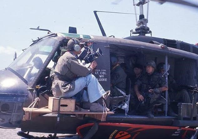

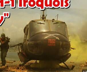

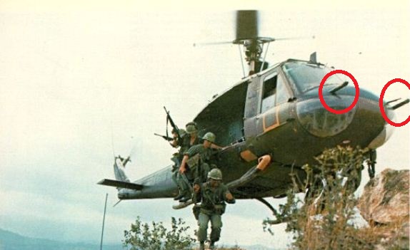

A good choice. It is actually a UH-1H (not a D; no antennas nor pitot on the nose, towel bar antenna on roof, etc.) with two crew chief seats facing forward. Revell’s kit is also an H, not a D.
Some more images of it.

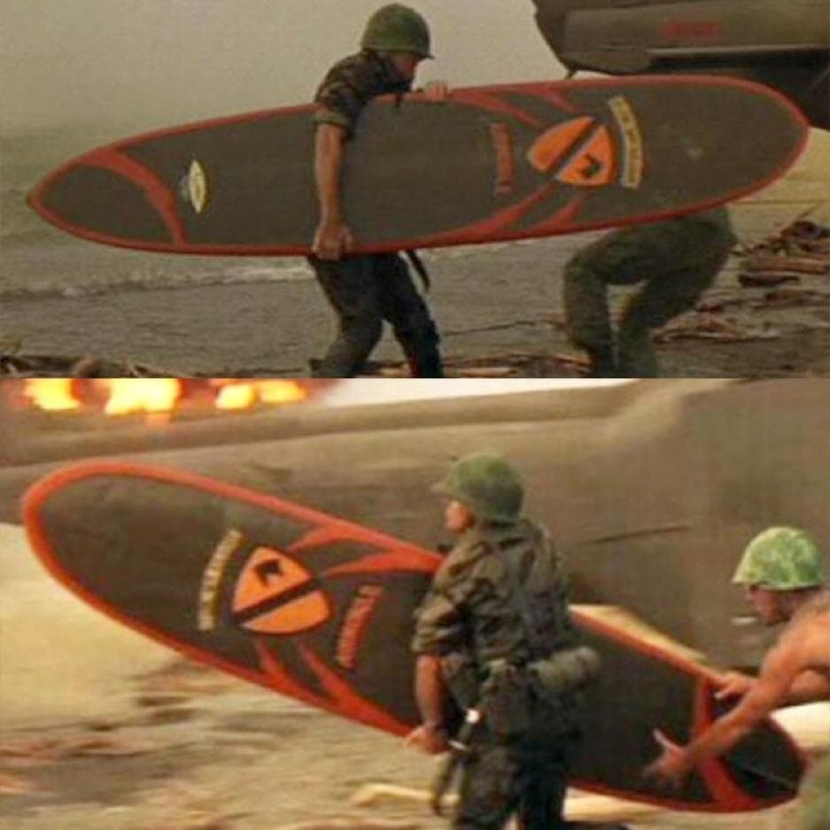

The surf boards.
There are decals for it for sale on eBay.
@HeavyArty is that just the decals only or do they supply the scaled down surf boards as well?
Just the decals. You have to create the surf boards.

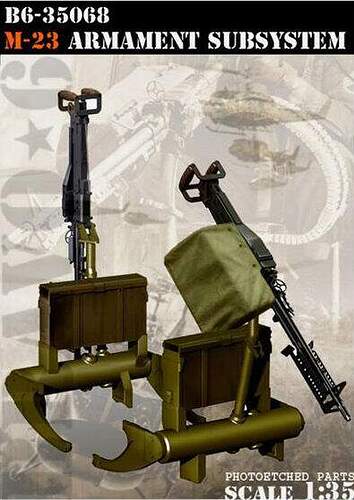

I would use the Bravo 6 Crew figures, but you still need M23 doorgun mounts and M60Ds for them.

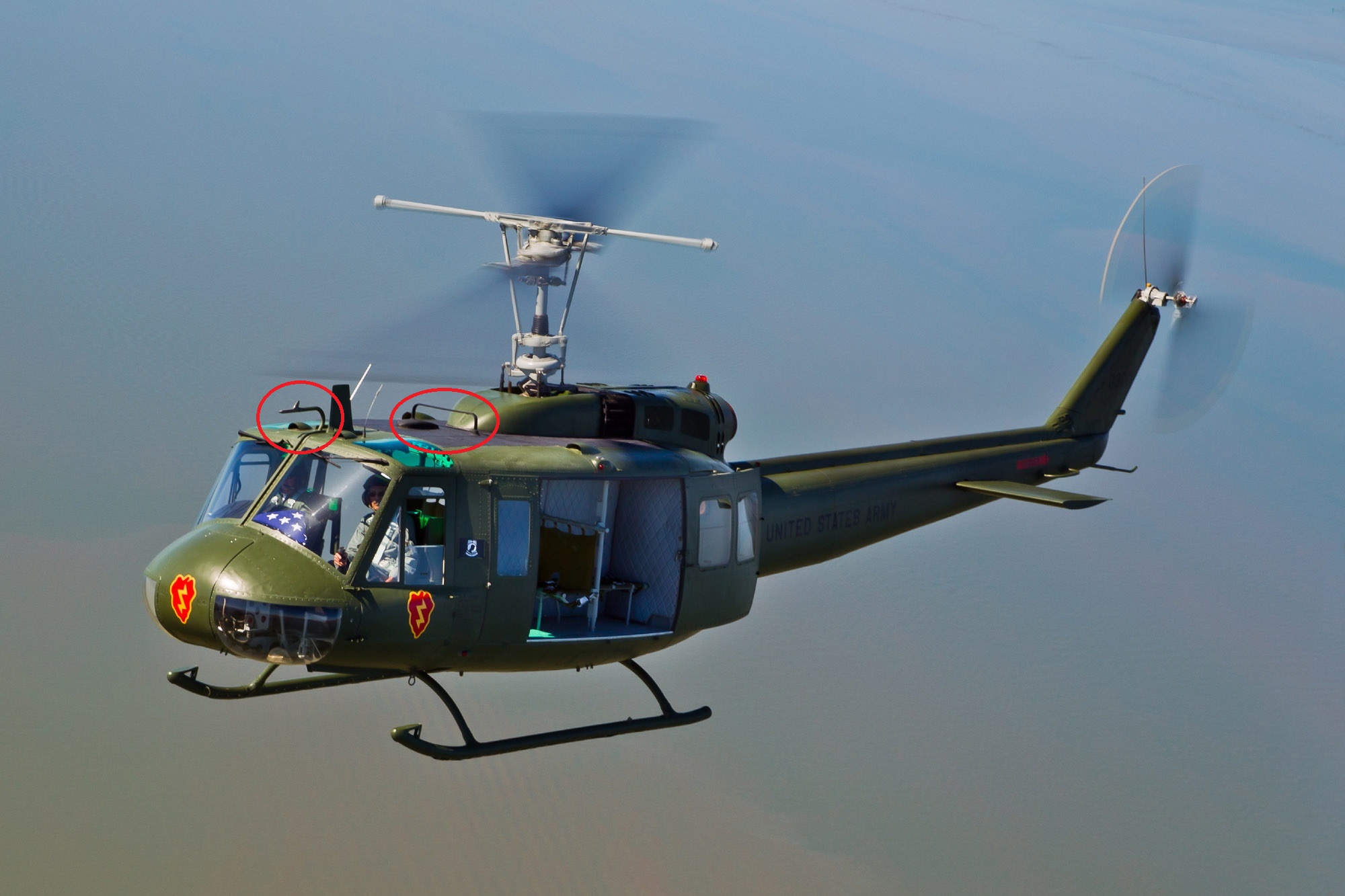

D - Pitot tube and HF antennas sticking off the nose.
H - Pitot tube and HF towel bar antenna relocated to the roof.

Is there surfboards in 32nd scale?
None that I know of. You will have to make them.
EDIT: Apparently there are lots of them

Point of interest - in the film the officer in command
( I forget the character’s name ) orders one of his men to bring him his Yater Spoon - none of the surfboards in the film were Yater Spoons. I guess the tech director wasn’t from So Cal … :wink:

It may be the angle of the photos, but it sure looks to me as if it only has a door on the starboard side. I cannot see the port side door in the photos. If so, you’re in luck - you can use the spare door to correct the one that is used.

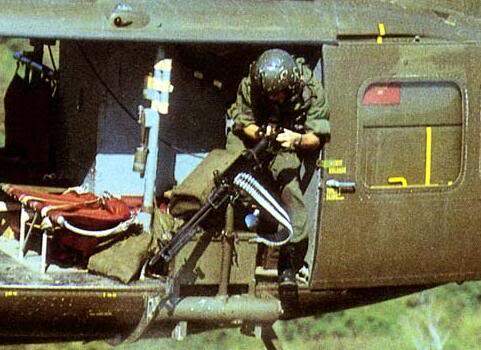

You shouldn’t at this point. Long-bodied US Army UH-1D/Hs didn’t carry the armament that is in the Revell box. That setup was used on short-bodied UH-1B and UH-1C Gunships and on Australian Bushranger UH-1H Gunships. Almost all US long-bodied UH-1D/Hs were troop carriers called “Slicks” and only had the M23 doorgun mount on both sides, as in the Dragon helo crew set above.
M23 doorgun mount w/M60D MG on it, the most common setup.
Bravo 6 also offers the M23 mount and guns to go with their doorgunner figures.
