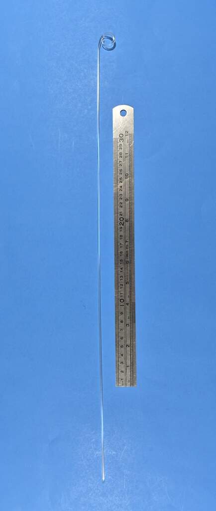

I saved this clear plastic rod from a floral arrangement. I mean…who can throw away a treasure such as this!! :laughing:
Agreed, I have a bunch of thicker ones that are used for curtain-pullers – to avoid grubby hands staining curtain fabric. Problem is, I still can’t think of an application for model-making…maybe something for Sci-fi?
