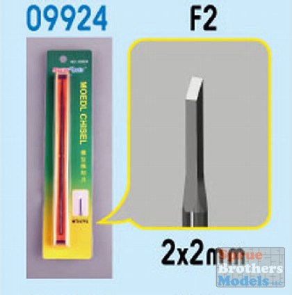

One of the best tool purchases I’ve made is the chisel from Trumpeter . . .
I have a 1mm and 2mm square point and they are very handy for what you’re needing, they have proven to be invaluable in my builds, wish I had gotten them years ago.
Cajun :crocodile:
I was about to point out the Micro Mark detail-removal chisel (Micro-Mark 2mm "Tight Spot" Plastic Modeler's Chisel) but the Trumpeter ones are the same. Well worth their weight in gold!

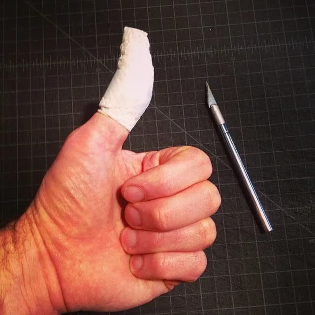

TopSmith (above) has already made a graphic statement about blades. He clearly nearly lost part of his thumb. In my case…
…and that was a brand-new blade 30 seconds old. So yeah try sharpening old blades by all means but wear an armoured glove on your other hand.
My cuts happened when I was using a blade the wrong way,
usually it involved too much force.
By switching to side cutters and files/sandpapers I think I have saved enough on band-aids and bandages to buy a whole kit …

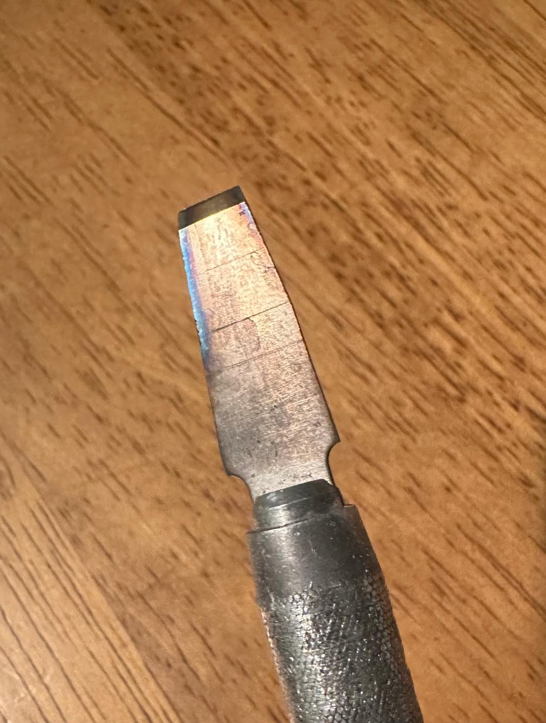

Indeed. Standard practice at my house. I needed a narrower blade for this:
