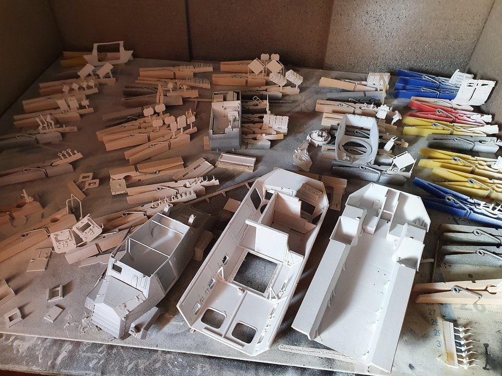

Beginning with the “white room”…
Finalizing the interior…

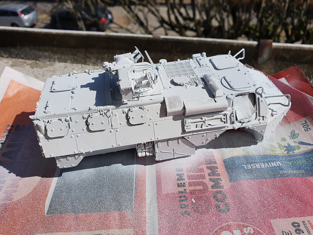

Starting by a NATO Green base coat
Next step, a white coat…
Hi, nice! What kind of white paint are you using I also want to make a UN model, but find the Tamiya XF2 really bright white, almost fluorescend…
I usually use a first coat of Tamiya XF-2 alone, then a second coat of Tamiya XF-2 mixed with Tamiya X-2. Once done, I break the brightness by using Abteilung 502 Faded UN White.

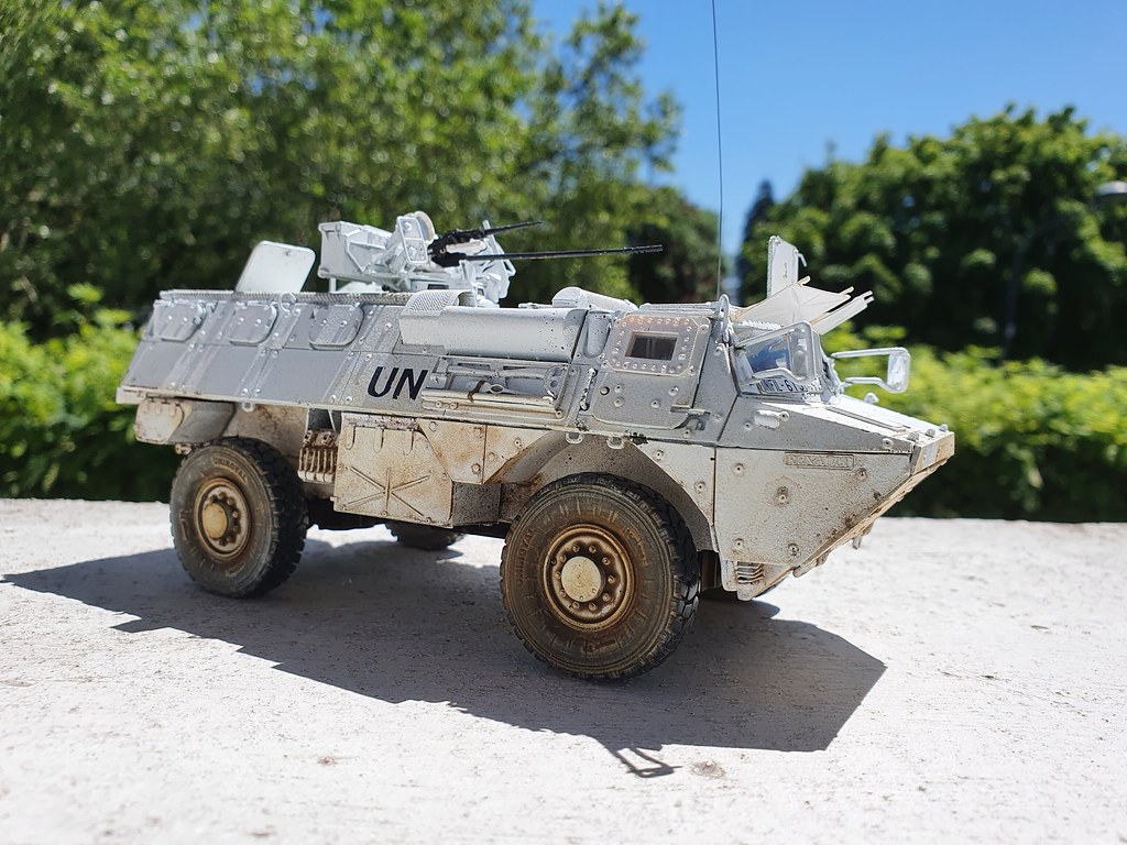

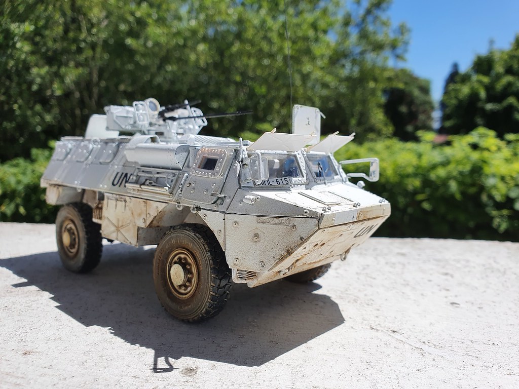

Applying an initial filter with Abteilung 502 Faded UN White and doing a dry run on Blast Models Uniroyal wheels…
The project is almost done…
