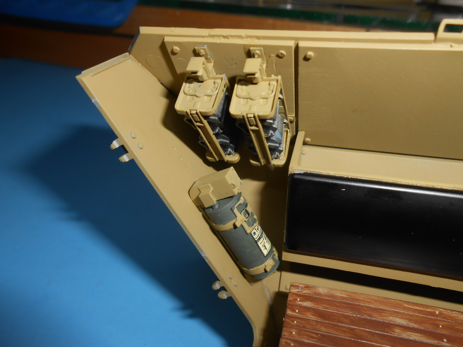

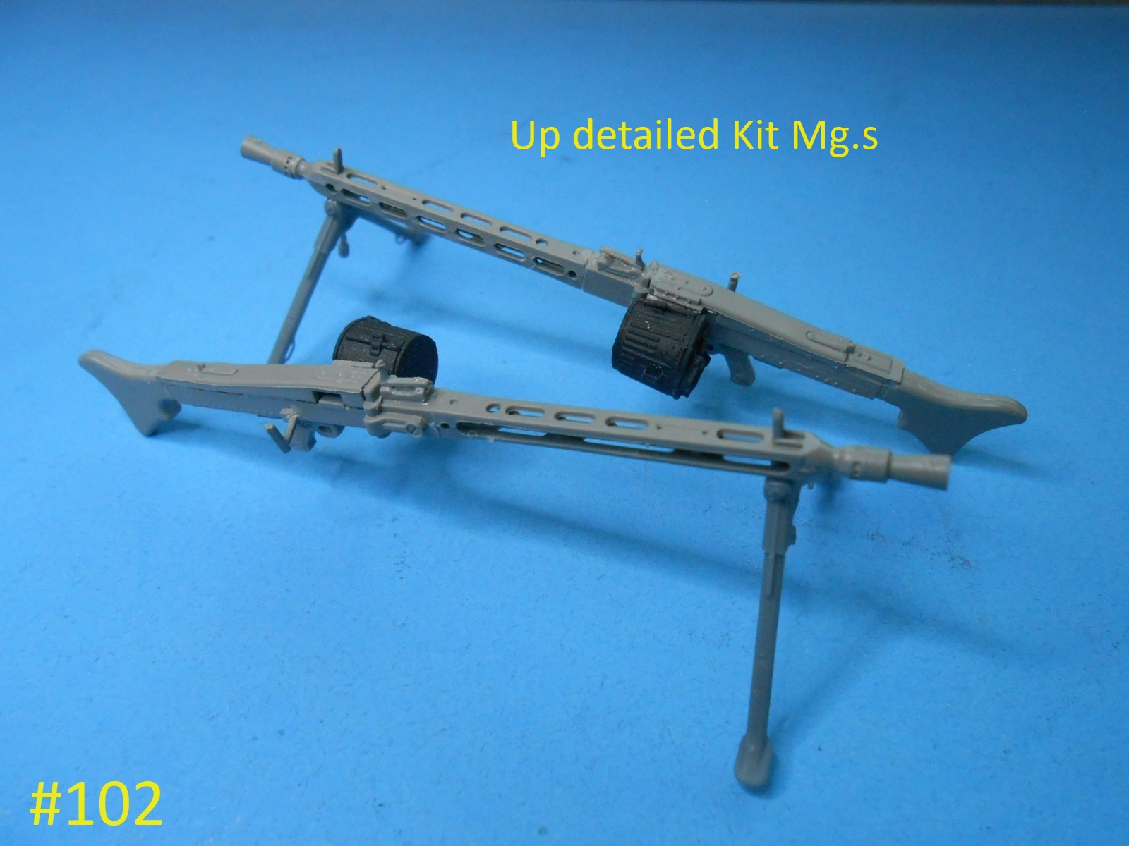

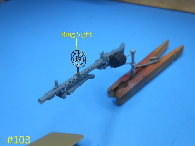

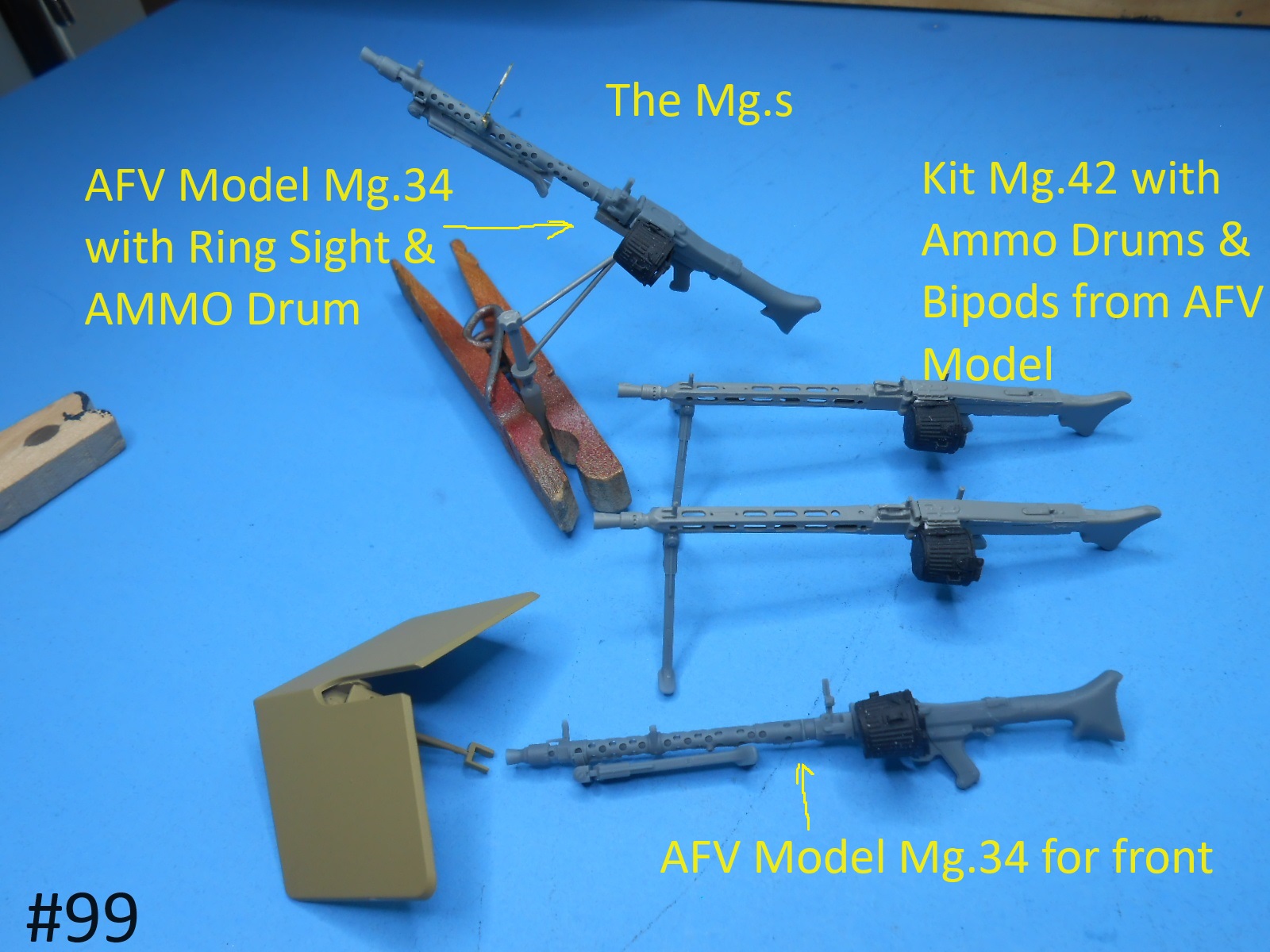

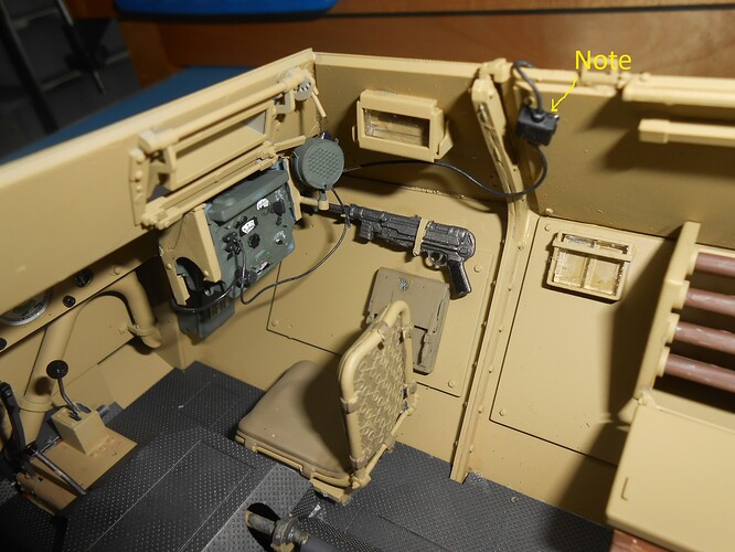

Hey David the Radio is seen in Pic.#81 I’m still adding some of the missing accessories , More detailed Fire Extinguishers , Mg.34 Ammo Drums and their storage racks 4 total, the new seats are in there already . New Headlight and radio antenna , there’s a lot to go yet.
Regards
Donald

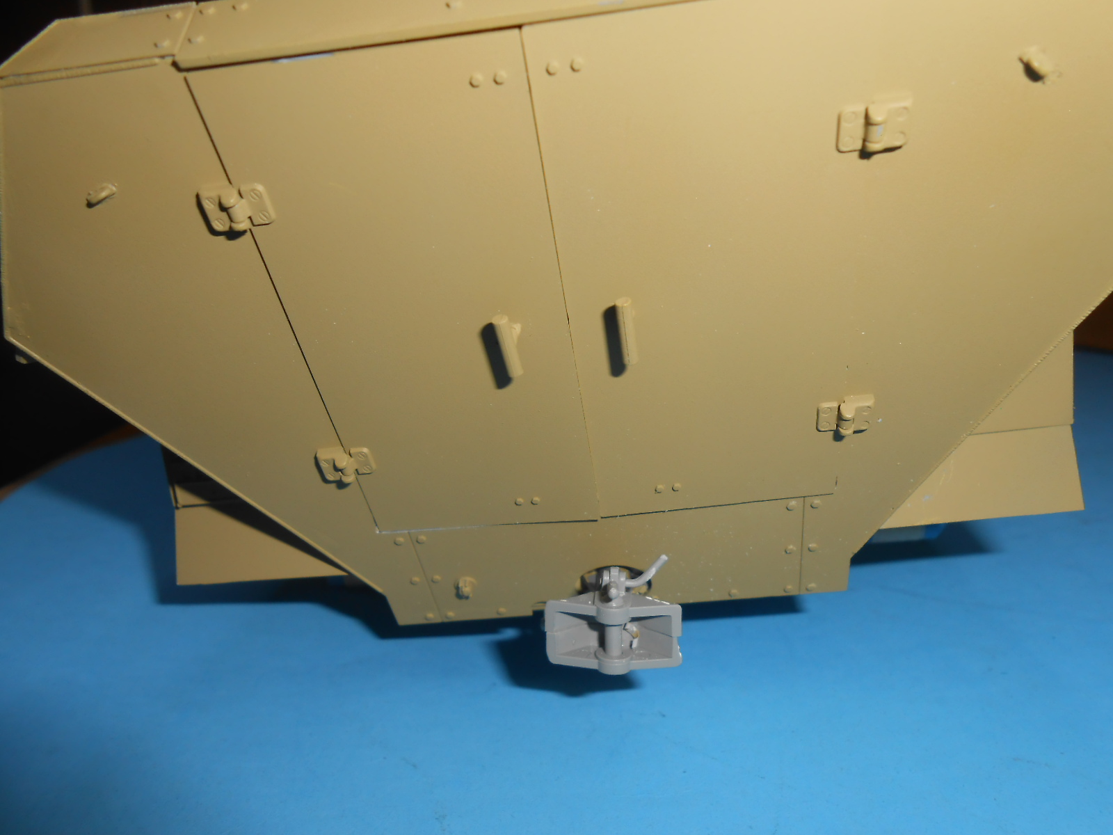

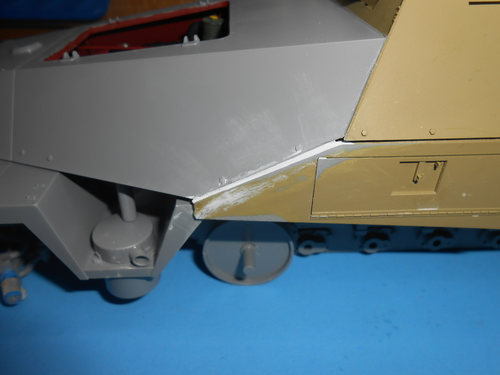

A large Gap
Not a really good fit on the bottom of the rear plate.

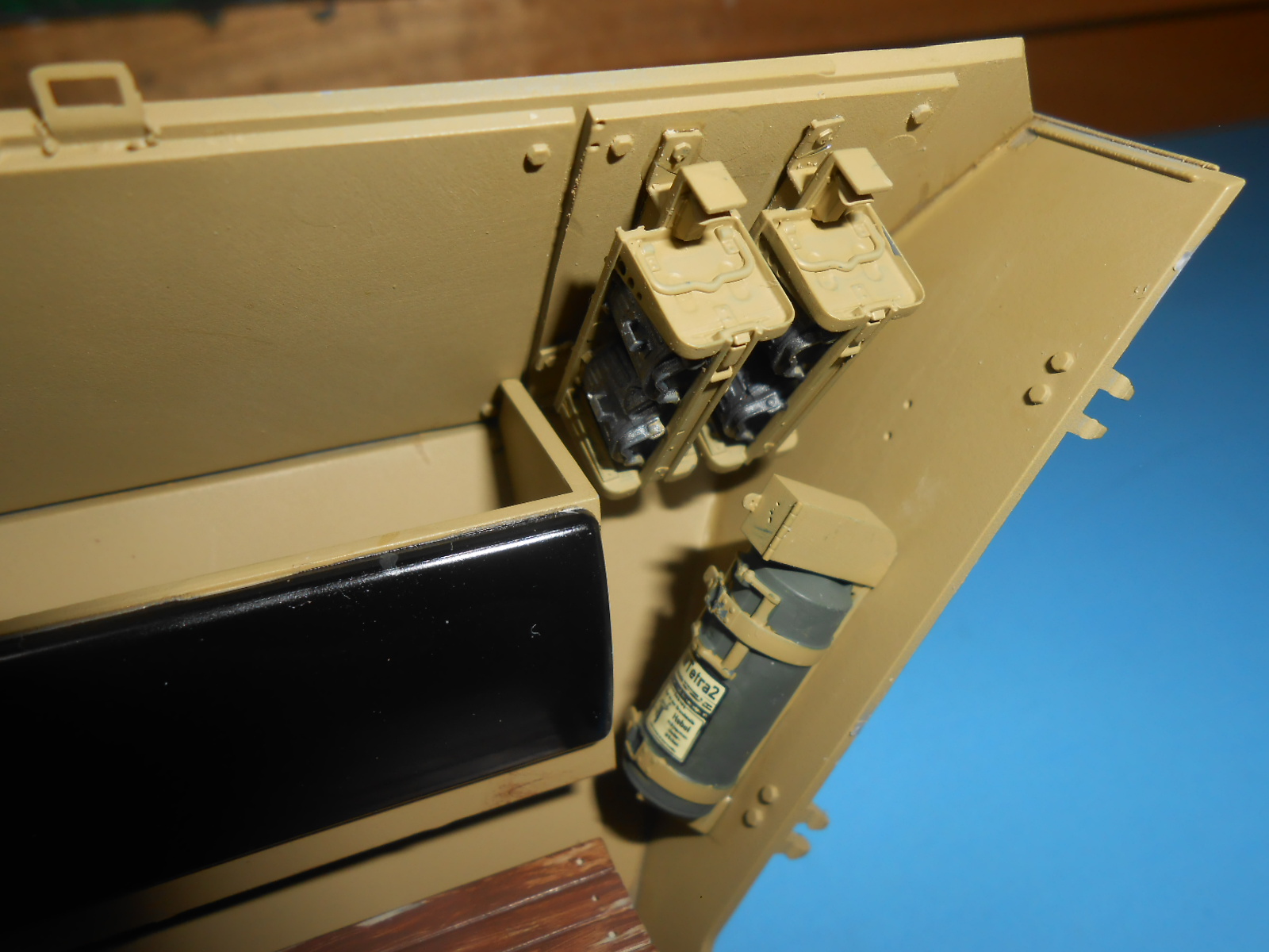

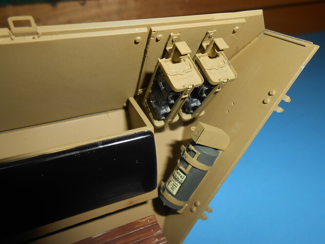

I lowered the Fire extinguishers to fit the AMMO Drum Racks
I’ll be touching up the paint once assembly is finished.
Regards
Donald

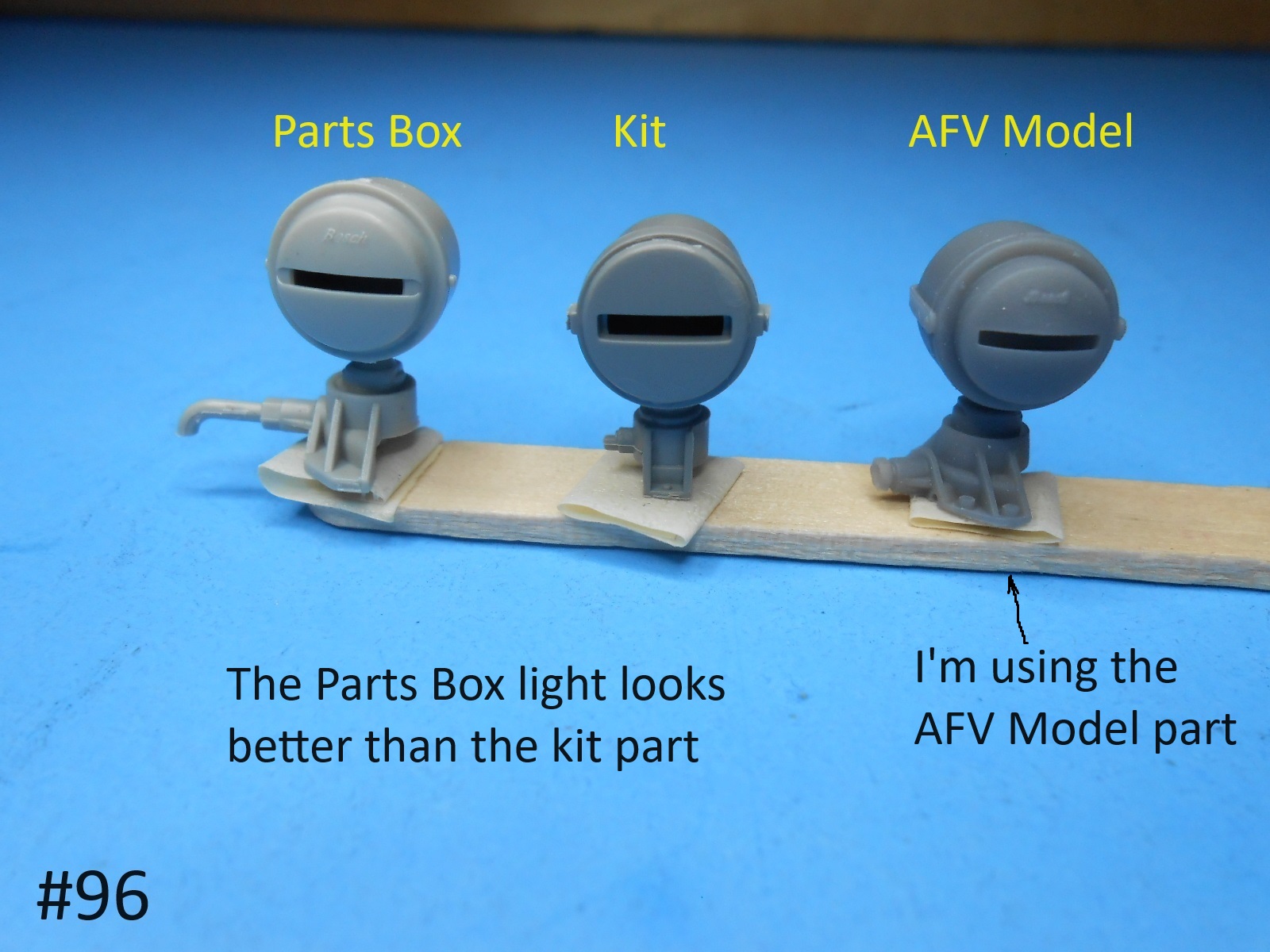

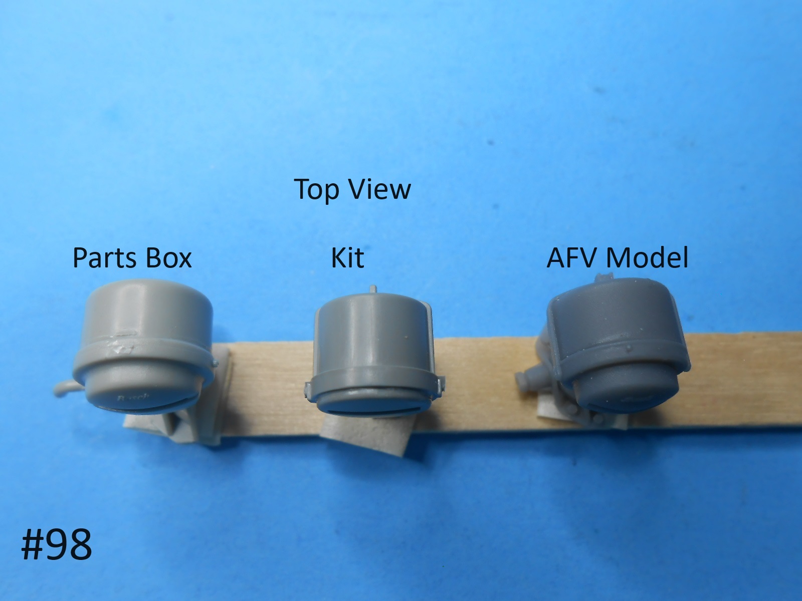

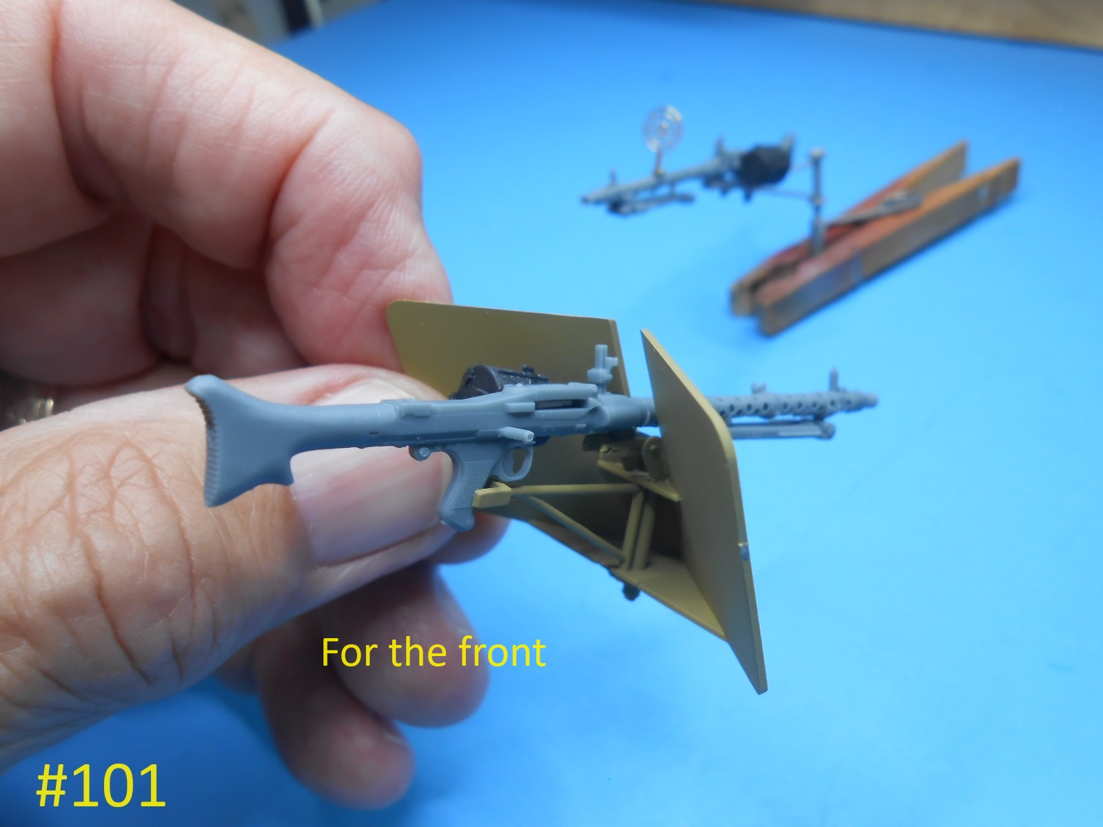

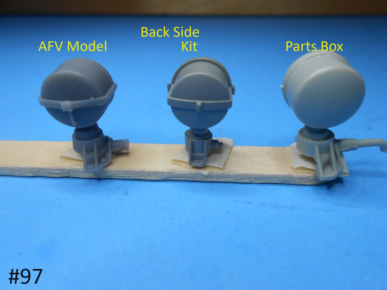

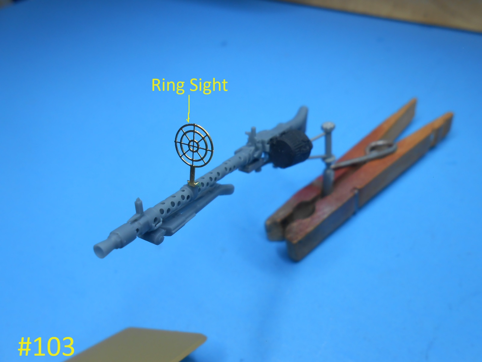

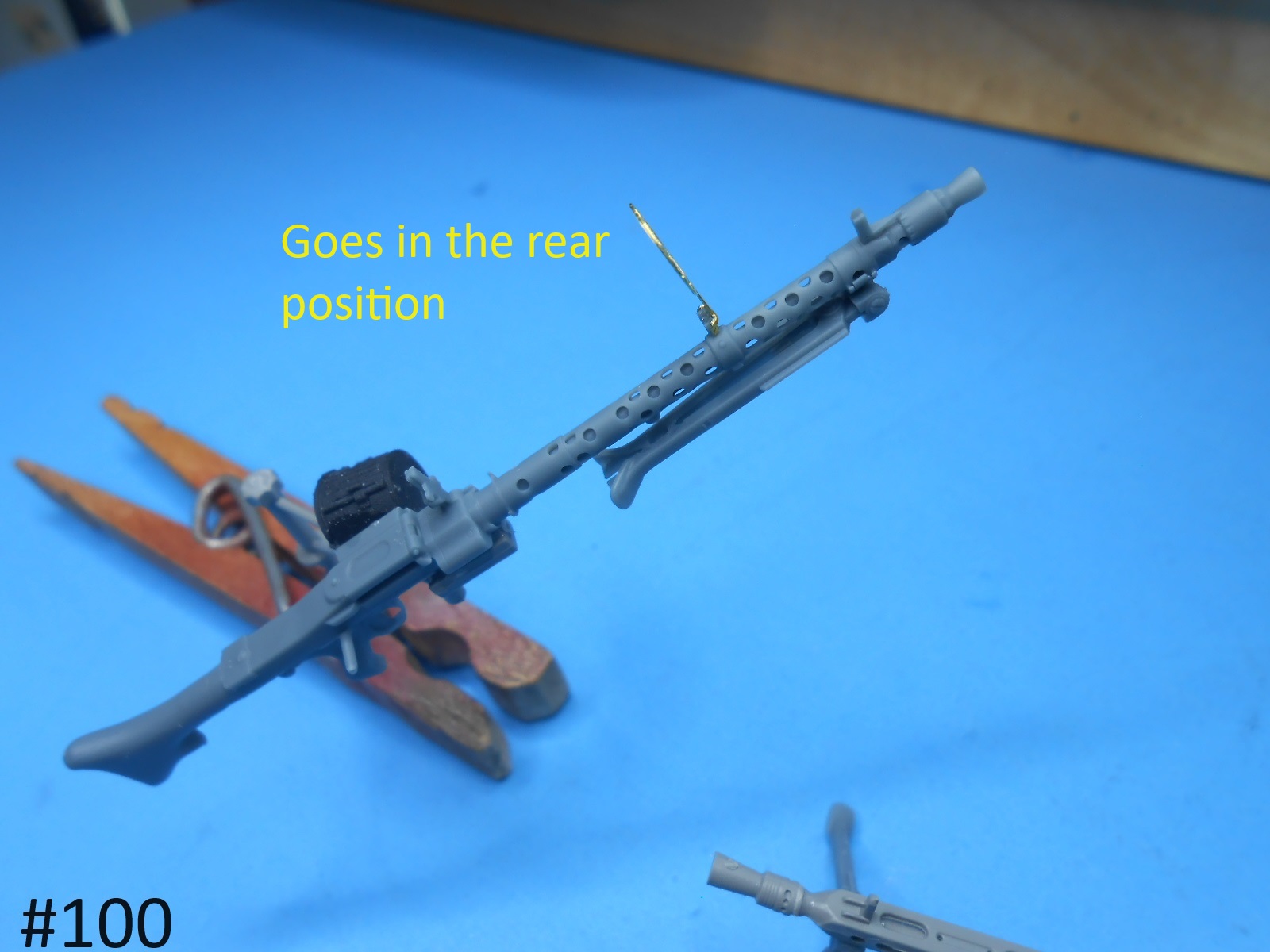

The Headlight and Mg.s
Now to paint them.
Regards
Donald

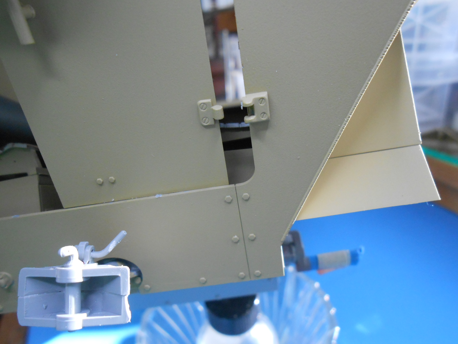

Now a little fit problem easily fixed.
You will notice the rear doors are square on the corners, the question is why did the kit manufacturer put rounded corners on the rear door openings.
It makes you wonder if ANDY actually built this kit or not ?
Also the opening is about 1/2mm short height wise , You can trim the doors or trim the opening. I trimmed the opening as the corners needed to be squared off.
Regards
Donald
Hello, I have been following along with this build as I’m slowly working on one of these halftracks as well. I did some test fitting of the rear door parts on my kit as well as a little googling and found out the parts D16 and D17 should sit proud of part D13. The bottom outer corners of the doors (D16 and D17) should rest over the rounded corners on the bottom opening on D13. It seems Das Werk molded the opening for the hinges on D13 too deep allowing the hinge portion on the doors (D16 and D17) to sink in too deep giving the impression the doors should be a flush fit. Your kit is looking great!

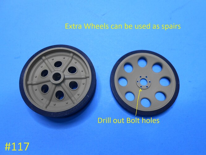

Now for the Wheels and Track.
I painted the Wheels and tires while they were on their Sprue , easier to handle.
I assembled the kit front wheels to show how they go together , I’m not using them as I have a detailed pair from AFV Model
There are extra Road Wheels that may be used as spares
The inner pair of Wheels are tricky to get to line up with each other.

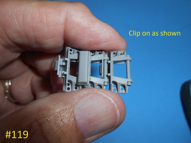

For the track I clipped it together in groups of 10 it’s easier to handle that way.
Just Clip together insert Track Pad and glue along back edge.
Next to paint and weather them.
