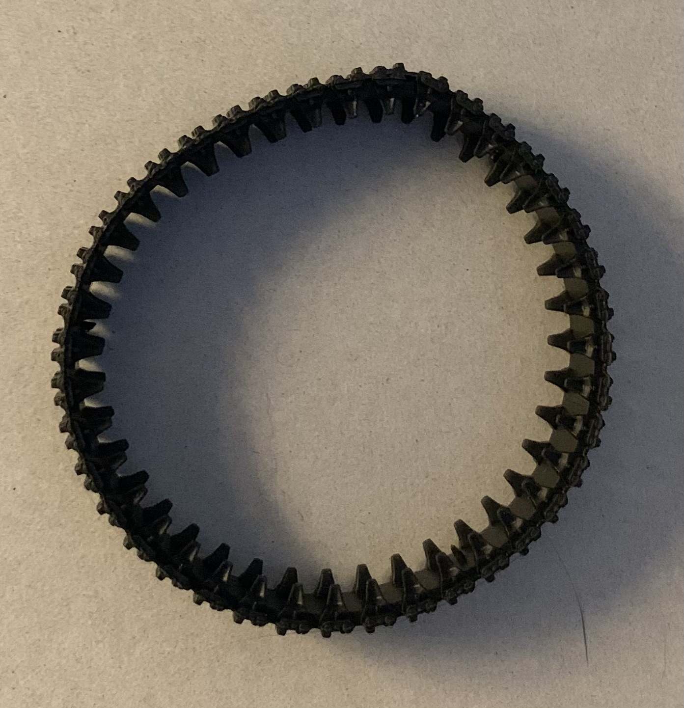

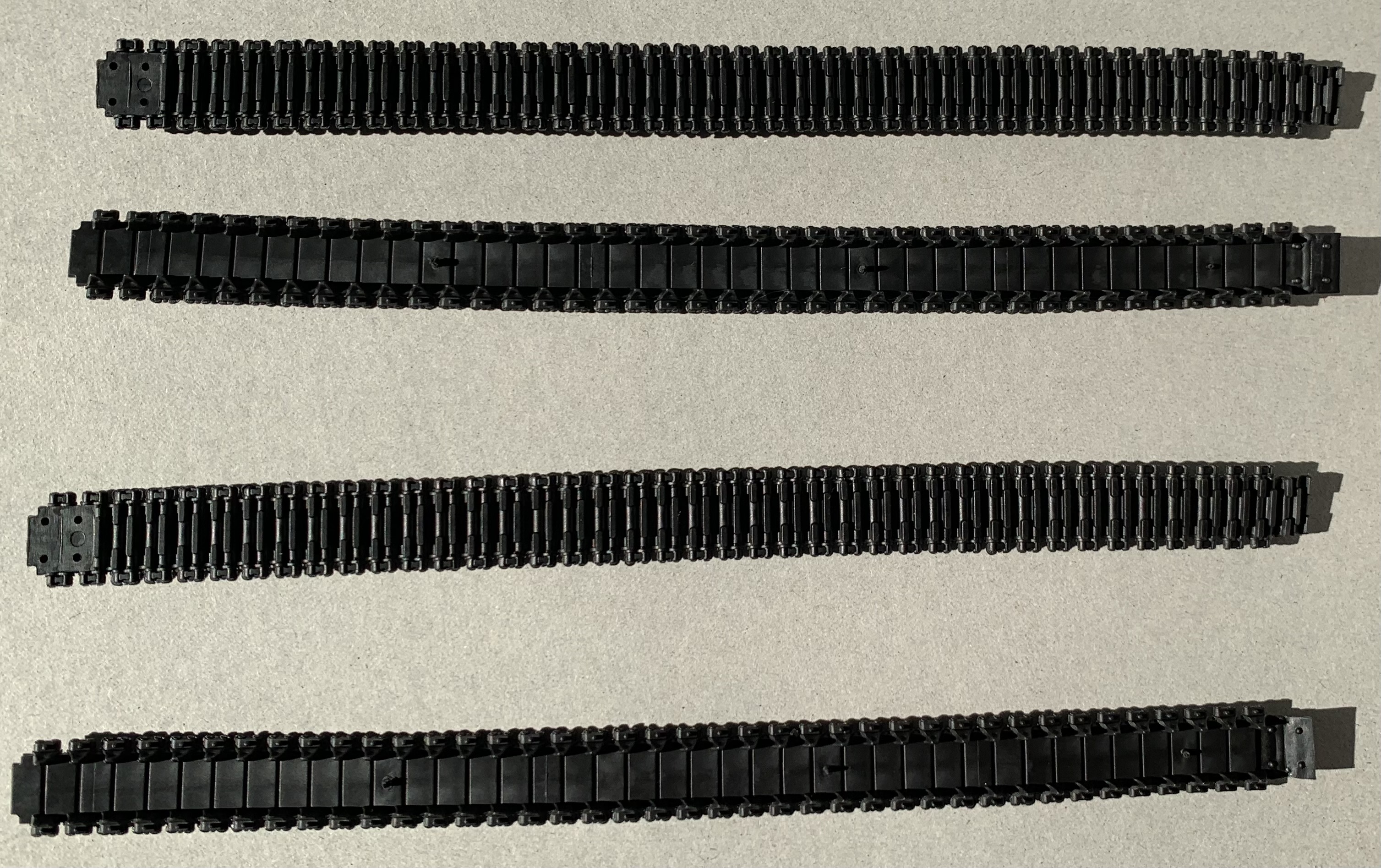

They may be two parts but they are not in the same league as Dragon or even the depths where Italeri’s created their monsters. Haven’t used them yet but I have gotten extra Asuka tracks they appear that nice.
Asuka\Tasca’s “sucky” 2 piece tracks are very well detailed and molded. They are perfectly usable for live track such as on the Sherman which has no sag at all. In fact, Sherman track curls in on itself when loose. Don’t ditch that kit - it’s a good one and builds great OOB.
It’s not a turkey but tasca is a lot like tamiya-great fit but lacking in small details and vinyl tracks.
But the tracks end connectors have a seam line on them that can’t be removed.

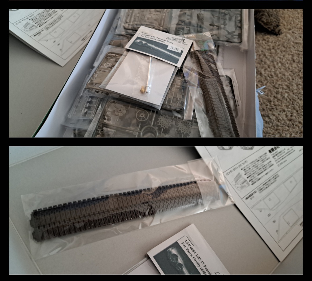

Agreed, Tasca Firefly will get built probably at some point. Probably with a set of aftermarket tracks.
What type of track does the Tasca Firefly have so I’ll know what to look for? Is it T-48 or T-72 or something else?

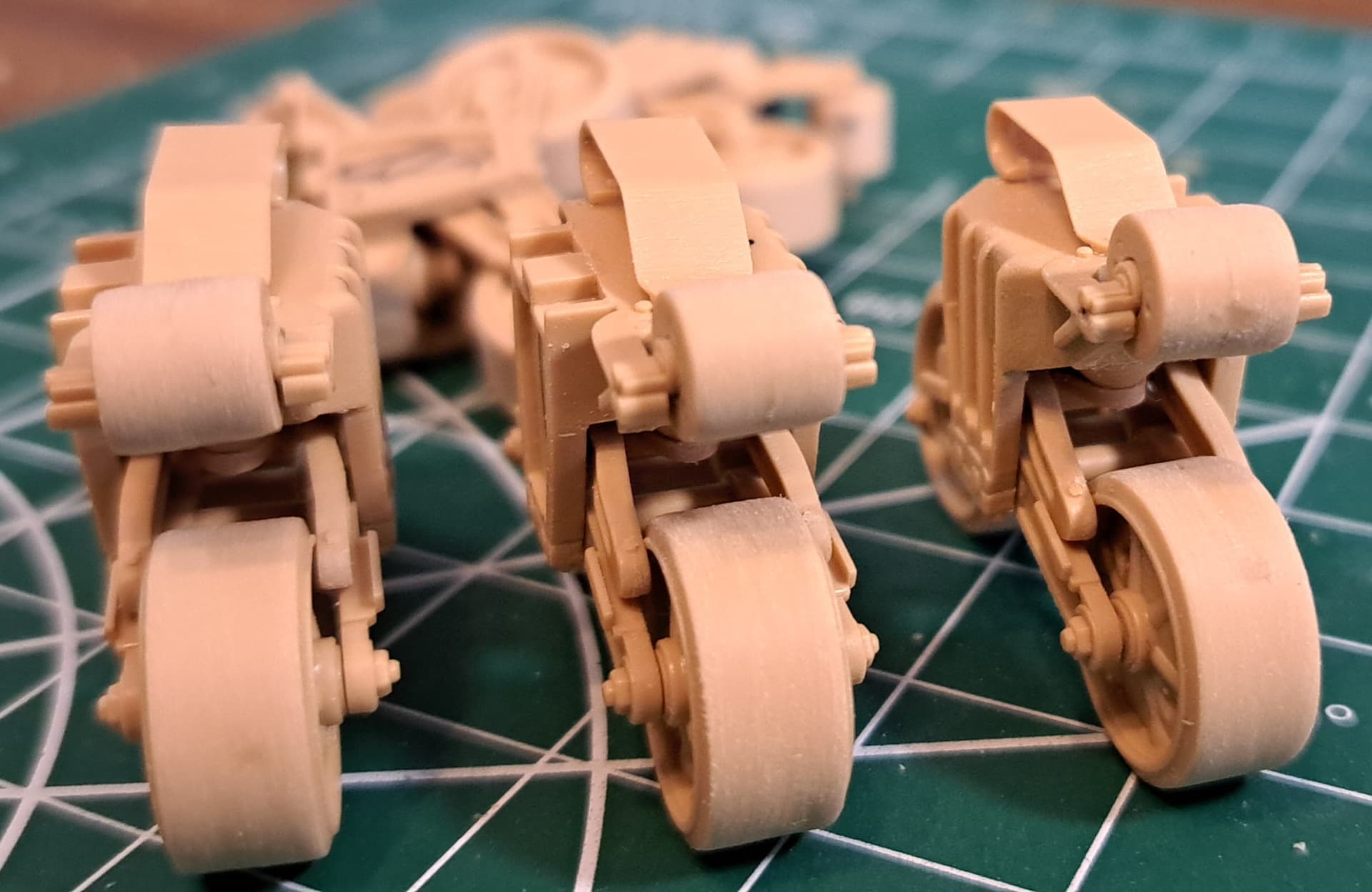

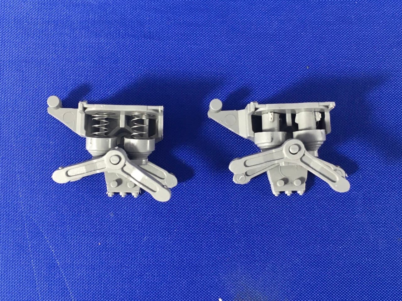

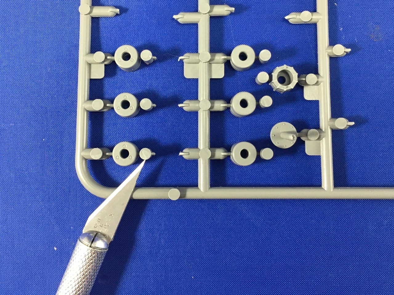

There’s a much simpler way, and it will lock the suspension for proper modellers instead of this gimmicky real spring stuff :slight_smile: Find these little nodules, pointed to by my knife tip, that are on the return rollers:
The kit includes twelve. Then just fit them instead of the springs:
This puts suspension at the correct ride height for a normally loaded tank.
You are calling it a turkey based solely on including soft plastic tracks? :roll_eyes: Maybe try building it, you might discover that it’s actually a rather good kit, and the tracks — though made of soft plastic — are much better than most of those you’ll find. But if they disturb you so much, they’re also real easy to replace by separate-link tracks of pretty much any kind you care to add.
Jakko, thank you for the spacer tip. That will be useful with the other VVSS RFM suspension Shermans when their time comes.
Agreed working suspensions are just a little too much gimmick and dislike them.

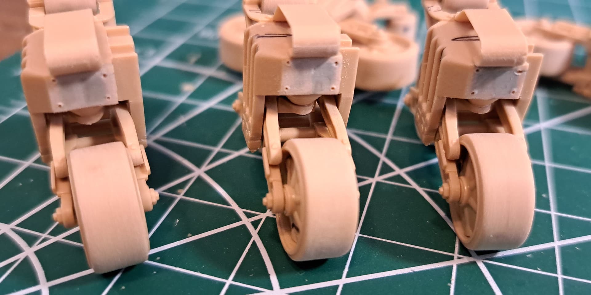

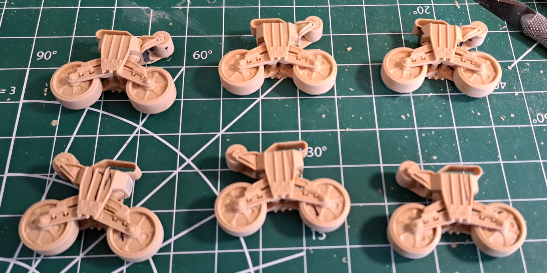

For me the suspension bogies proved less fun than building the tracks.
They may need additional touch up after base coating.
They look good

The FB will make for a better game plan for any vinyl track than tossing in the freezer and using a scapel blade.
When we say they are flexible, this what we mean.
I just press fit it with no glue or anything else to hold. It does pop open after a few seconds but not many other vinyl tracks can do that.

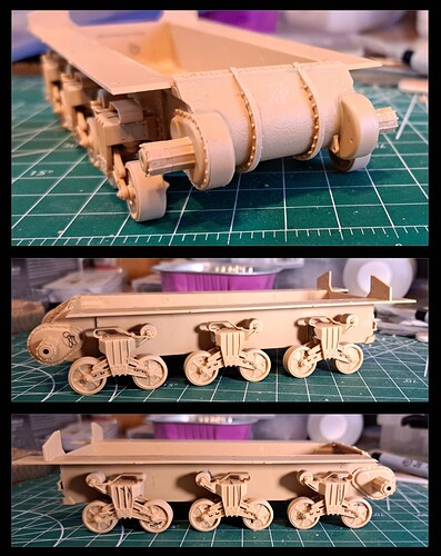

Started to take shape today.

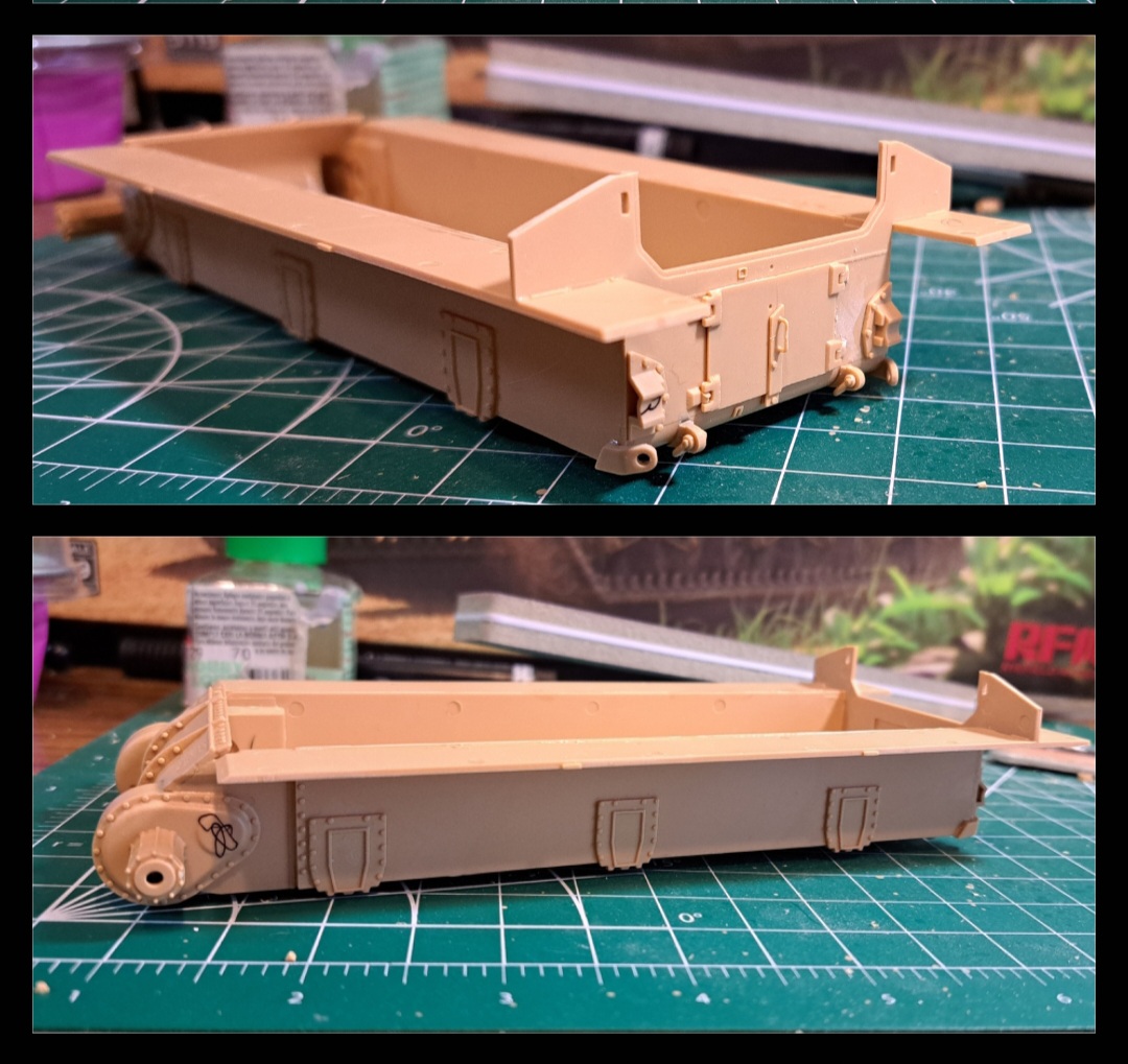

Not impressed with how the lower hull goes together. Slightly surprised RFM didn’t include a stiffener mid hull to ensure everythings square & true like some other manufacturers do. Goes together without issues in anycase.
Sits level enough for me.
Kali says that’s it for now.

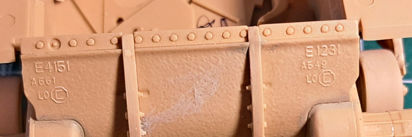

Does it have casting numbers on the transmission cover pieces?
http://the.shadock.free.fr/sherman_minutia/differential/differential_covers.html
Yes
Good to see. I think Tasca kits don’t include these small details.
