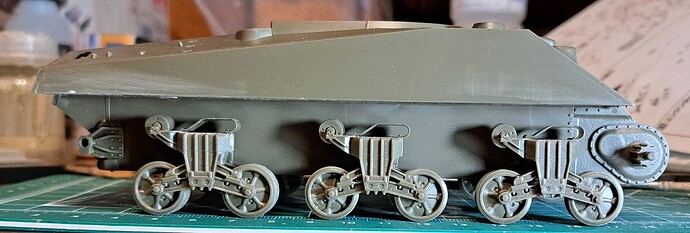

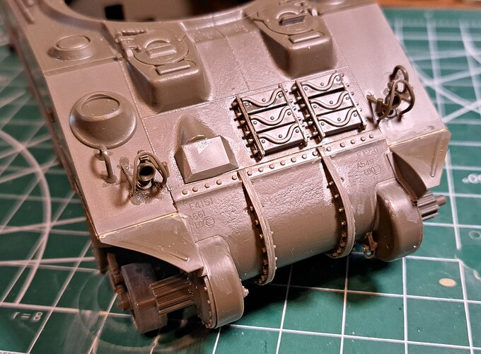

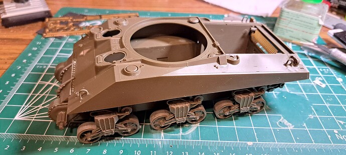

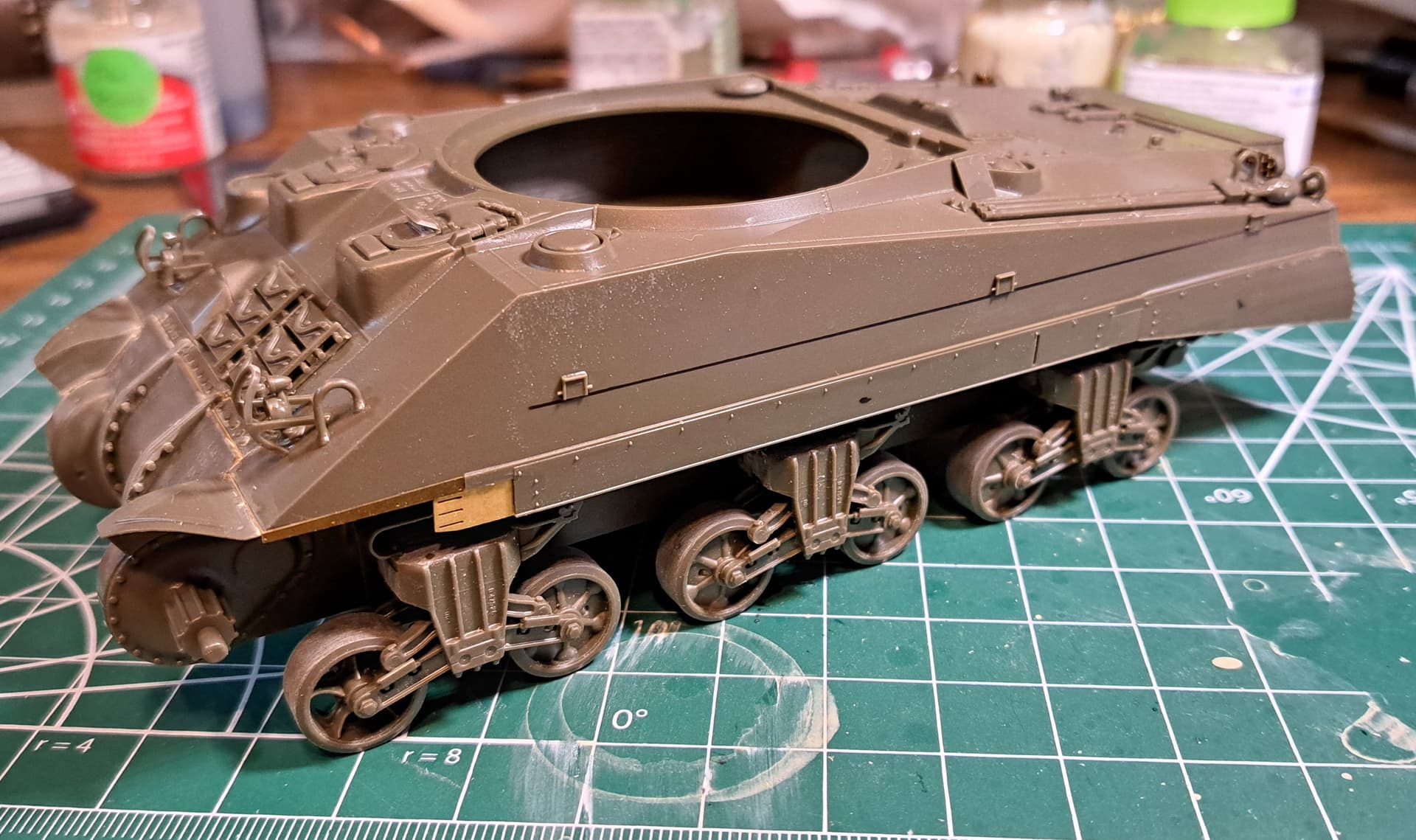

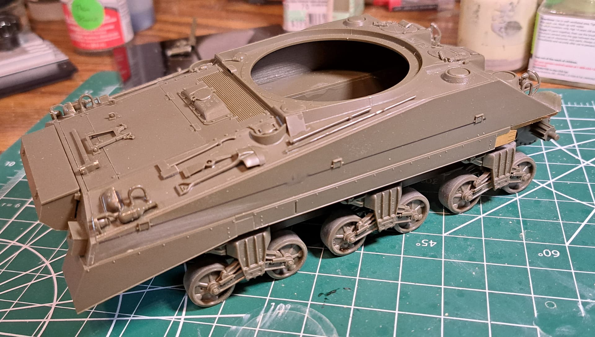

One might find an adjustment with this kit since sponson “runners” on both sides were only ~ .015 to .020 short vs the hull.
For me pushing the hull back ~ .020 from the transmission cover would fix the sponsons but move the problem. The problem was easy enough to fix at the back.
Decided to use bogies as is…and not redo…

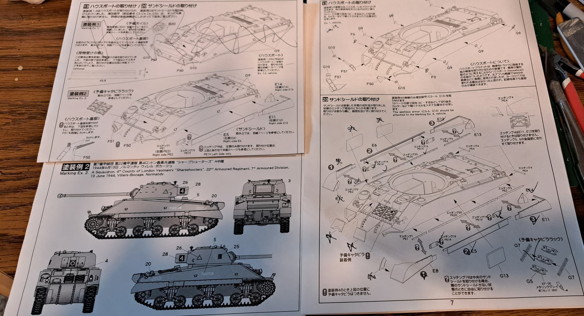

Enthusiasm for the build wanes at step 19/20 due to the confusing instructions.

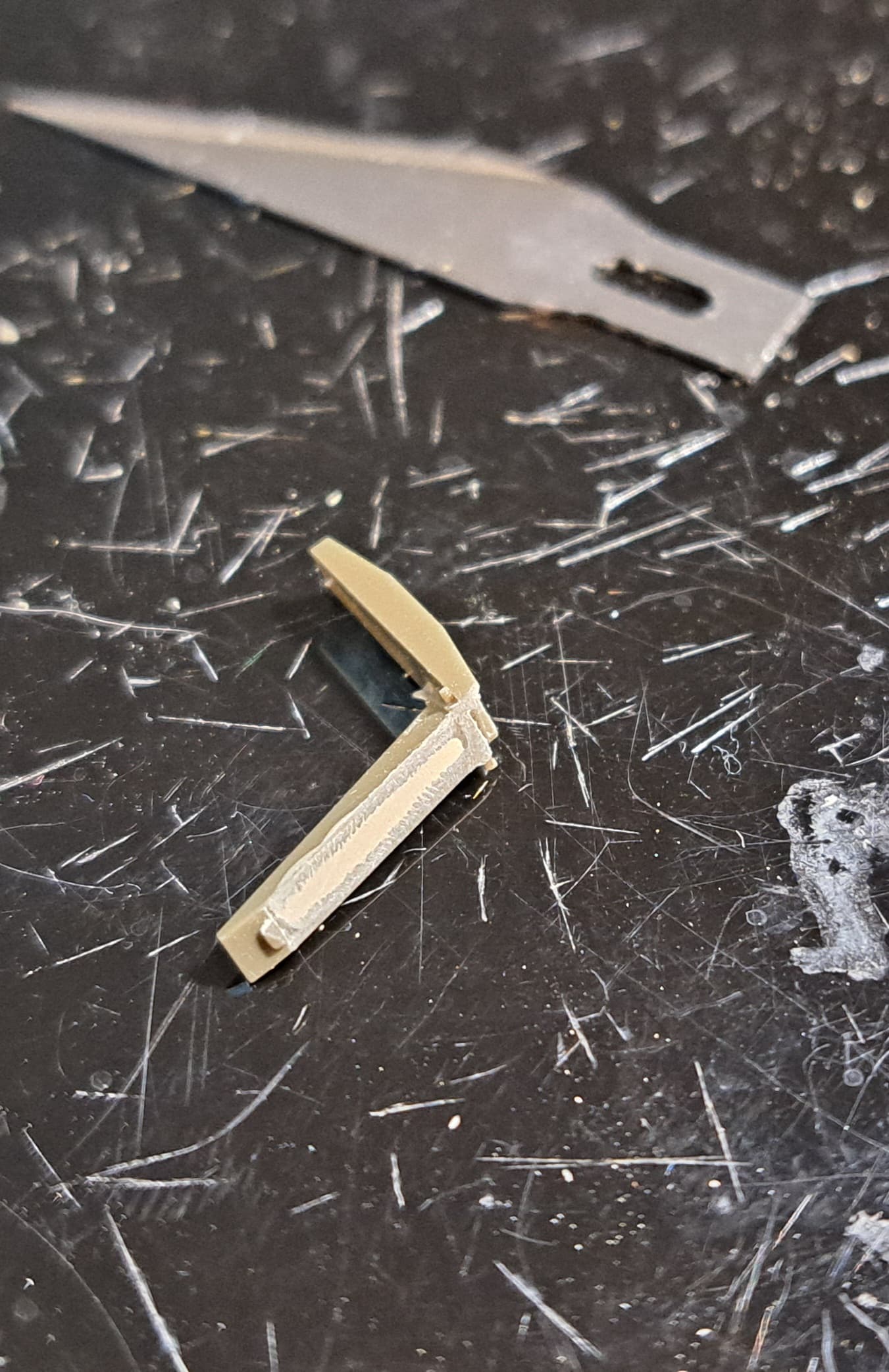

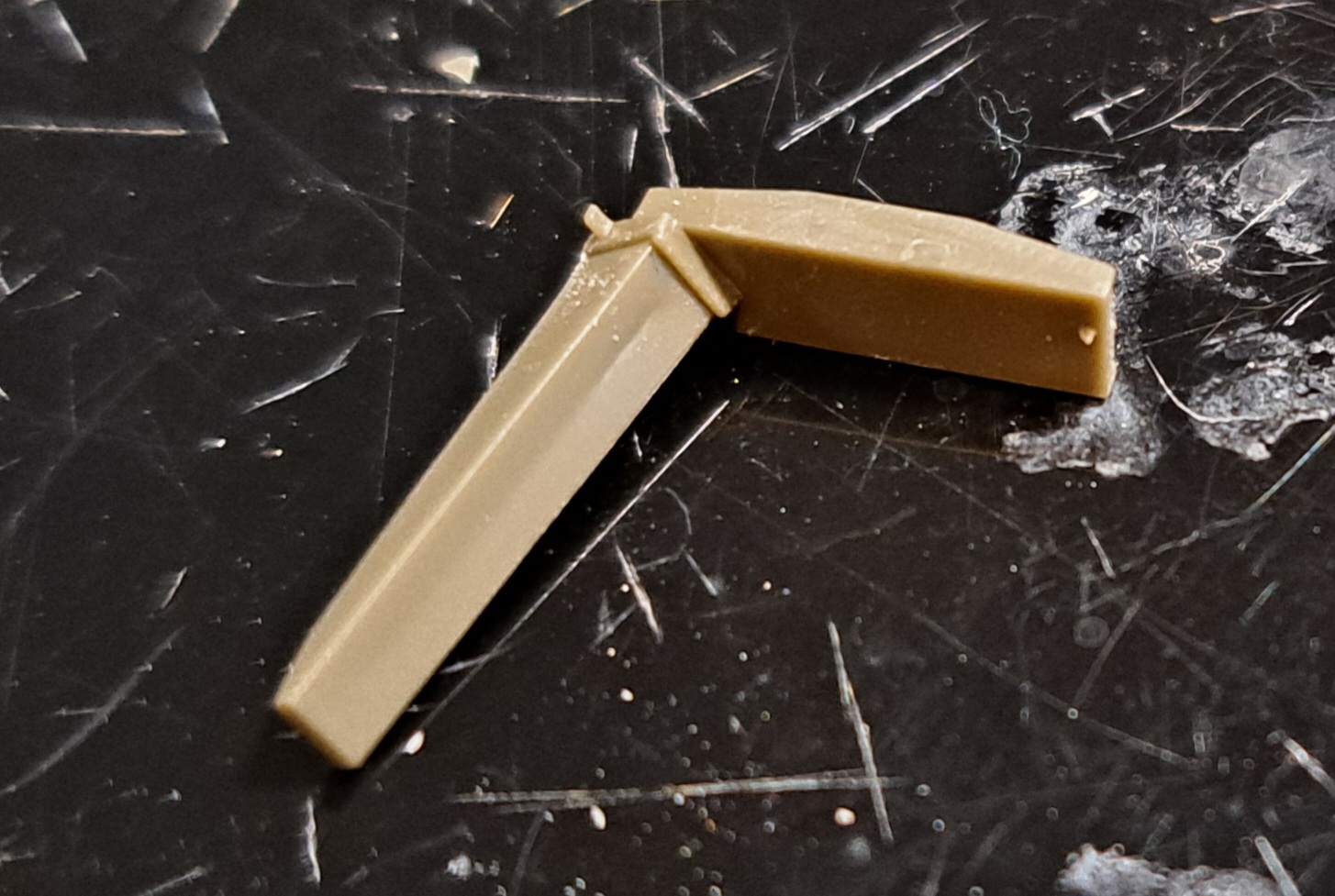

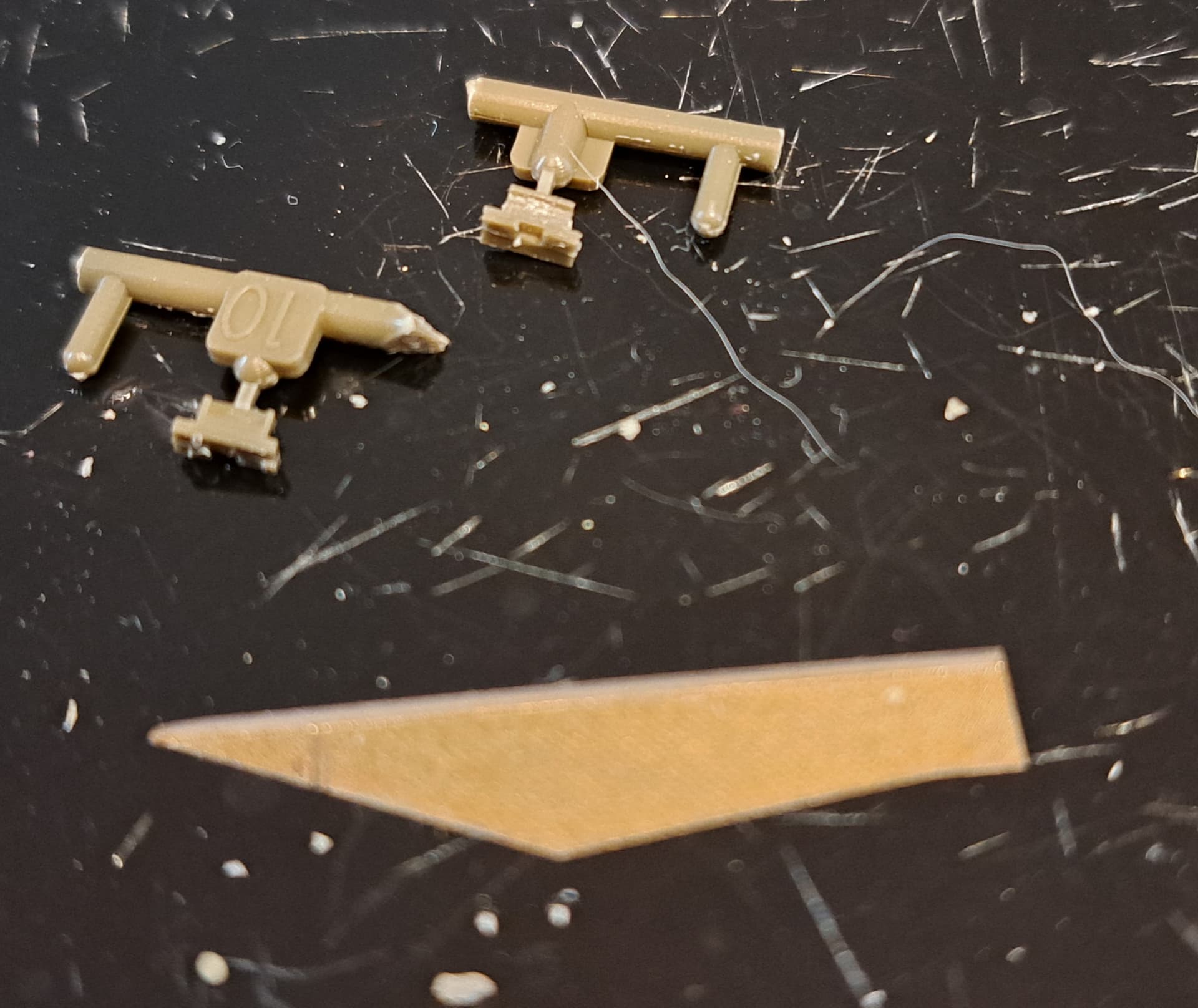

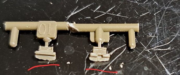

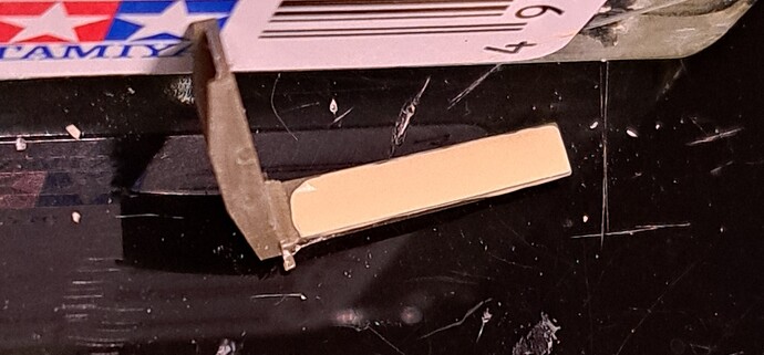

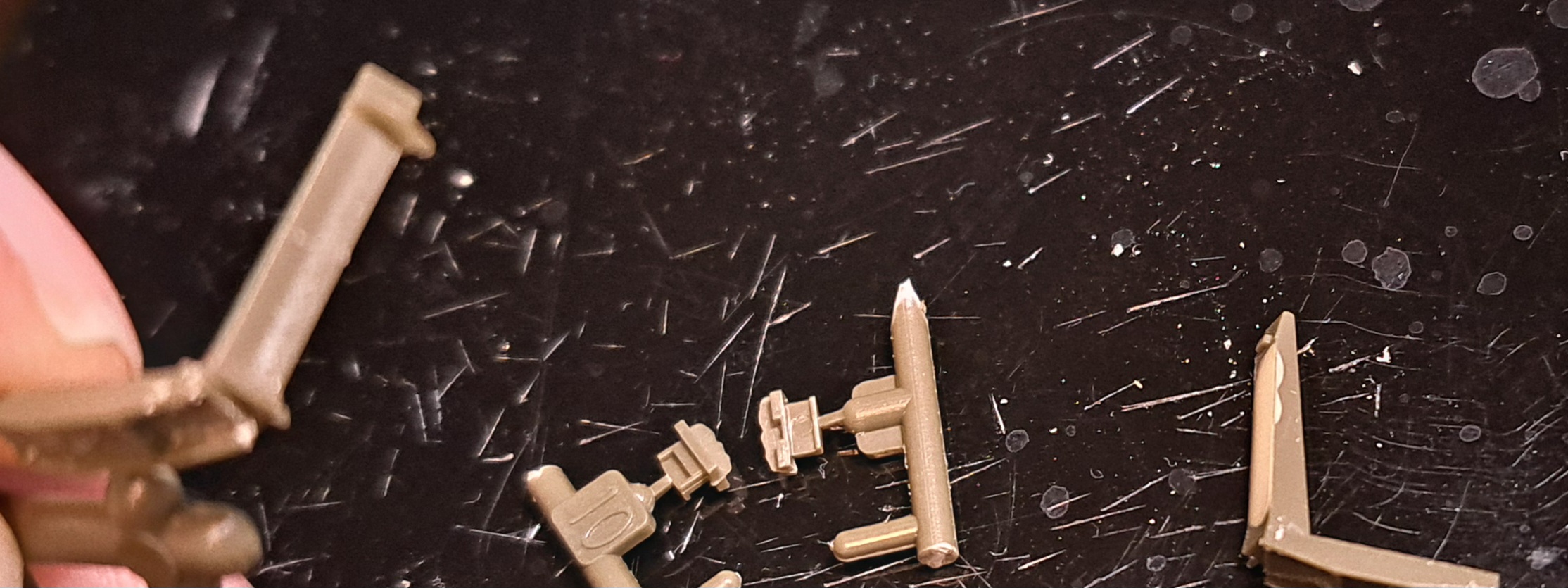

F50 & F51 have sink marks to fill on the top face. Both parts have punch marks to remove as does G10 the end cap.
Fixed
Really now, don’t expect good quality on the otherside.
Fixed
^Pretty disappointing :disappointed: :confused: :pensive: at drifting towards Italeri territory it seems.
Nasty flash on Tasca parts.
Flash Blades work pretty well.
Step 19/20
Overall, I much prefer Ryefield Model’s upper hull assembly, in part because the instructions are better organized than Tasca’s patched together mess. Others might feel different or know of a detail reason to give the nod to Tasca. Based on my experience, I can’t.

Bogies arrived in a rather large box considering what’s inside. Seems Asuka didn’t include the plastic spacers to adjust ride height. Foam sheet to cut to sizexis included. The kit has a few parts allow adaptation to other Sherman kits.

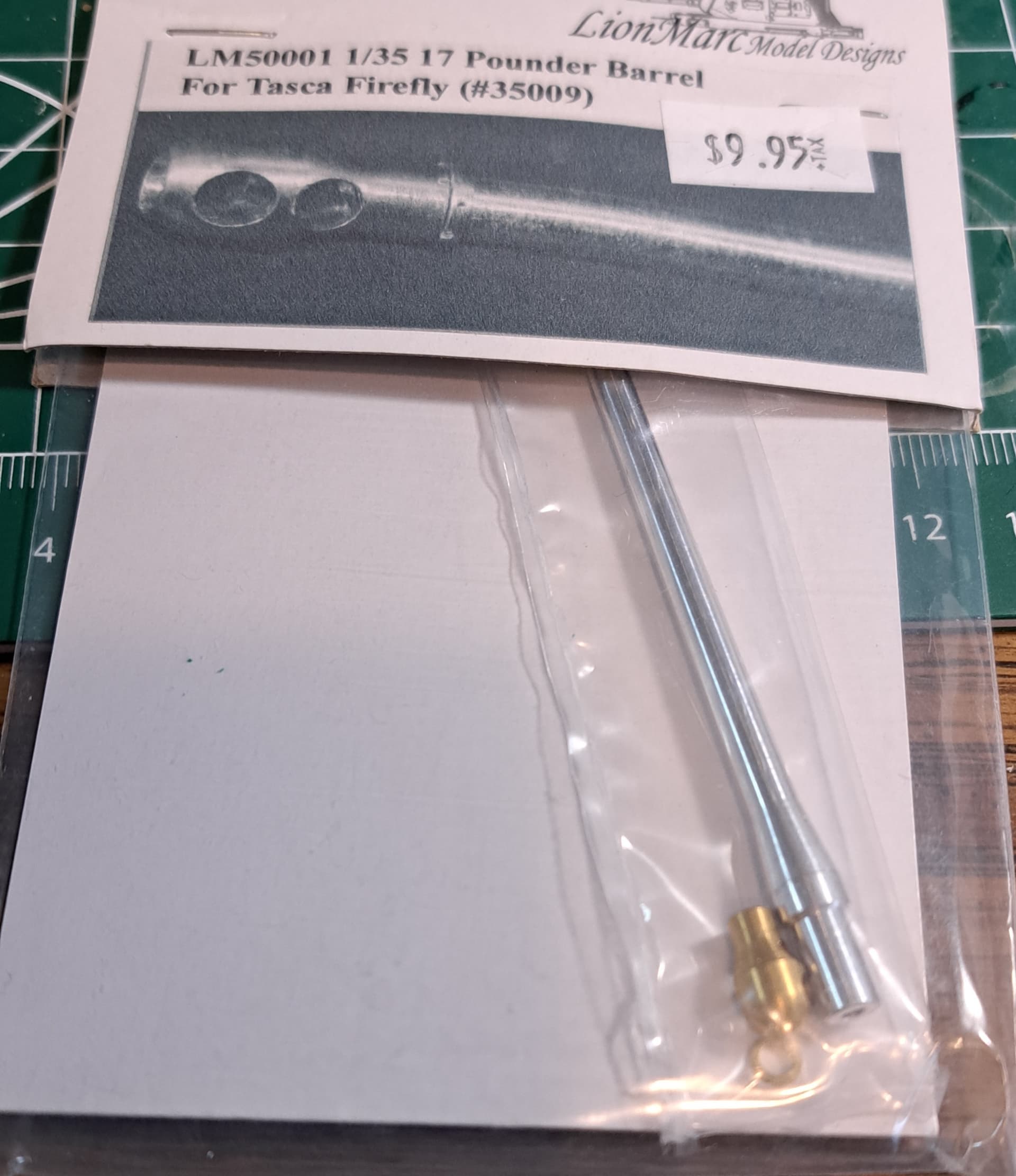

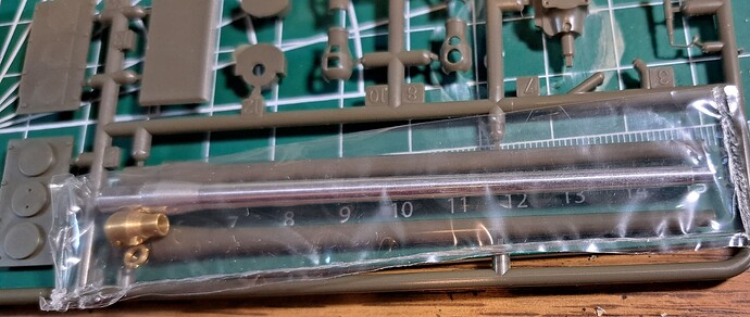

Good old long gone Lion Marc barrel helps faster lazy construction.
Compared with kit barrel halves.

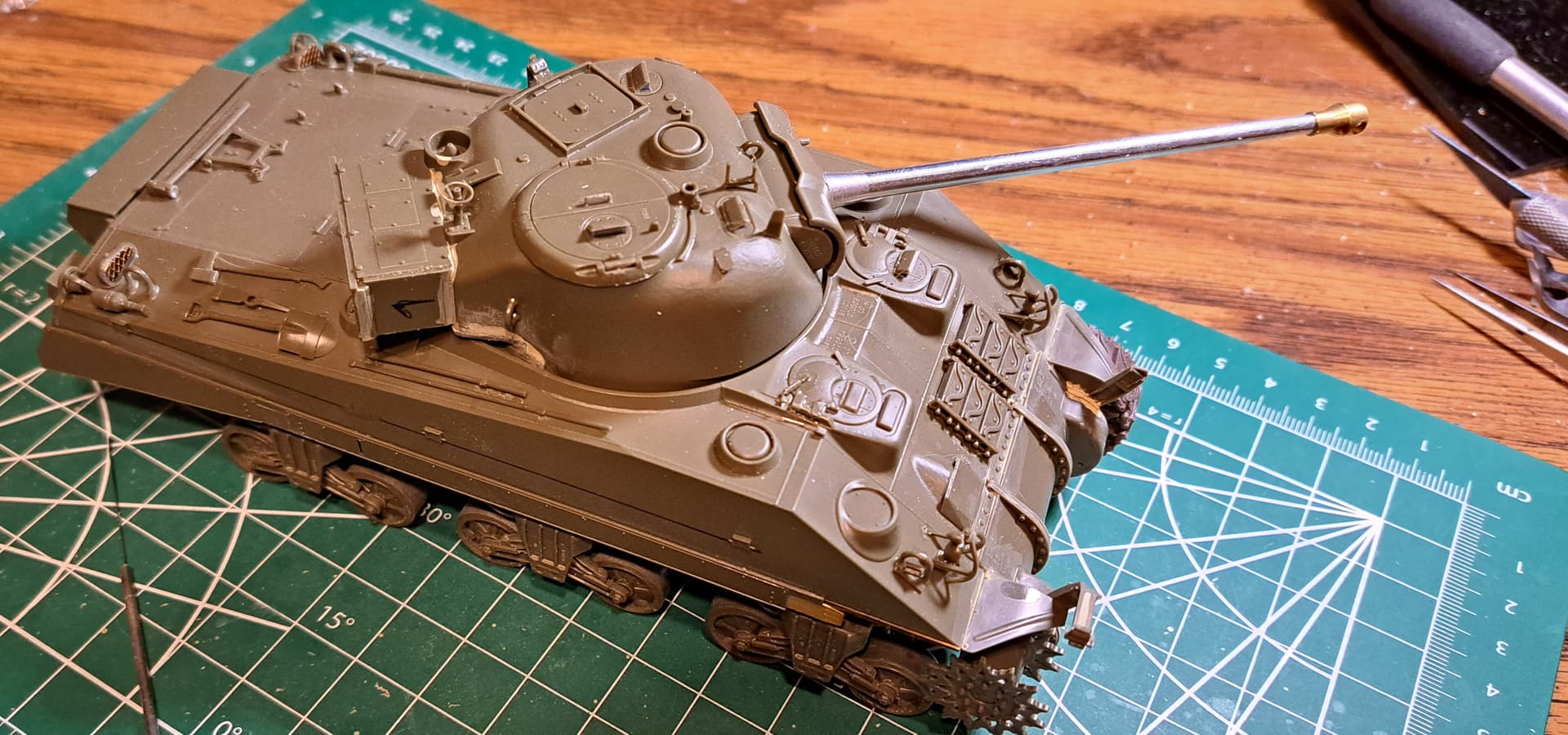

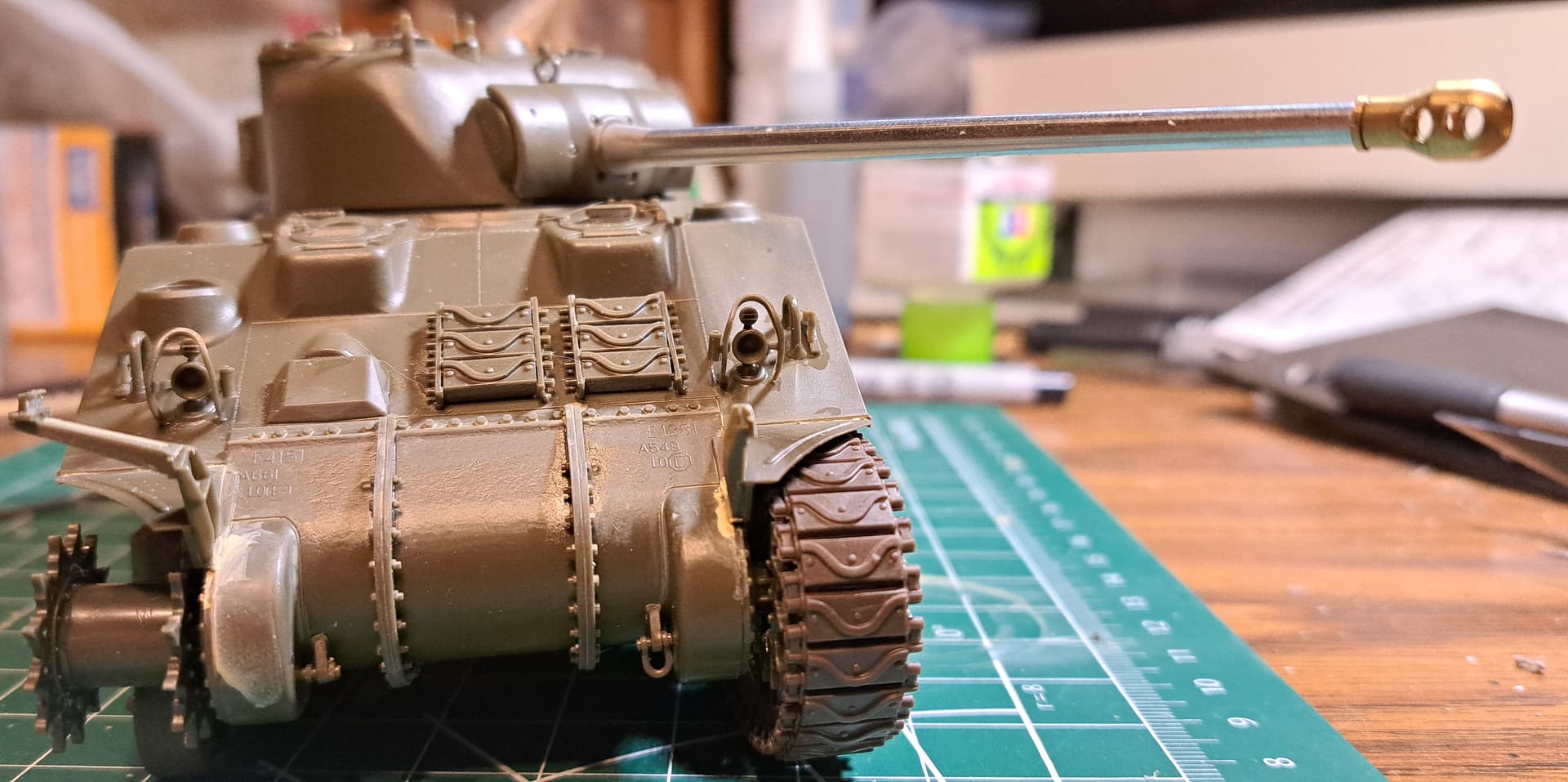

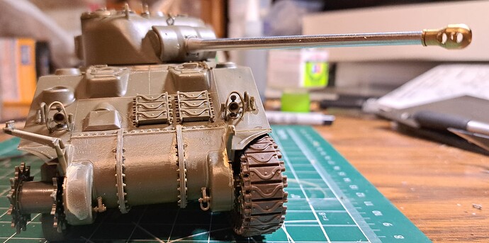

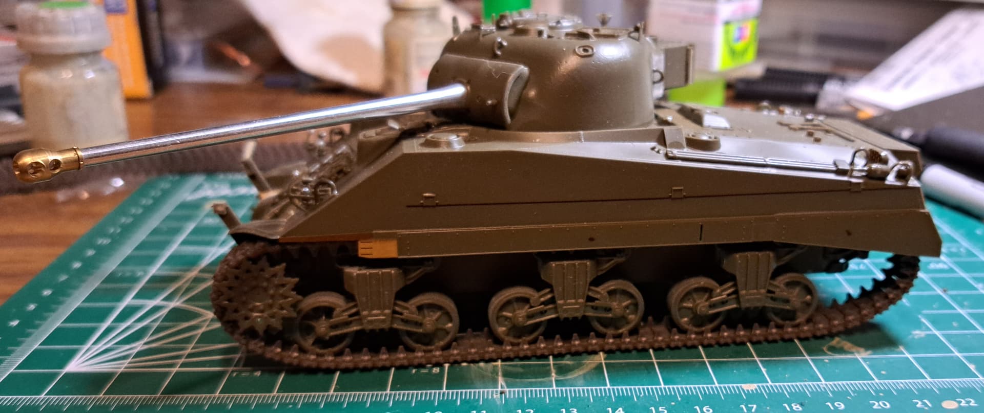

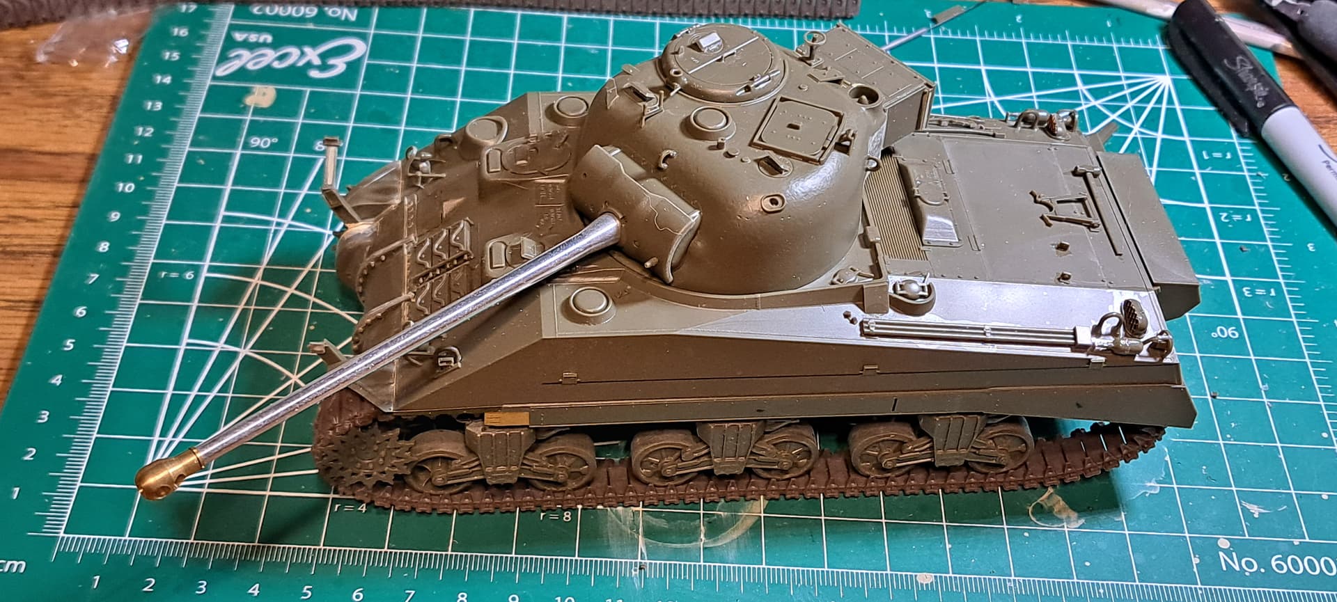

Tow cable, PE periscope guards still to install but overall construction is nearly wrapped.

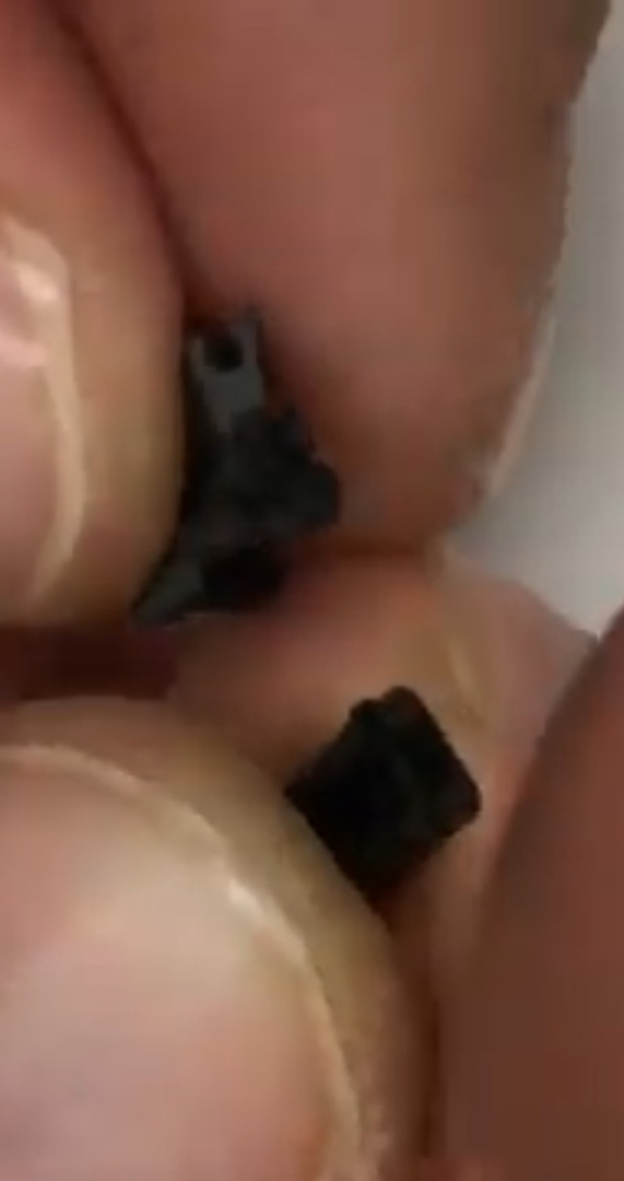

Haven’t decided if the rubber bands will go on or if QuickTrack T-62 Sherman track links will be purchased. Watched an assembly video and some parts look fragile. They are workable and snap together.

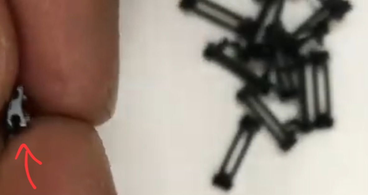

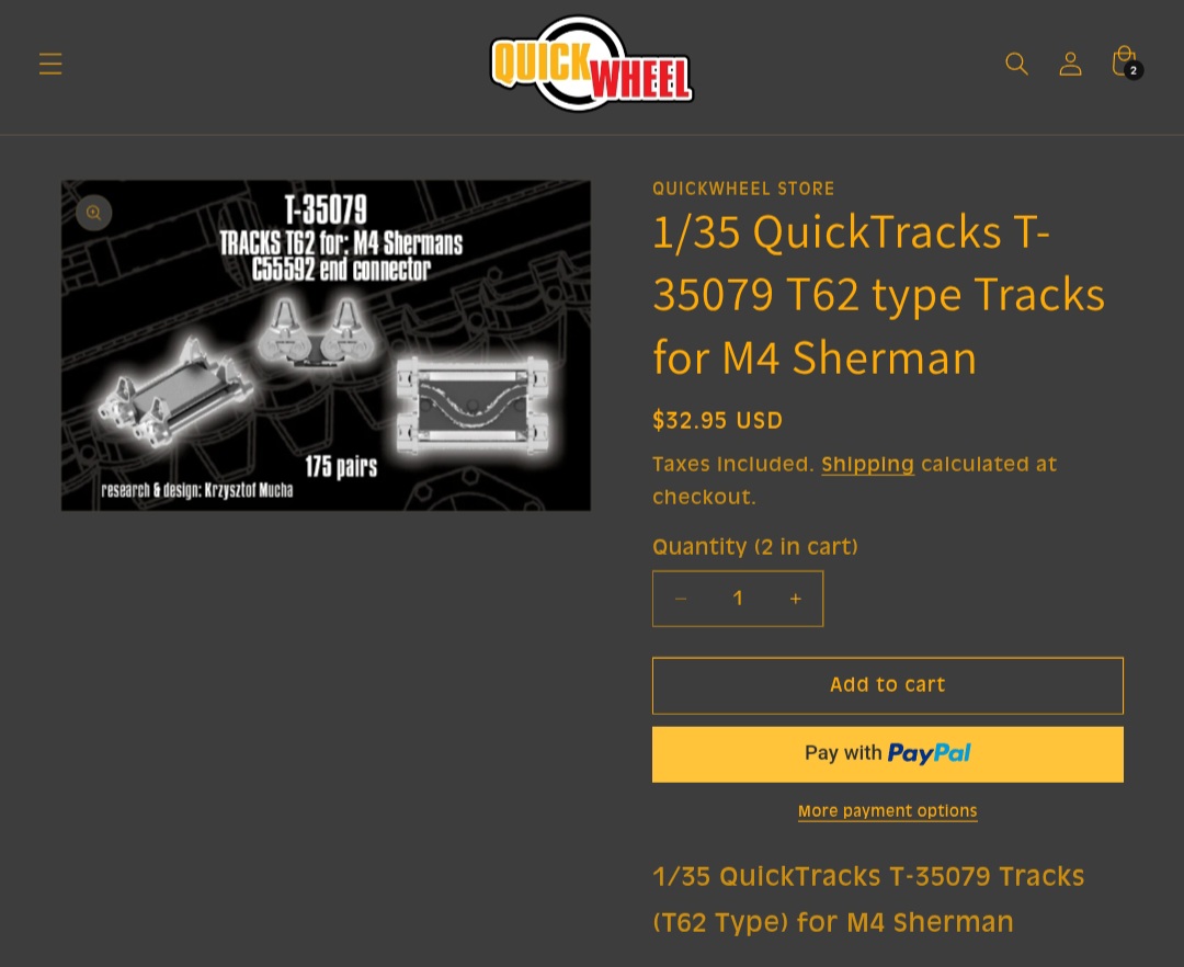

Aftermarket Sherman T-62 Track Dilemma
~$60 for TRex, slide in pins for assembly. Available in ~4 days. Had bad luck couple of years ago with TRex 3D parts, they became brittle very quickly. Acquitance same time period had problems with track sets being brittle & crumbling etc. Not sure about quality or longevity but that’s based on older information.
Anyone used TRex 3D parts recently?
Or
Quick Track click togethers are $33 but look fragile, especially that double pin assembly part. Available in a few weeks.
I’ve had good with QT Panther D tracks.

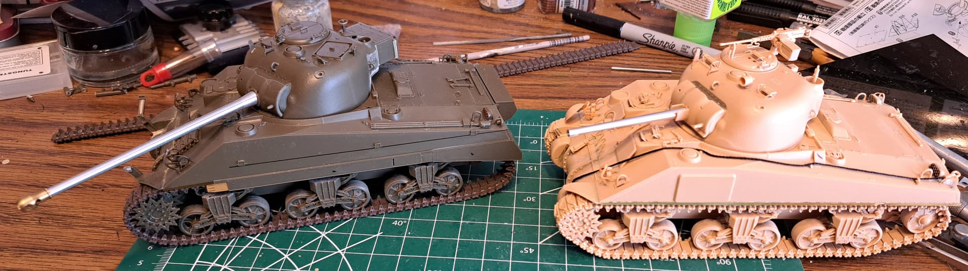

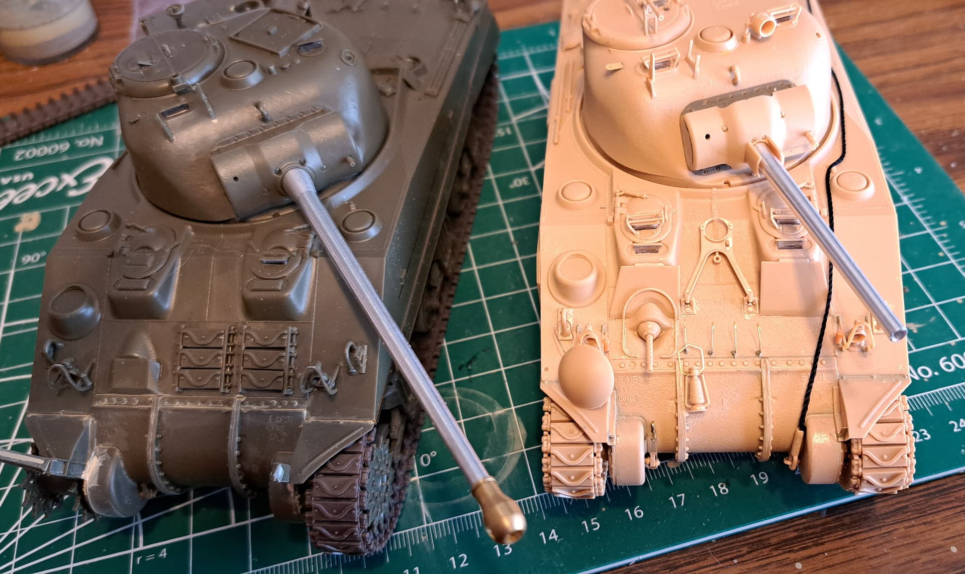

Turret vs turret, I like how the Tasca one built slightly better than the Ryefield one.
Ryefield 0
Tasca 1
Final Result - Absolute, time isn’t factored
Ryefield 5 points - win
Tasca 4 points
Other’s might favor Tasca and that’s a valid outcome based on what a modeler values most.

2 Instructions Tasca has nice innovation with numbered assembly sequence in a few steps but this kit didn’t get a dedicated Instruction sheet. What’s provided is a supplemental sheet to jump back and forth with factored by which of four possible vehicles is selected as the build.
That jumbled mess severely detracted from my build experience with the kit. For someone familiar with Tasca builds and Shermans this would likely be less of a factor.

Based on photos, for build #2 F50 & F51 might be positioned differently.

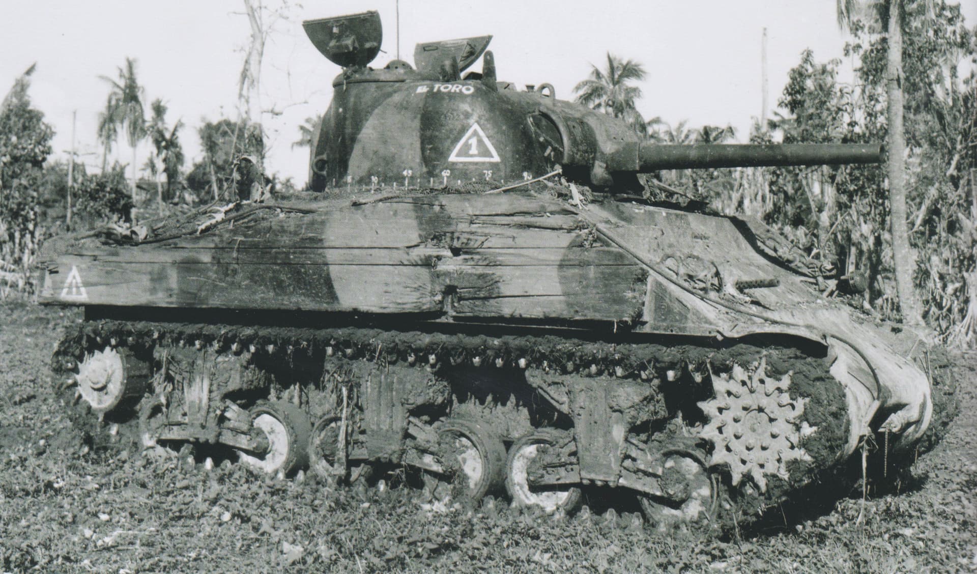

So they did use the wood armor on A2s?
My mind is terrible now I can’t keep information straight anymore. I thought the Marines used wooden armor on their M4A3s on Iwo Jima.
Improvised Armor on M4 Shermans in the PTO - Tank Encyclopedia
Both A2 and A3 USMC Shermans in the PTO had thewooden plank armor added to.
M4A2 ‘El Toro’ of the 22nd Marines was equipped with wooden panels. Here it served as protection from two 47mm shells which failed to penetrate the tank’s armor. Photo: Sherman in the Pacific.
A relatively well-known photo of ‘Davy Jones’, an M4A3 of the USMC 4th Tank Battalion. As well as the planks on the running gear, the tank has a number of improvised features, including spare track and upturned nails on and around the crew hatches. Photo: Sherman in the Pacific.
