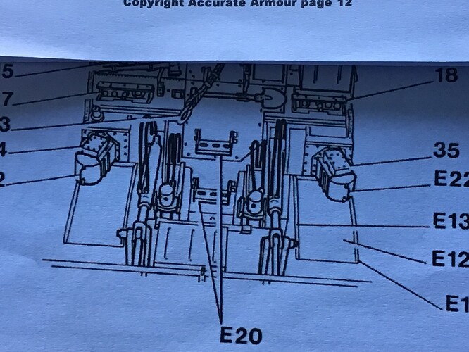

The propulsion unit (system) does work on the impellor principle - in that the propellor acts conventionally, but in doing so it pulls water in through the water intakes and the water is then pushed through the dowty cowls, which act to steer the vehicle in the water.
You can call each component or reaction whatever you like, as it appears the hicks in Norfolk have done, but I stand by my description. The water isn’t ‘jetted’ anywhere, its simply pushed (at about 5 - 8 kts - hardly a ‘jet’) through the cowls.
N.B. with the cowls closed as depicted in the previous snap shots, the vehicle would reverse through the water. With the control levers locked (by a pip pin) the default cowl position is closed. There is a handle supposed to be attached to each cowl externally. This was very handy to grab and pull onself up off the floor to mount the vehicle, but its actual function was to enable manual movement of the cowl to enable clearance of debris etc from the outlet.

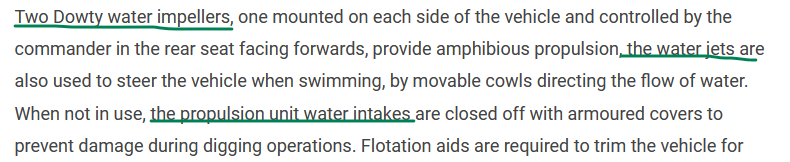

The hicks at Jane’s describe it thusly: “It is propelled in the water by two 330 mm Dowty 40/40B water jets which are mounted one either side of the hull” Jane’s Military Vehicles and Ground Support Equipment 1986
Okay, what do i know…
I do know that the propulsion units are not actual water jets.
Well, your description of the function was nearly exactly the definition of a water jet as used by boats, i.e. water inlet + some kind of pump which is usually an impeller + an outlet equipped with a steerable nozzle.
A further indication can be derived from the name of the cowls, Dowty.
Dowty propulsion units installed in the Stalwart
The propulsion unit is not a water jet, it facilitiates the creation of a water jet…
