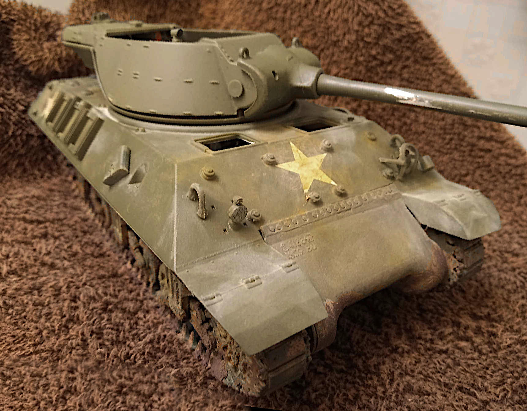

A recent work in progress: M36 Jackson.
Paint is Model Masters #1911 Olive Drab base color. Then Tamiya TS-80 Matte Clear (sprayed on very dry to give a bit of a rough surface.) Decals set using Future Floor Wax (get over it - because it works like a charm - FIVE STARS) Finally a light sanding of the decals and then final weathering using dry oil based pigments. (Soft oil pastel Artist’s colors.)
A little trick on that engine deck star. A touch of pigment (dirt/dust/ash) will create a dirty look that will hide the tonal differences between the white paint on the radiator cap and the white decal star.
Also a thinned black stain carefully applied to those engine grills can really make them pop. (Keep the model level while applying so the stain/wash does not run outside of the grills themselves.) Using a thin stain/wash will guarantee that the black flows into the spaces between the grill bars. Too thick a coating will leave the black sitting on top of the grill bars, which you do not want. (I used Citadel’s black shader - called Nuln Oil for this job.)
