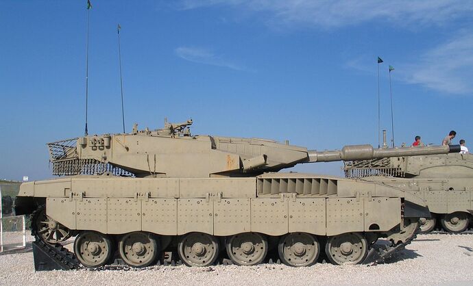

I believe it does represent a production version, but the turret is horribly misshapen on the right side. Compare the shape of the side armor modules below.
It’s a shame, because nobody else makes this same version.
That’s exactly my problem as well, there are no real alternatives, because all the manufacturers switched to the saucer turrets immediately and skipped over the flat early turret that still seems to be in use.
The right-side view is interesting. I think there are different types/combinations of side armor that went in that location, with the picture you have showing an empty one. I will try to compare that shape with the kit itself to figure out the overall flatness issue (I think the height of the turret is supposed to be the problem).

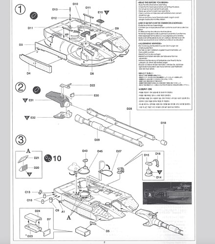

The interesting one is neither of these show the extra armor on the side of the sight (part D8 below), and all of the armor is flat rather than the uniform holes it has on the kit.

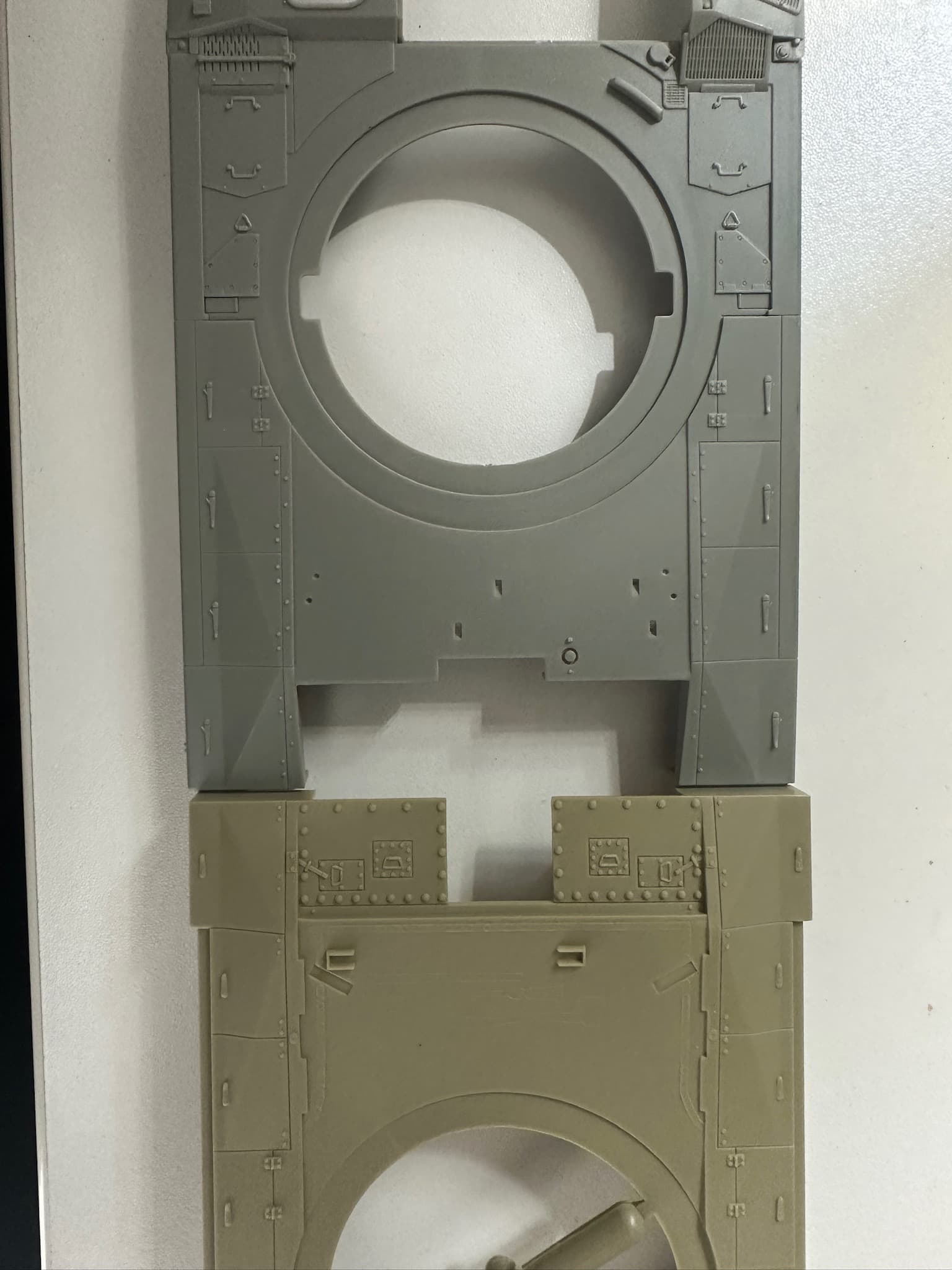

Not sure if the Meng kit is considered the standard for accuracy, but I am going to take out the caliper and compare the hull and basic turret dimensions of the 3D early kit with the Academy kit this weekend and post some photos. As a bonus, this Meng kit actually has the turret top and engine armor pieces as separate parts that I am going to use to duplicate for the Academy kits to create different variations of upgrades.

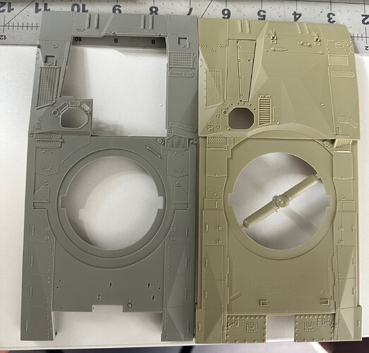

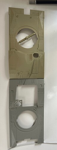

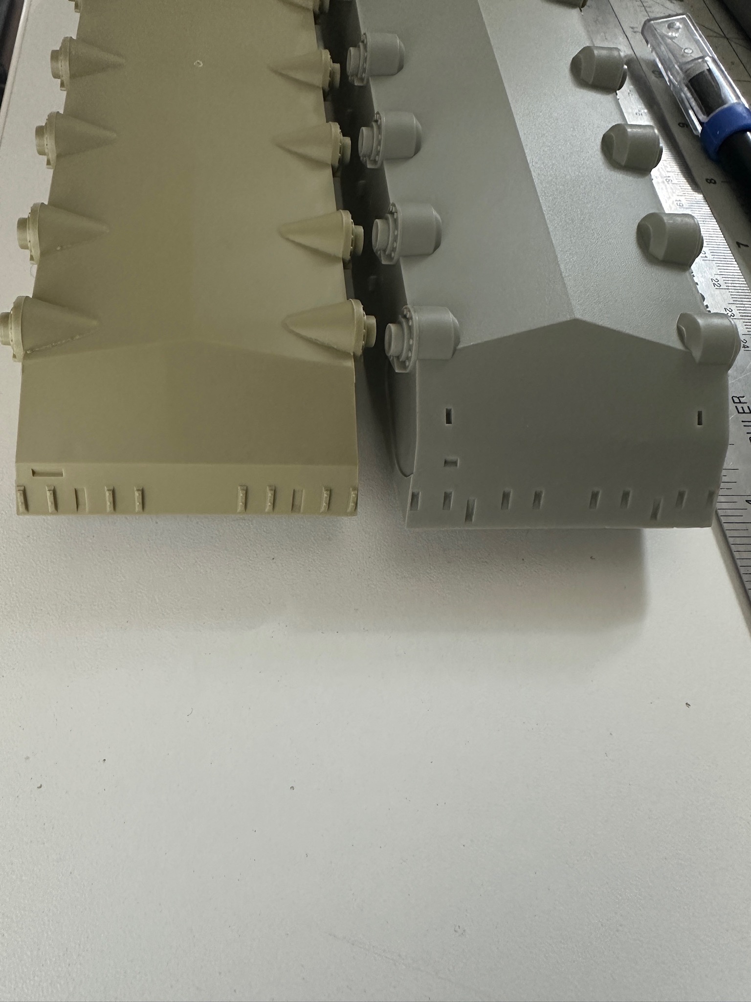

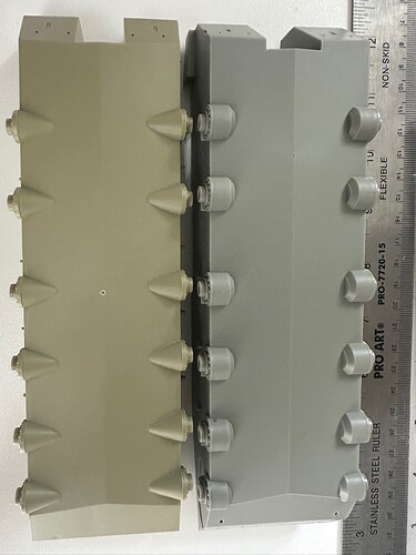

Some measurements and photos for the hull first (and again this is just a comparison between the kits, and does not assume one or the other is accurate)…
The width of the hulls are only off by 1.96mm according to my calipers, the Academy hull coming in at ~103.94 and the Meng at ~105.9. and the length is off by ~1.5mm (211,5mm vs. 210mm), but it is difficult to measure because the front taper is built differently (see photos).
And looking at side by side photos, the major components and panels actually almost match (please note the Meng hull has a separate engine deck).
Deniz

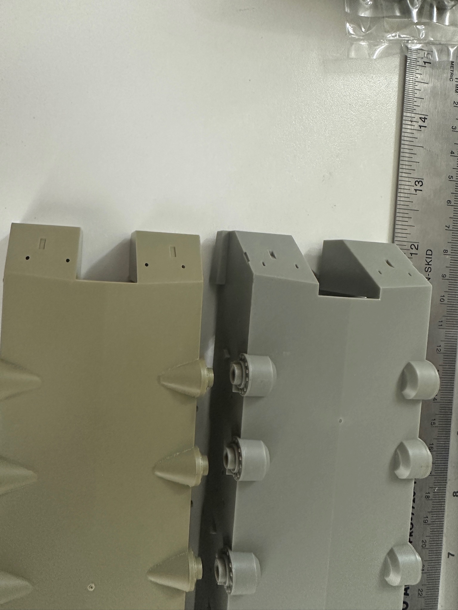

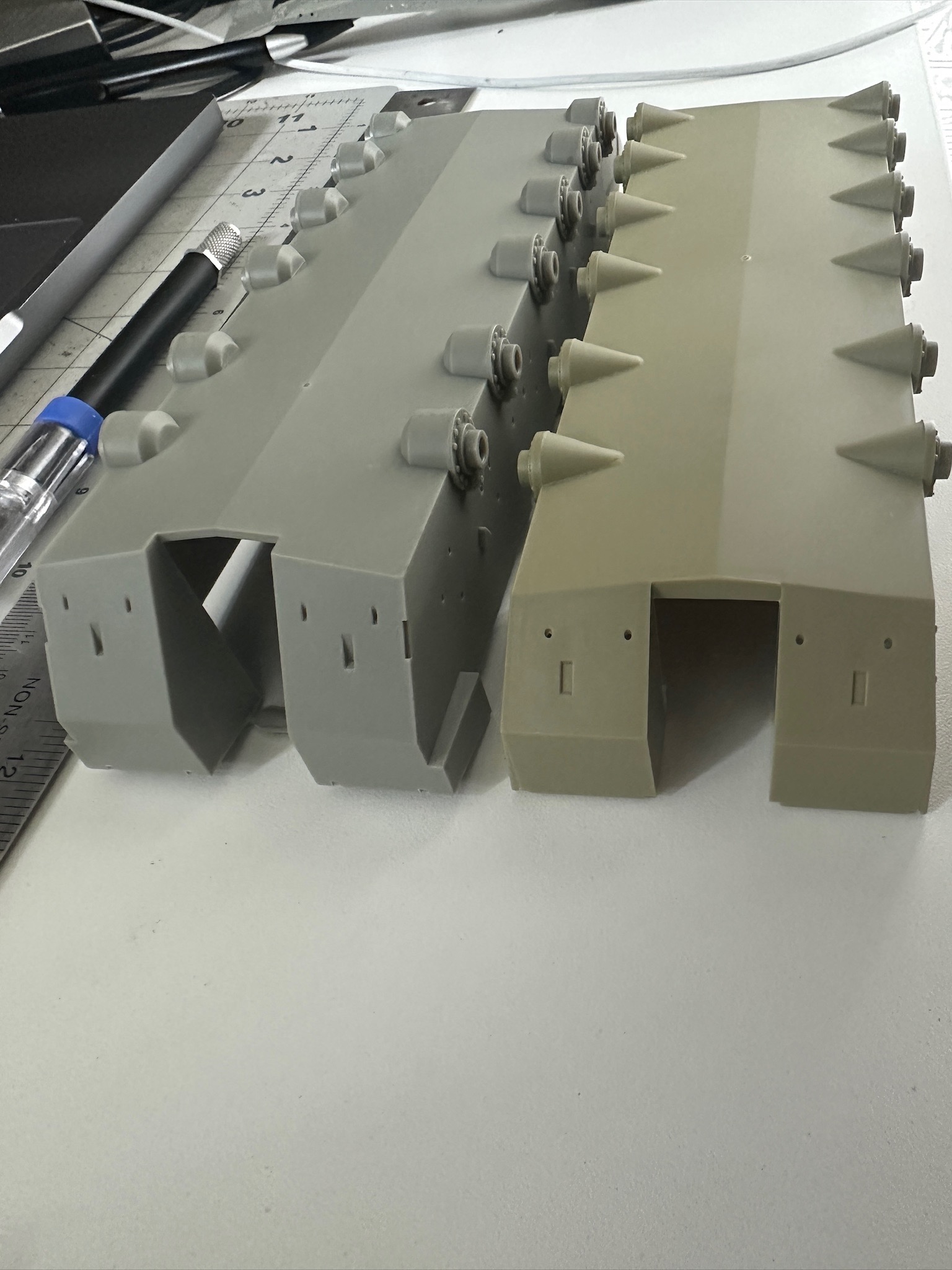

The bottom is more difficult, because the geometry is different; Meng’s hull is built higher, but the angles of panels match quite nicely (except the very front panel of Academy is maybe tapered a few degrees tighter). The only thing I don’t like is the Academy’s wheel blocks are cone-like vs. cylindrical (see photos again). It might be different production batches, but also Academy might have simplified/made it up because they might not have seen the bottom of the hull. I might try to shape the Academy ones better by cutting off the end of the cone.
Deniz

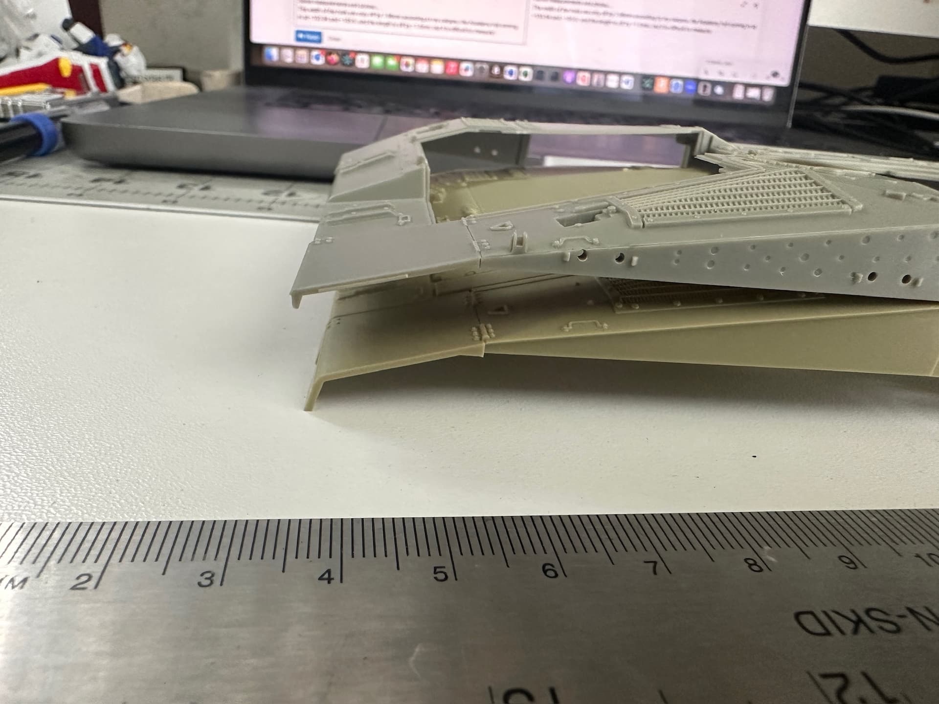

The photos I posted are a bit misleading. I think it is the second to last wheel that is 1-2 millimeters off - closer to the last wheel, when you align the front of the lower hulls (alignment is really difficult because of the different geometries of the hull parts). I am more bothered by the shape of the wheel mount (half cone vs. half cylinder), and I want to check if that was a production change or completely made-up.

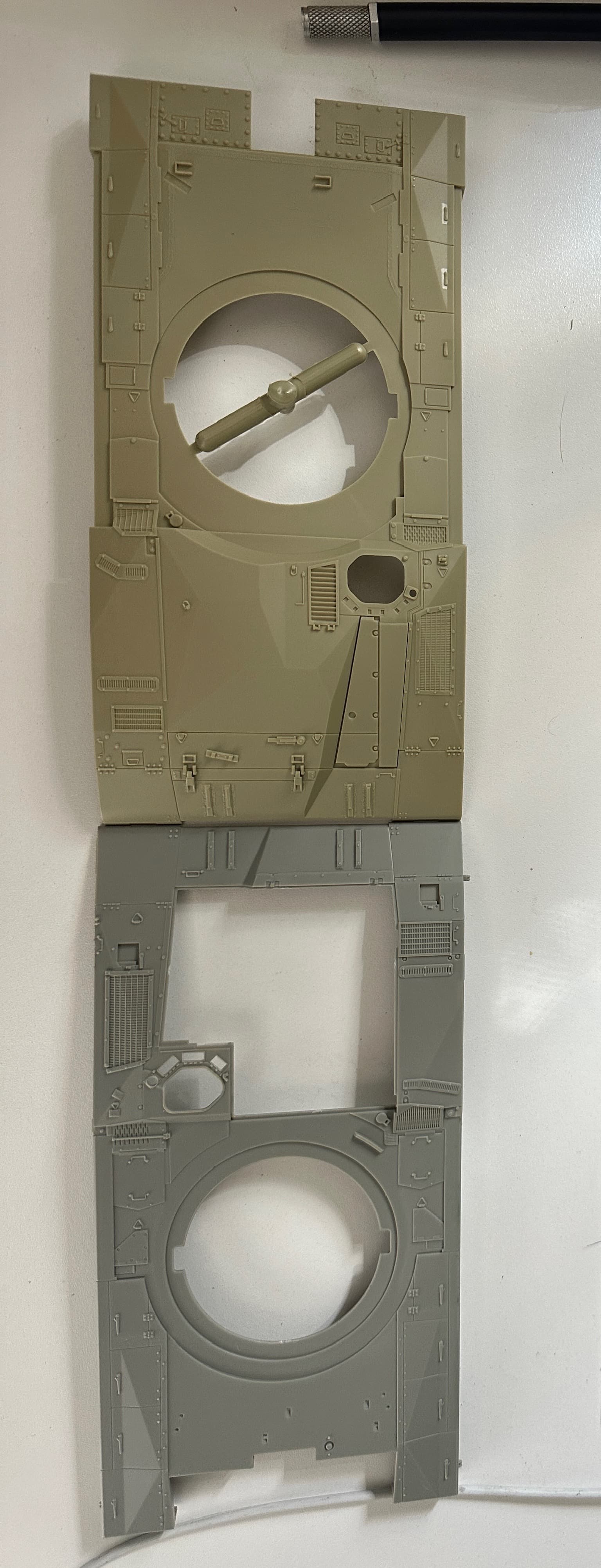

If you’re okay with taking a knife/saw to what’s in the box, this is where you could start: Cut away the RH turret armor module (keeping it intact if possible) score a bend in it roughly where the white line is, then re-fit it with the front part angled downwards. Once you’ve fixed the roof, then you’ll need to reshape the sides to match.
While you’re at it, the coax slot is too shallow, so extend it backwards.
This is from memory - I started on the same project a few years back, but it got lost in a house move. Probably somebody on this forum can give you more accurate guidance.

Thanks for the drawing and the instructions. What did you mean by fixing the roof - adding the roof armor or something else?
Deniz
No, I should’ve said ‘upper turret’ or similar - just fixing the part in the picture. Point is, once you’ve done that you still need to fix the shapes of the RH turret side pieces.
