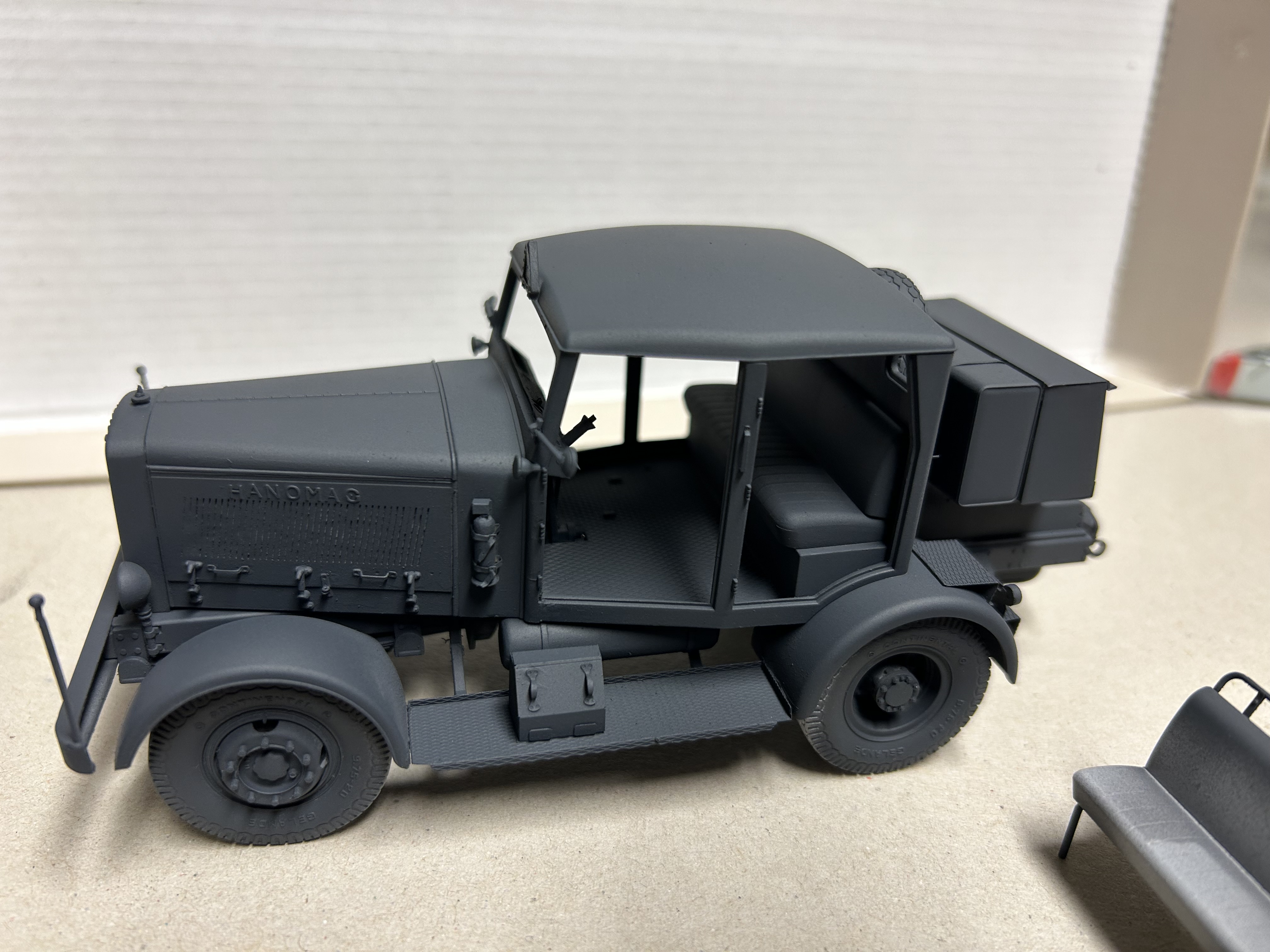

Grau 7021
And the owner sits in the back minding his business, probably just reading something. Very nice shop, not far at all from the center and hte Osnabrük Castle.

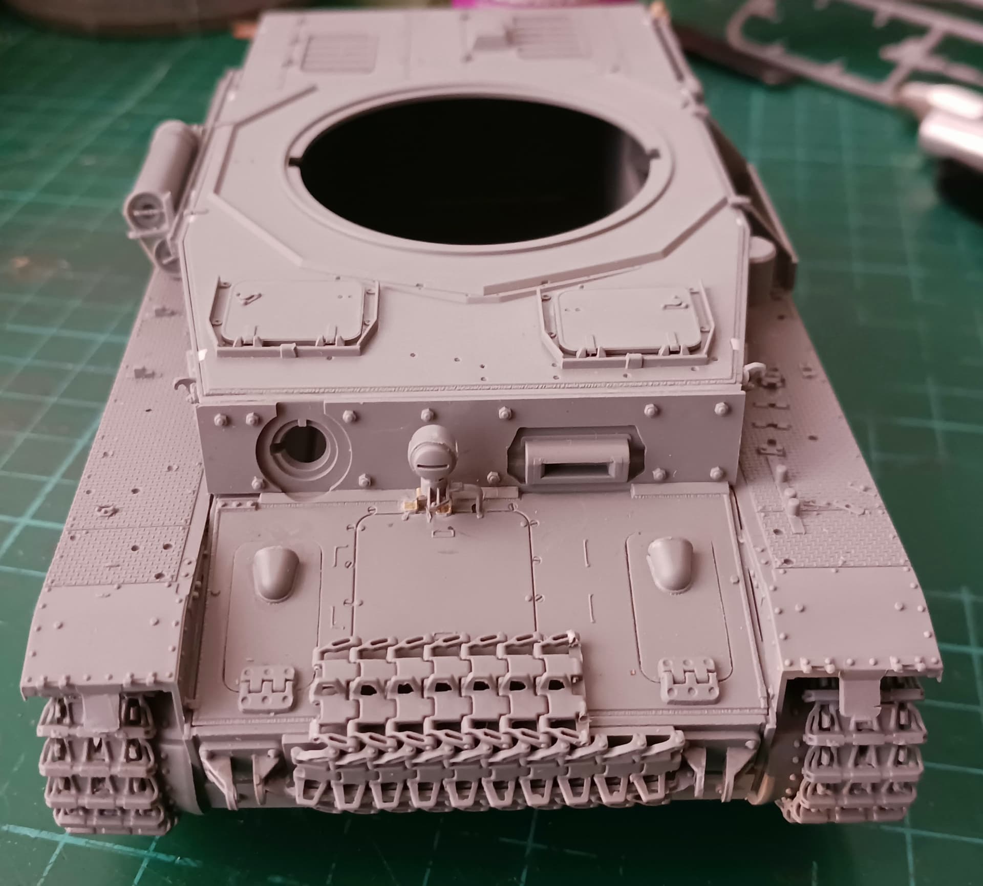

I am slowly building my Krupp’s June 1943 Bulgarian “Maybach” from Border #BT-001.
Took the Filzbalgvorfilters from the spare box(MiniArt) and made the bracket for the centrally mounted headlight(a Krupp specific feature from May/June 1943) from PE leftovers:

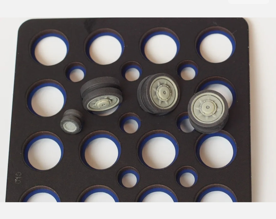

My method for painting wheels, especially Pz IV.
Airbrush the centers, assemble inner and outer wheel halves.
Mount a piece of sprue in a low power miniature drill (a Dremel is WAY too powerful).
Run the drill and file the sprue to a cone. The cone needs to have the diameter of the axle hole of the wheels somewhere between the thick and the thin end.
Adjust the cone until a wheel can be pressed on to the cone.
(Save the cone for the next Pz IV …)
Mount a wheel on the cone, run the drill at the slowest speed, possibly braking it using the thumb of the hand holding the drill. Adjust the wheel until it doesn’t wobble too much, i.e. until the Mk 1 eyeball doesn’t detect a wobble anymore.
Use a small brush to paint the dark rubber on the wheels. Start from the outer edge and move the brush slowly in towards the centre. It took me about 15 minutes to paint all the wheels on a Pz IV.
Making that cone the first time took 15 - 20 minutes, save it for the next kit.
The cone should be nearly cylindrical, a smaller angle works better.

FWIW - I tried a QuickWheels mask for a Panzer IV recently. It worked very well and is reusable. The 1994+ Tamiya wheels fit fine in the Dragon mask. Not sure if QW has a MiniArt specific one.
