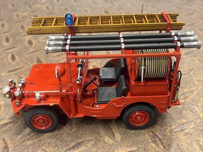

Ok, now we are getting to the sharp end of the build!
Wheels are on, crazy blue disco light is on, hand-held extinguishers have been detailed (dry fitted here), spare wheel is on, tail lights and front guard reflectors are on, horns and wipers fitted to the windscreen frame, exhaust system and bash plate fitted underneath, and finally battery, relay box and horn fitted to engine bay.
Some more touch-ups and detail painting next, then the final few parts to be fitted and a light PLW to tie it all down.

D,
WOW :ok_hand: :ok_hand: :ok_hand:
I’m just blown away with those 3 ladders. just super impressive as is the whole build. Great subject which peaked my interest from day 1.
Can’t wait to see it finished and proudly on display.
joel
@Joel_W thanks mate! I’m very happy with the way the ladders came up. I might give them a light sand and Dullcote before I glue them in place.

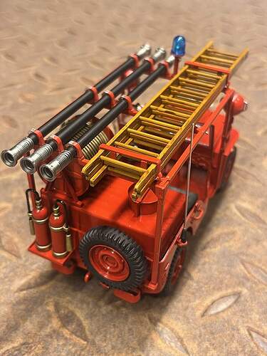

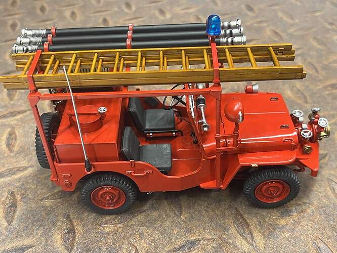

I’ve managed a little bit of bench time to inch the Fire Jeep closer to completion. I have added the front manual spotlights to the frames, fitted the driver’s side mirror, fixed the ladders in place, and touched up and mounted the hand-held extinguishers on the back. I also added the radio antenna to the relocated mounting frame on the passenger side. This was not actually meant to be used in the Fire Jeep build as the mounting bracket should be where the back extinguisher base is, but it looks great and I found a bare patch of side to add it to.
The last couple of items to finish the Fire Jeep are the hold-down brackets for the ladders (which are painted and curing), paint the rubber buffers on the hood, and a light pin wash to give it a lightly-used feel.

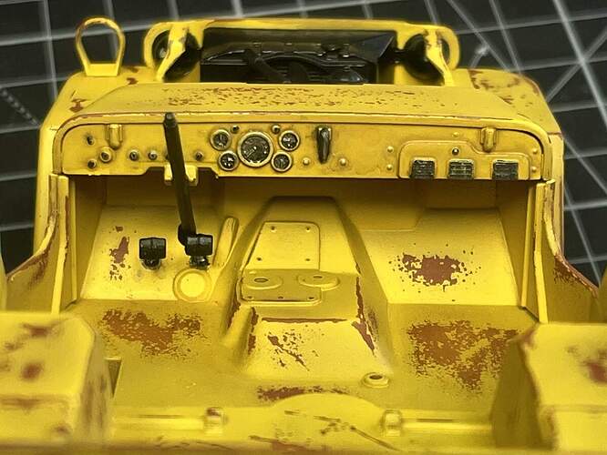

I also did a little more on the Farm Hack, I used a spring clamp to hold it vertically on its nose and gave the instruments a drop of Aqua Gloss, and once that was cured I gave the dashboard a light filter wash with Tamiya Brown PLW. I will clean this up and refine it a bit with some white spirits later.

The fire jeep is coming along great. All the colors look spot on.
Thanks so much guys, really appreciate the feedback!
I decided to knuckle down tonight and get the Fire Jeep completed. It only took an hour or so to knock over the last few tasks, plus I used the Tamiya Weathering Set to tone down the black a bit more on the tires with some grey.
Completed Build #6 for 2022 is now in the display cabinet!
