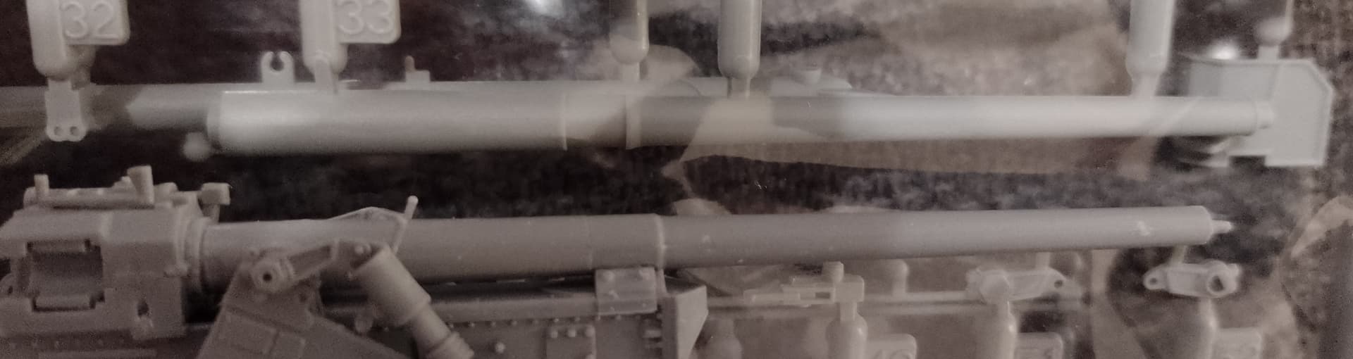

There has been some progress on the gun cradle. I have noticed a difference in lengh of the Miniart and Dragon gun barrel, the Dragon one being longer. I will have to look into this aswell.
Maybe when you attach the muzzle brake it will add length to it.

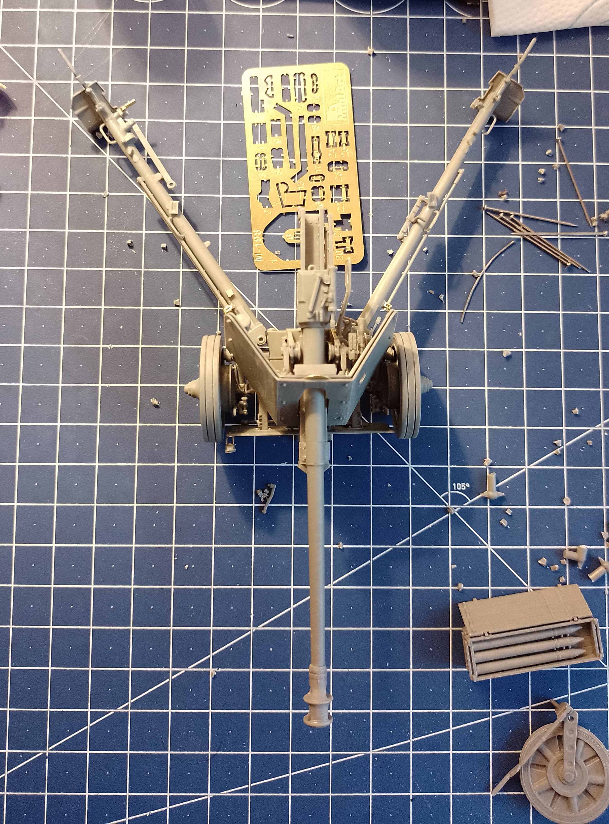

So the construction is done. I left out two small pieces because I coulnt fit then and also two PE brackets, too small for my fingers. As for the third wheel it has a different attachement on PaK40 then PaK38. I will reserve the final judgment of the kit after I have used the decals. Im still not sure about the lengh of the barrel, it might just be the perspective of most of the 1:1 pictures. I left it as is.
A little update. After looking at more pictures and more measuring, I do believe the barrel is too short. I added a small piece of sprue to the end (miniart sprue has actually the right diameter). After curing The muzzle break will come on.
The new barrel is done and im happy with the results. What I think happened is that Miniart calculated the barrel lengh L46 with the muzzle break.
Looks like a beautiful kit, very detailed.
I agree barrel length now looks more correct!
