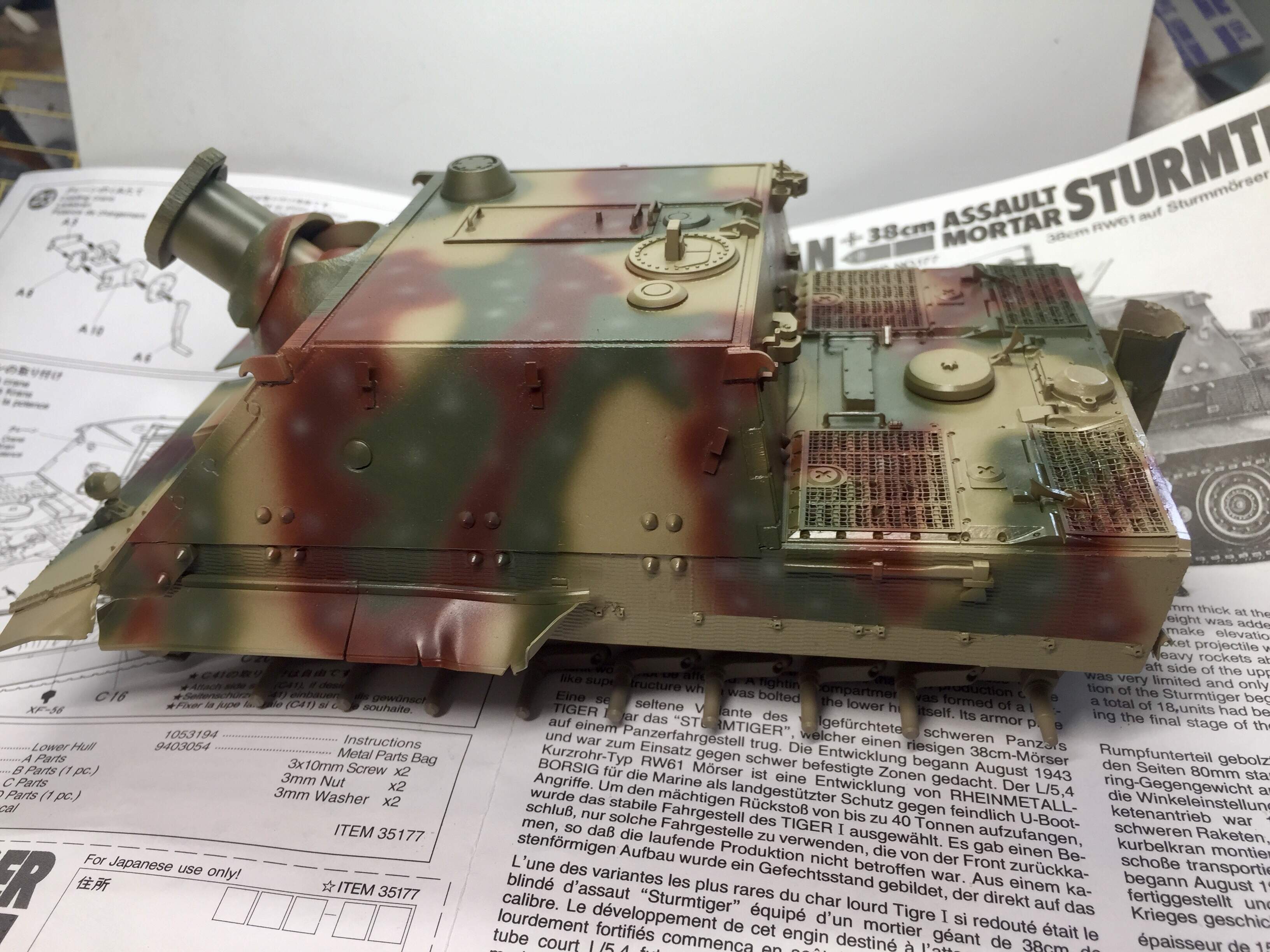

Ready for paint
Camo done. Subtle “Ambush” scheme
Liking the cam finish on it. The faint ghosting of ambush cam gives it a nice old and worn look.
An awesome build and now fantastic paint job Tom.
Looking amazing!!! :smile:
