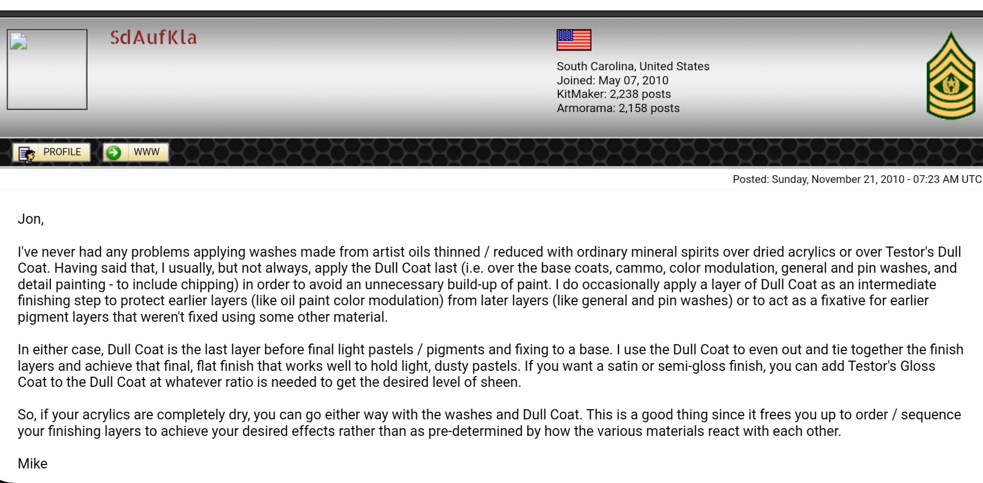

Greg, I don’t use Testor’s Dullcote but this old post from Mike may help.
Please see thread for details.
Oils Over Dullcote
HTH,
Wade
Never would have thought of that, I’ll keep that in mind
As far as I know odorless thinner will not attack dull cote.

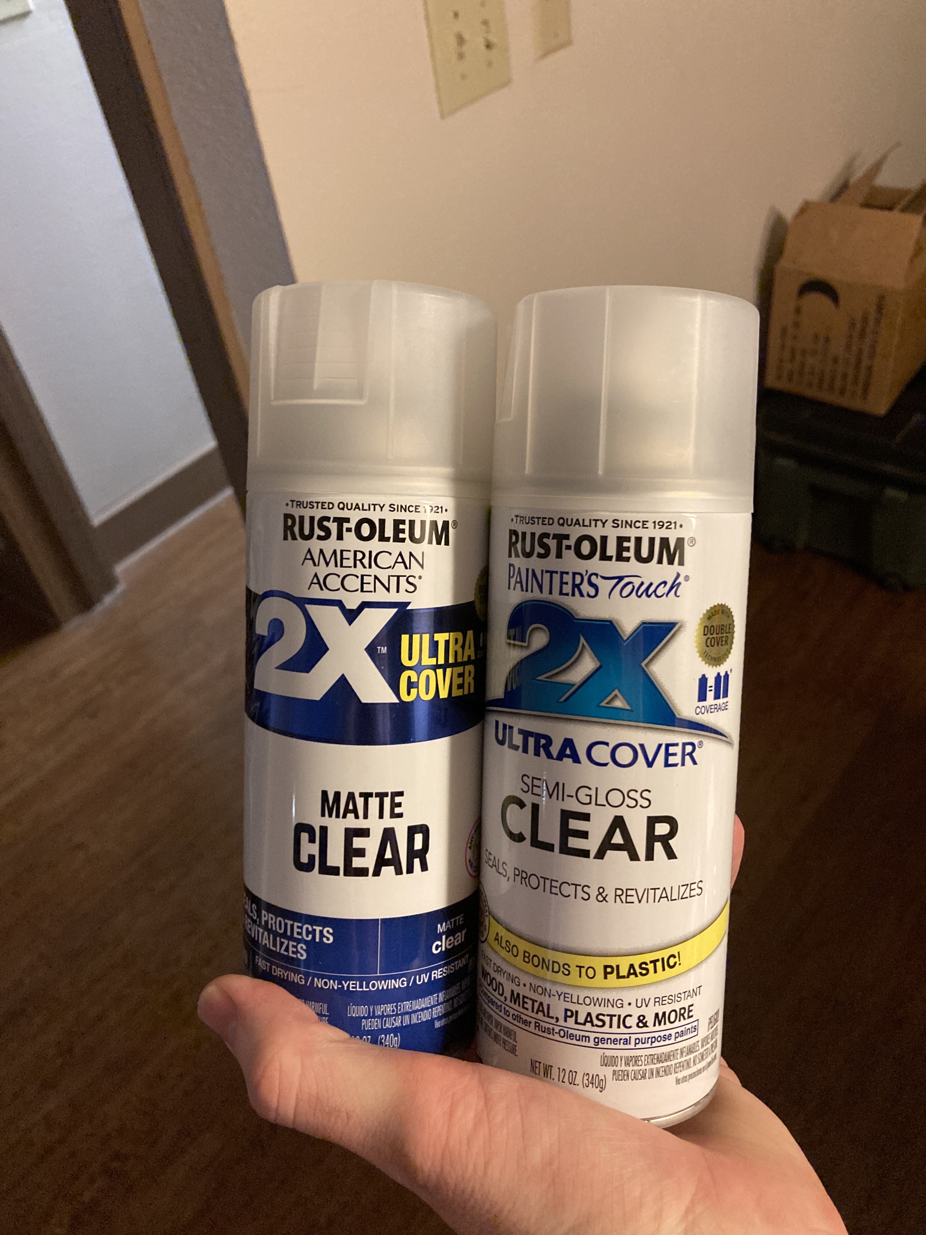

For reference sake, these are the only spray coats I have. I do have the brush on Vallejo matte and gloss varnish (could those be airbrushed? Never thought of that). I’ve only done models for tabletop games so these have been fine, but didn’t know if they’re good for models
What is the odor like with the RUST-OLEUM products? I ask because my experience with their Black Semi-Gloss Enamel has been that it lingers-on forever.
I’ve airbrushed Vallejo Gloss (70.510), Matt (70.520), and Satin (70.522). Just looking for a cheaper alternative for spraying larger areas now.
—mike
The aerosol smell lingers a bit. Certainly don’t want to do indoors without good ventilation. I spray it either on the porch or in the garage.
And that’s good to know that I can spray via airbrush if needed, but I agree it wouldn’t be cost-effective
That is 100% on the money with Quick Shine.
I had a detailed conversation with one of our local IPMS club’s serious top aircraft modelers about clear coats last month. Quick Shine proved far superior to all of the other stuff out there like Alclad’s AquaGloss etc.
It doesn’t say anything on the cans, so my estimate would be that these are enamels. Since you have an airbrush, you might want to run down to Wal-Mart for a bottle of Quick Shine.
