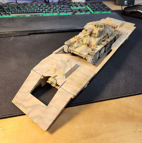

Okay, I actually finished the last two rail cars back at the end of June but got deep into some other campaigns and did not post final pics:
The Cyber Hobby 9118 Schwerer Plattformwagen Typ Ssy
The Takom 35A02 Schwerer Plattformwagen Typ SSys (Actually Sabre packed with a Takom Jagdpanther)
Trumpeter 01508 Panzerträgerwagen with Pz.Kpfw 38(t) Ausf. E/F
I still plan on building the ‘continuous’ track so all of my railway vehicles will be linked as a display but after test-fitting and measuring I will have to fine tune my original idea to account for the slight differences between Dragon/Trumpeter and aligning everything.
Here is its current state:
