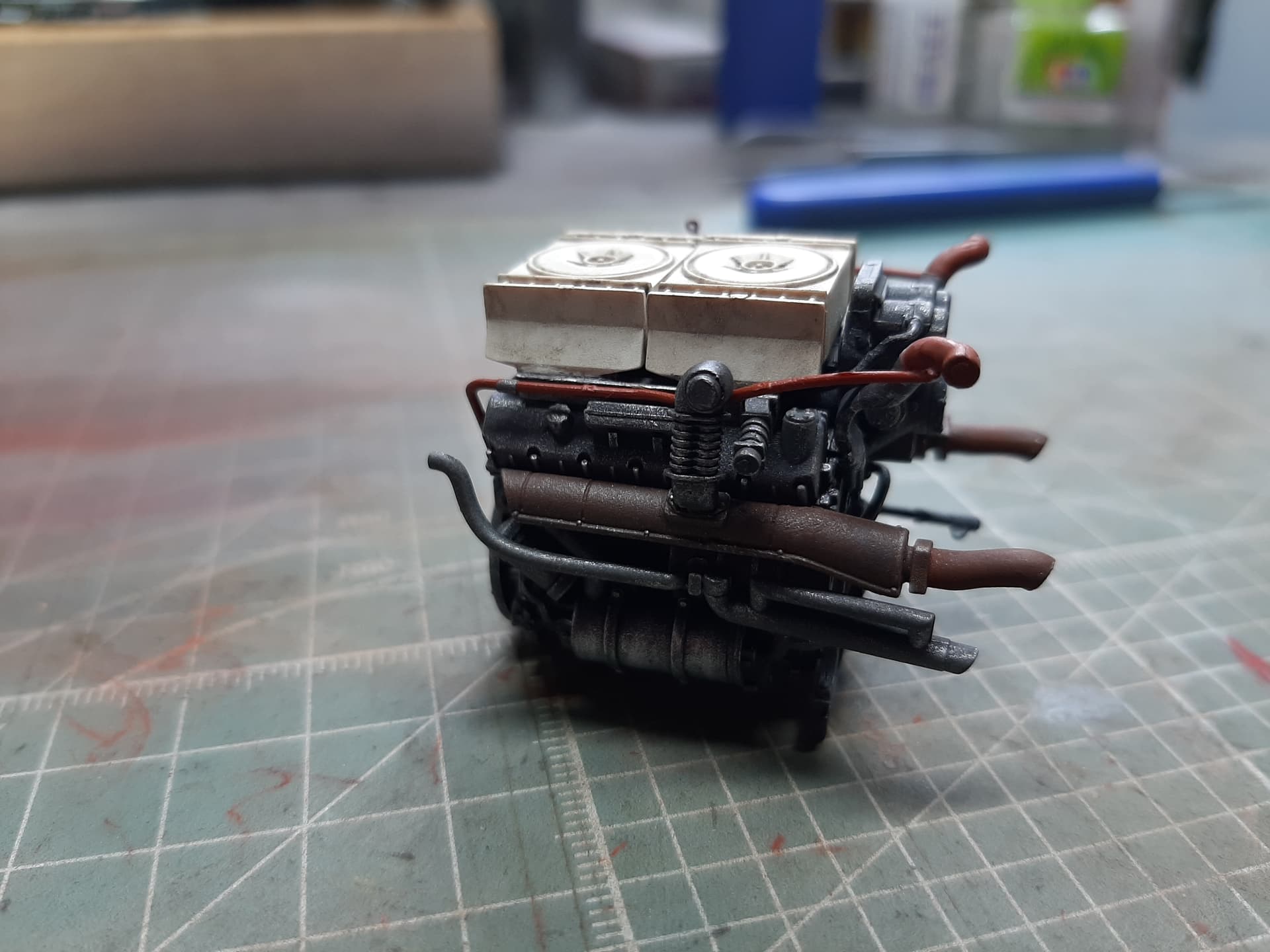

This is subjective but this is how I do ALL German engines in 1/35 scale.
  1. Base cote of satin or matte black.
  2. Gentle over spray of RLM66 (Schwarzgrau).
  3. Very gentle over spray of Mig Dark Tracks (this is very dark brown colour - if you don’t have it, mix some matte brown with some matte black to achieve the desired effect).
  4. Dry brush with oily steel/polished metal.
Panther Engine I did:
