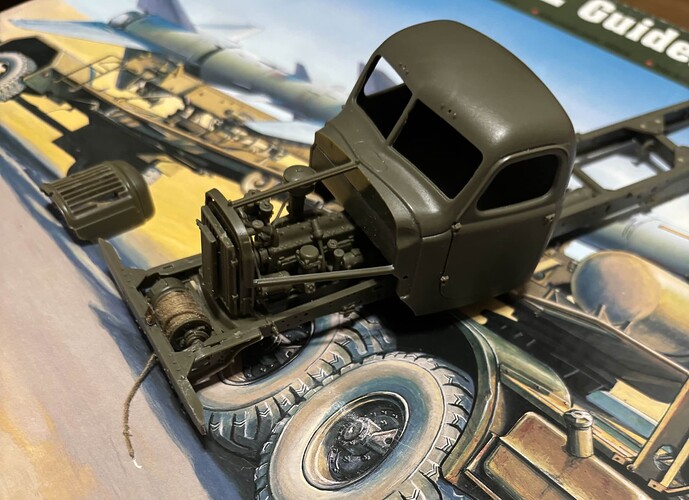

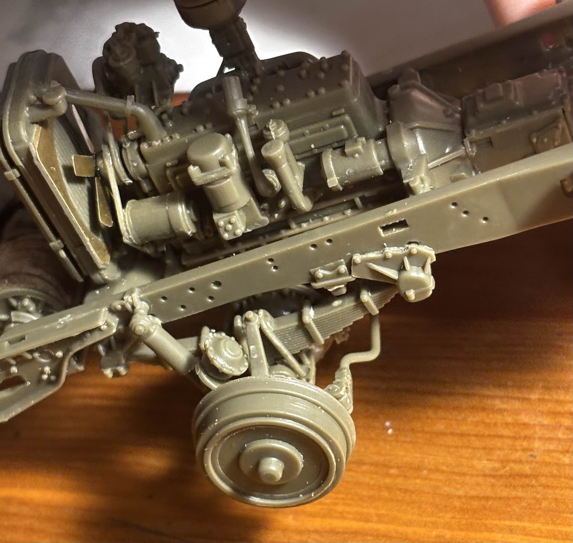

I’m gonna have a Sho’t Kal Alef driving past a destroyed Zil-157 based SA-2 missile carrier, and I’m planning to set it in the late end of the war (like around the western Sinai or in Egypt). I’ve got the Trumpeter SA-2 Guideline Missile on Transport trailer with 2 Eduard photoetch sets for both the truck and trailer. Here’s about all the work I’ve done so far:
I’ve got multiple reference photos for the Zil-157 but I’d like to have it damaged but not entirely burnt out, I’ve bent and damaged the front grills a bit and I’d like to add bullet holes whenever I can.

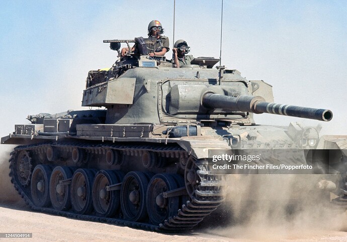

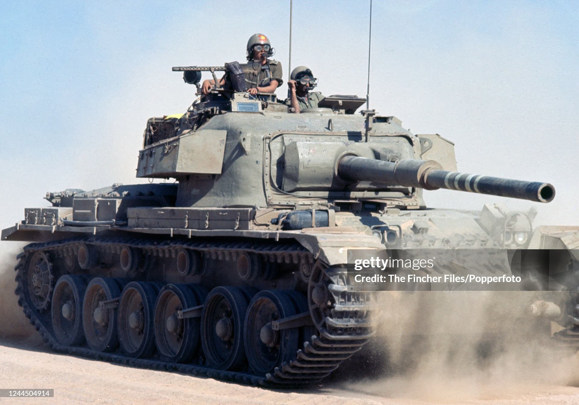

For the Sho’t Kal, I’ve got this Amusing Hobby kit I’ve been neglecting, It’s not in the best shape but I think I’ll be able to complete it. I’ve got this reference photo that I’d like to base my Sho’t Kal off of in essence, according to gettyimages this photo is based near or during the IDF’s advance into egypt, but I’m not sure if its so trustworthy (I kind of wanna believe it since It’s got the yellow friendly identification tarp on the turret basket).
I’d possibly like to recreate this Sho’t Kal’s mantlet cover, the mg bullet impacts on the mantlet, and the flower painted on the commander’s helmet (I’m still debating this one). I know of about all of the Amusing Hobby Sho’t Kal Alef’s flaws and basics in 1:35 model building, but if anybody could have suggestions on the scene, vehicles, or even tips on working with photoetch or making my first diorama, I’d really appreciate it!

Thanks for the all the feedback!! I really appreciate it! I’ll be sure to focus on the kits first, especially the Zil, it’s definitely a big kit. I’ll be sure to post more updates soon, I’ve been working on it as I’m writing this. Honestly, the Trumpeter kit has some pretty good detail and tricks up its sleeve for a 2003 release. :+1:

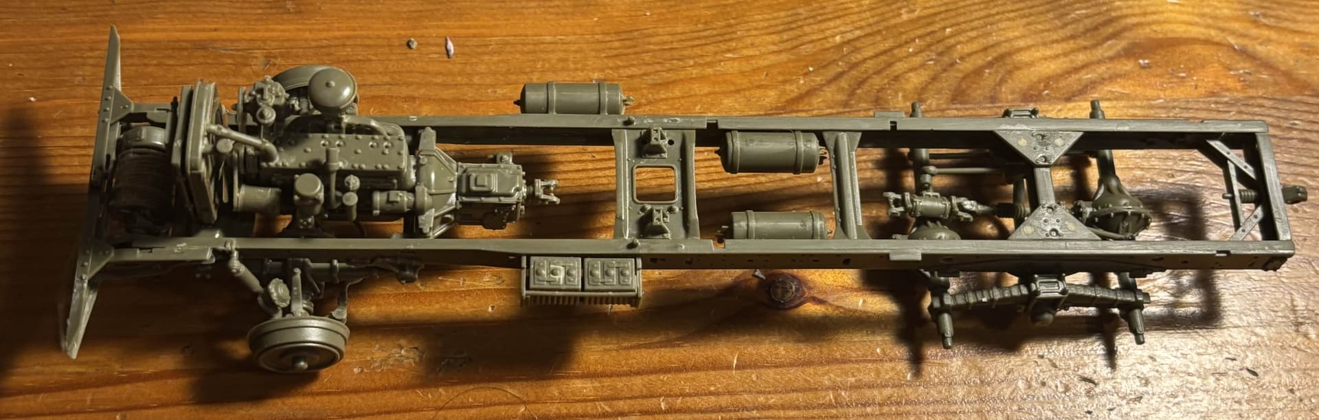

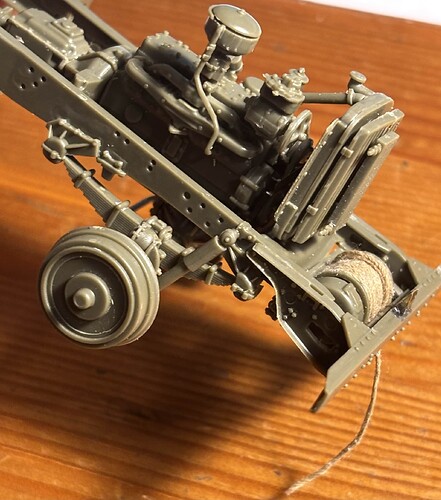

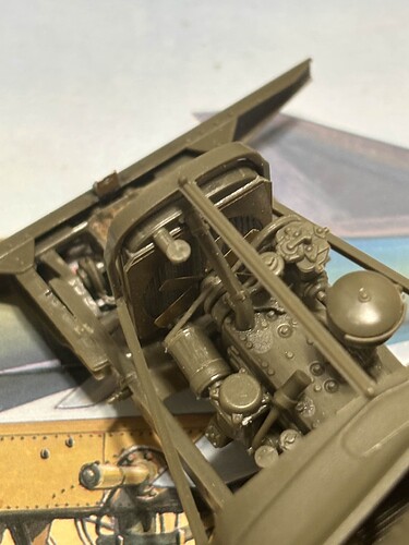

Final update for the day, I’ve been working on the chassis a bit more. Like mentioned earlier, the detail of this kit is honestly pretty surprising imo, It’s been building up pretty easily and im happy with my progress!

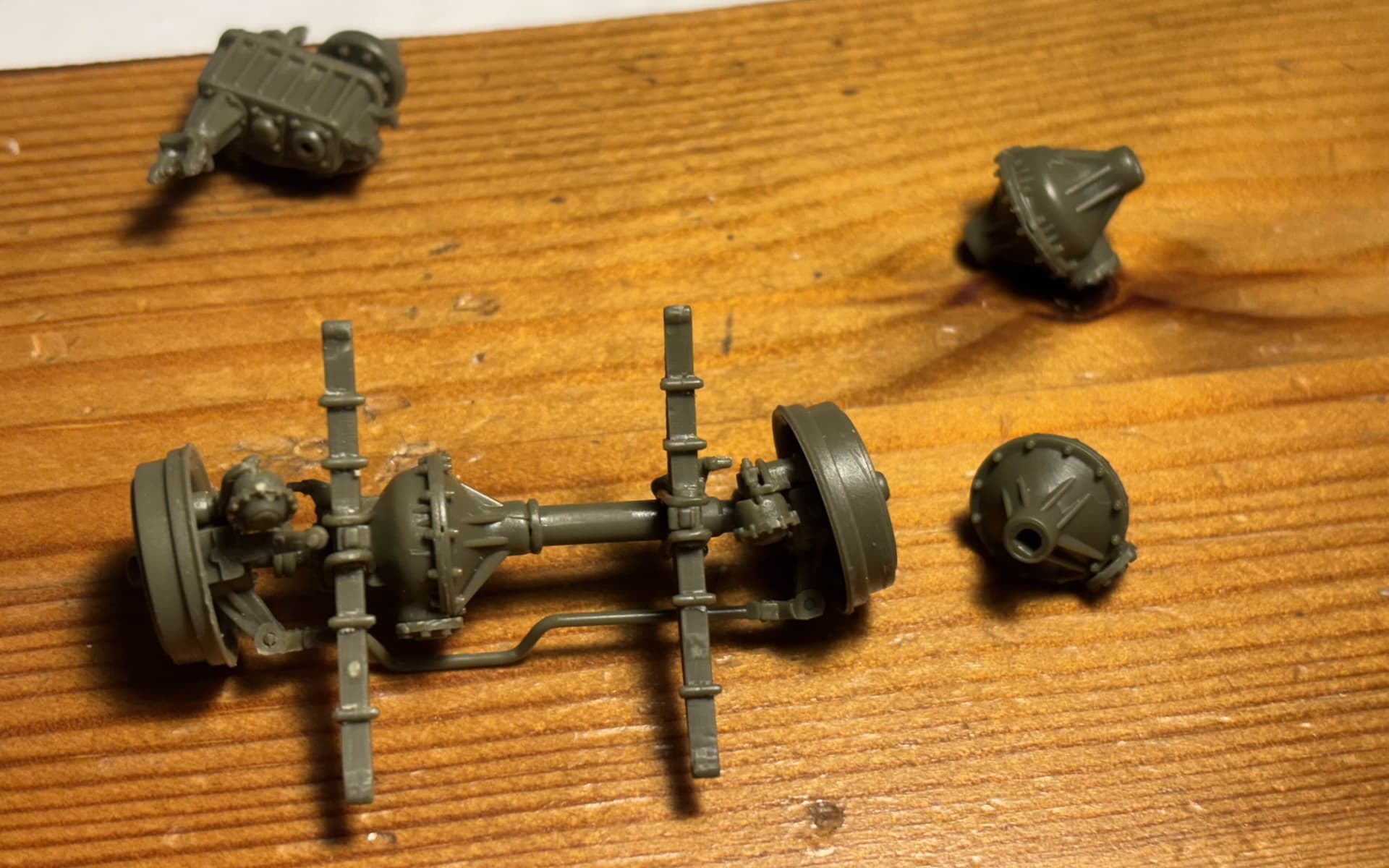

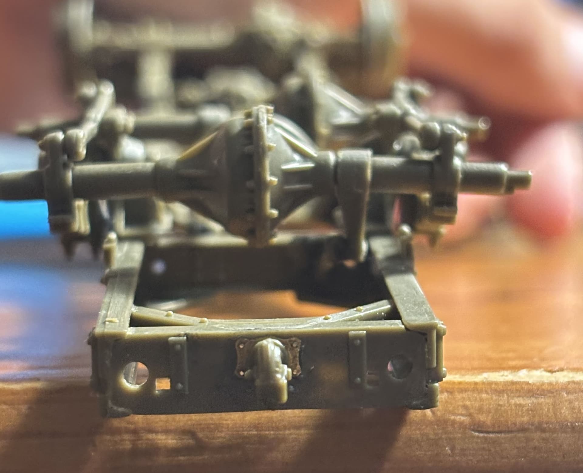

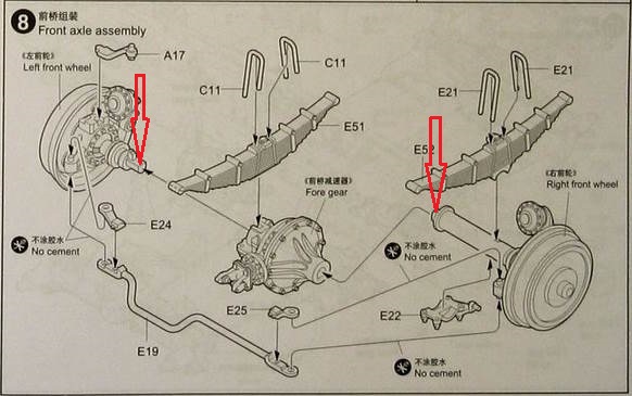

I see you built the front axle of the ZIL and it might come a bit late as advice, but I recommend you to CA a wire insert where hubs meet axle body.On all 6 hubs.
Trumpeter’s mounting point between hub and axle is too small, glue aplication makes it fragile and it usually fails one day.
I learned it the hard way while building this- otherwise superb even for todays standards- kit.

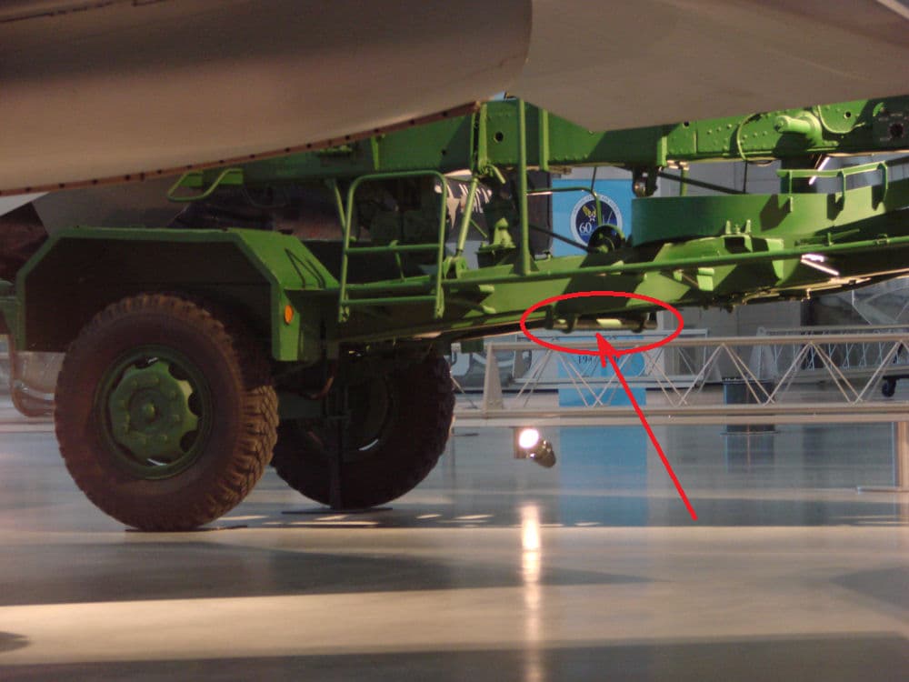

  • The trailer under the SA-2 is missing a large part of the brake system

Thank you so much for the feedback! I really appreciate your tips! But I’m kind of confused on the axle hub connection issue, could you specify more?

Sure!
Here they are (shown at the tip of the arrow) the small inserts that fail after time:
There are similar issues in Hobby Boss ZIS-151 and BM-13 kits, these seem to be produced with Trumpeters ZIL-157 molds.
Hope this helps and sorry for failing to clarify the issue initialy.

As for the trailer, I made a quick search and it looks like when I was building mine there were better references on the 'net…
Here’s one references page:
And it points to a walk around for a NASM exhibition. I marked the part that needs refinemeent here:
You see, this axle engages the brakes for the trailer, but the kit misses the parts that would “power” that axle itself. If I remember right there is an air cylinder to do it and also that handwheel nearby does it manually. If I find my references on that, I’ll post them here.

Thank you so much! This really clears it up for me, and although it’s a bit late to do something about this now I’ll be sure to implement some fix for the rear axle. Also no worries for issues with clarifying, it’s a pretty tricky thing to explain!

Also, thanks a ton for the reference link and pointing out the details in that missing area, I hope you’ll be able to find more about them!

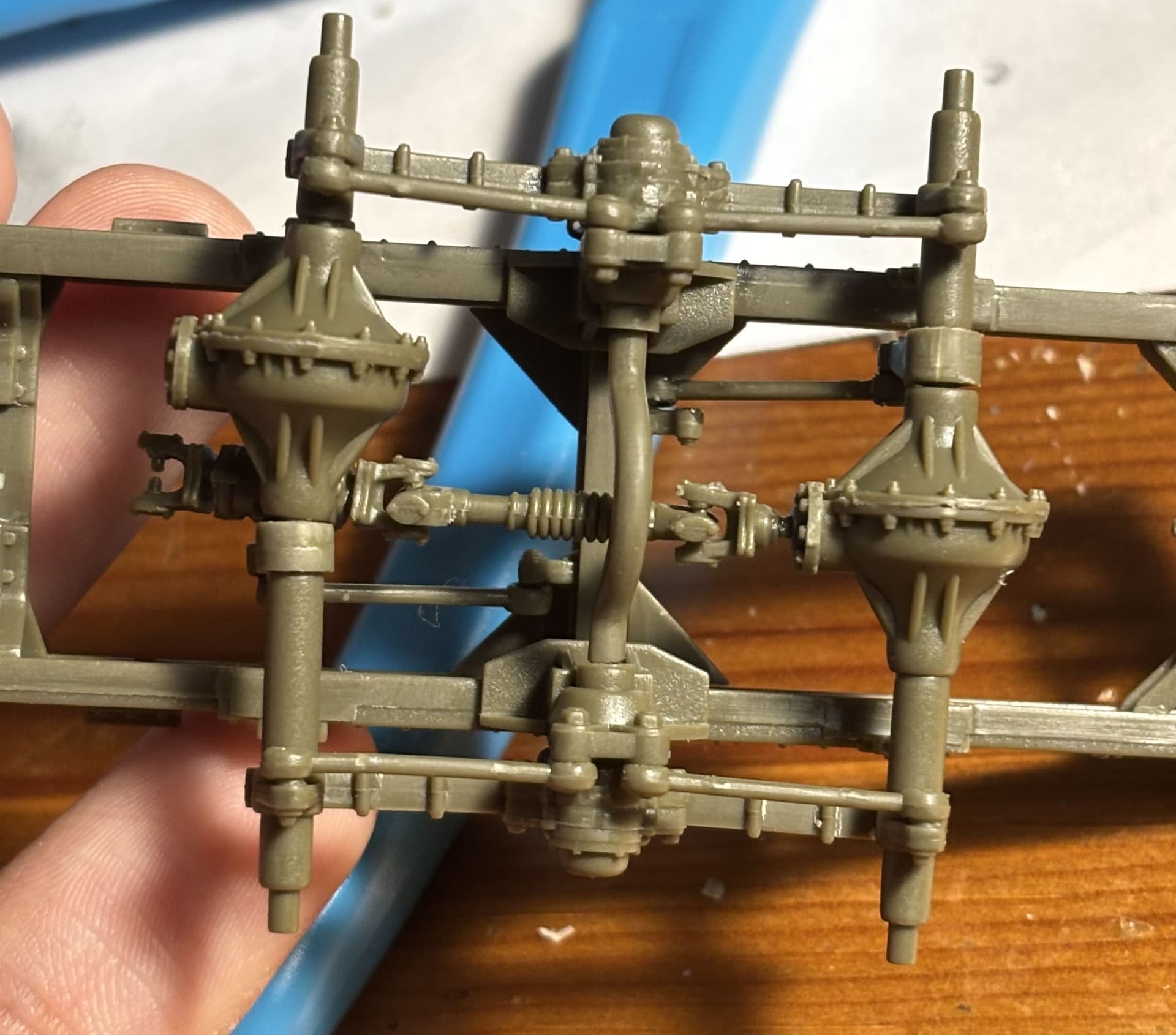

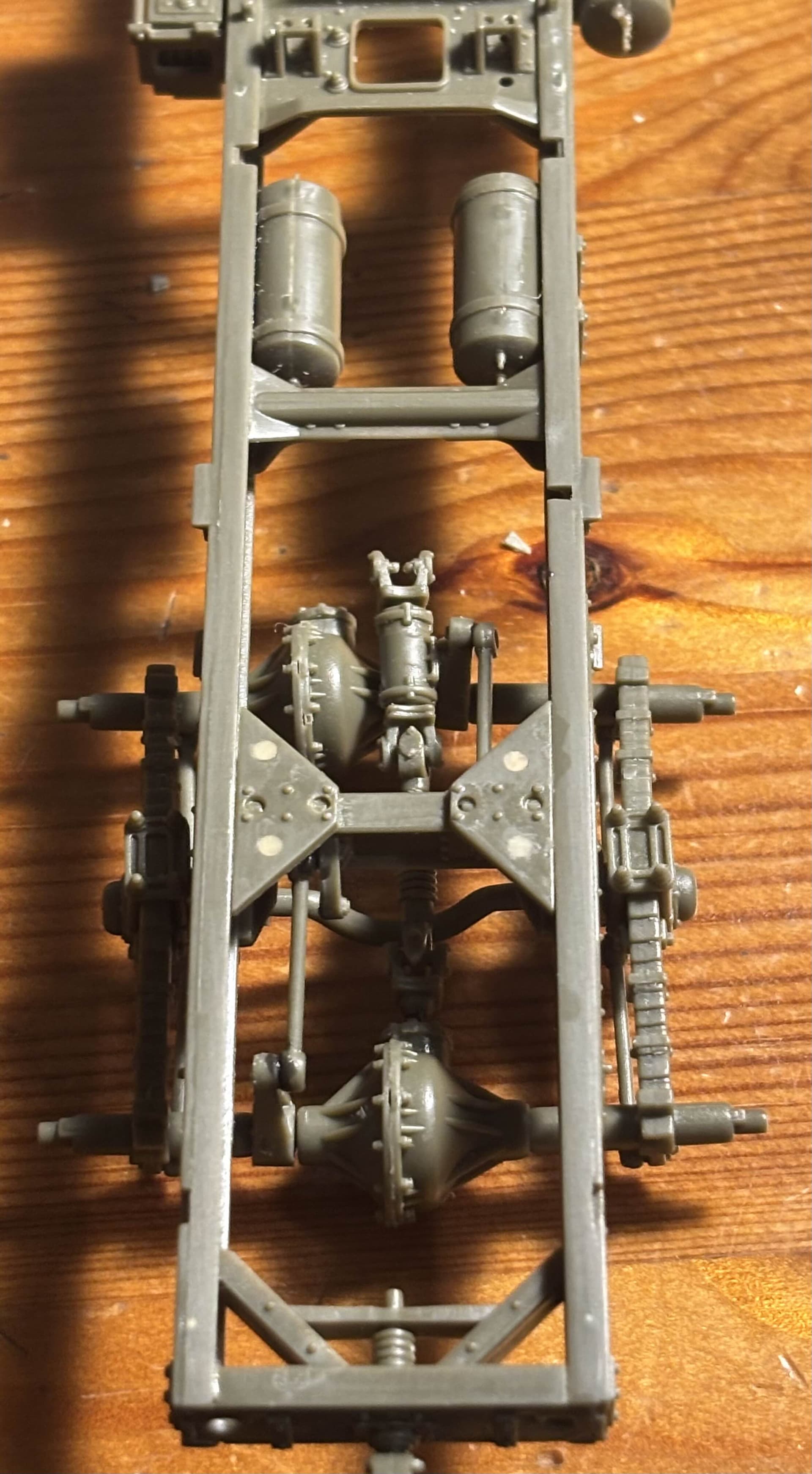

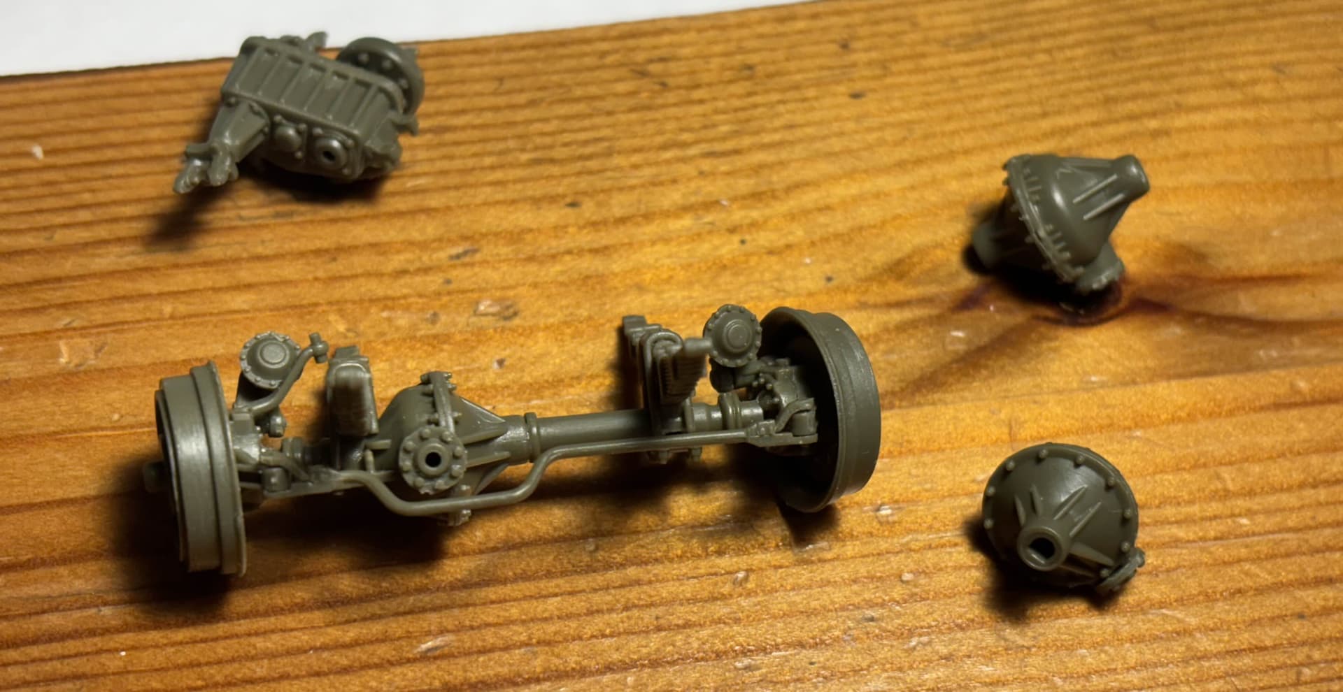

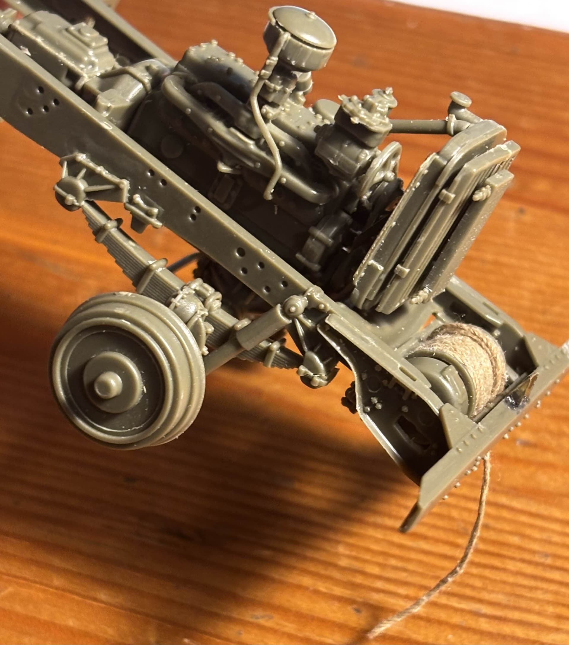

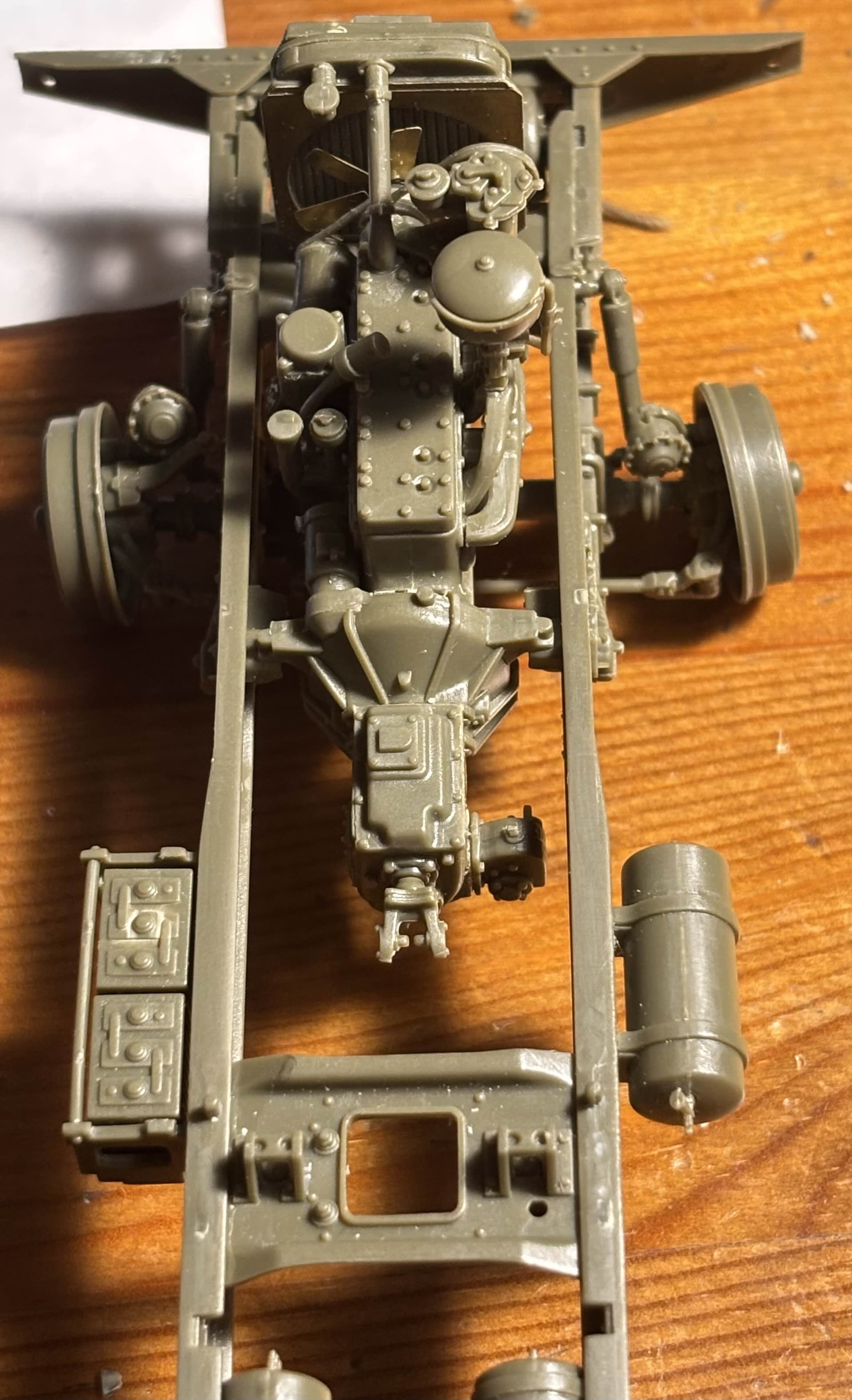

Update for the day!
I’ve been working on the kit for majority of the day and I’ve attached both the front and rear axles to the chassis.
The front axle both assembled and fit pretty well, however the back axles proved to be difficult :cry:
Yikes… :fearful:
I didn’t really make sure the rear axle beams and suspension parts were aligned, and I had to kind of push one side of the whole axle to make it fit into the chassis’s locating slots and it caused it to bend. But this isn’t exactly that major of an issue for me, the Zil’s supposed be destroyed anyways :sweat_smile:
